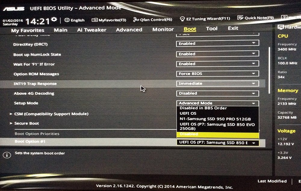

Smallersen Posted January 2, 2016 Share Posted January 2, 2016 Of course. UEFI OS is the EFI partition of the 950 Pro N1-Samsung SSD 950 is the legacy entry UEFI OS (P7 Samsung 850... is my momentary system SSD Link to comment https://www.insanelymac.com/forum/topic/309877-nvme-driver-for-all-macs-hacks-from-jimj740-available-at-macvidcards/page/2/#findComment-2202497 Share on other sites More sharing options...
magnifico Posted January 2, 2016 Share Posted January 2, 2016 Try uefi OS 950 pro. .. Link to comment https://www.insanelymac.com/forum/topic/309877-nvme-driver-for-all-macs-hacks-from-jimj740-available-at-macvidcards/page/2/#findComment-2202500 Share on other sites More sharing options...
Smallersen Posted January 2, 2016 Share Posted January 2, 2016 There is no entry "uefi OS 950 pro", just "UEFI OS" or "N1-Samsung SSD 950". I tried both without success, also with the normal SSD 850 EVO disconnected. Link to comment https://www.insanelymac.com/forum/topic/309877-nvme-driver-for-all-macs-hacks-from-jimj740-available-at-macvidcards/page/2/#findComment-2202501 Share on other sites More sharing options...
magnifico Posted January 2, 2016 Share Posted January 2, 2016 I mean uefi os Link to comment https://www.insanelymac.com/forum/topic/309877-nvme-driver-for-all-macs-hacks-from-jimj740-available-at-macvidcards/page/2/#findComment-2202502 Share on other sites More sharing options...
Smallersen Posted January 2, 2016 Share Posted January 2, 2016 This was my main setting while trying of course, but it doesn´t work. I have the following "drivers64UEFI" in clover folder: DataHubDxe-64.efiEmuVariableUefi-64.efiFSInject-64.efiNvmExpressDxe-64.efiOsxAptioFixDrv-64.efiOsxFatBinaryDrv-64.efiHFSPlus.efi I use as boot flags only: -v npci=0x3000 kext-dev-mode=1 Is there something missing or too much? Link to comment https://www.insanelymac.com/forum/topic/309877-nvme-driver-for-all-macs-hacks-from-jimj740-available-at-macvidcards/page/2/#findComment-2202505 Share on other sites More sharing options...
magnifico Posted January 2, 2016 Share Posted January 2, 2016 Wich gpu have You? Link to comment https://www.insanelymac.com/forum/topic/309877-nvme-driver-for-all-macs-hacks-from-jimj740-available-at-macvidcards/page/2/#findComment-2202506 Share on other sites More sharing options...
Smallersen Posted January 2, 2016 Share Posted January 2, 2016 Nvidia GTX 660 Ti which work out of the box with Apple driver. Same as GTX 680. As I said, the same settings work seamlessly absolut perfect with my normal SSD. There must be a NVMe specific problem like volumes not recognized, volumes not mounted etc. Link to comment https://www.insanelymac.com/forum/topic/309877-nvme-driver-for-all-macs-hacks-from-jimj740-available-at-macvidcards/page/2/#findComment-2202509 Share on other sites More sharing options...
magnifico Posted January 2, 2016 Share Posted January 2, 2016 So this Samsung 950 pro nvme is not bootable mhmm Link to comment https://www.insanelymac.com/forum/topic/309877-nvme-driver-for-all-macs-hacks-from-jimj740-available-at-macvidcards/page/2/#findComment-2202510 Share on other sites More sharing options...
Smallersen Posted January 2, 2016 Share Posted January 2, 2016 Thanks anyway. Link to comment https://www.insanelymac.com/forum/topic/309877-nvme-driver-for-all-macs-hacks-from-jimj740-available-at-macvidcards/page/2/#findComment-2202513 Share on other sites More sharing options...
