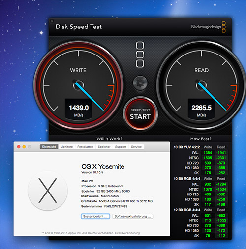

I tried it with success:
Installed a Samsung 950 Pro 512 on my Asus X99 Deluxe with 5960x processor using the onboard slot, running Yosemite (!). Absolutely no configuration in bios necessary, just partition with hd utility.
Hassle free till now, super speed with the driver NVMeGeneric.kext. The driver is working perfectly with Yosemite - and this board at least.

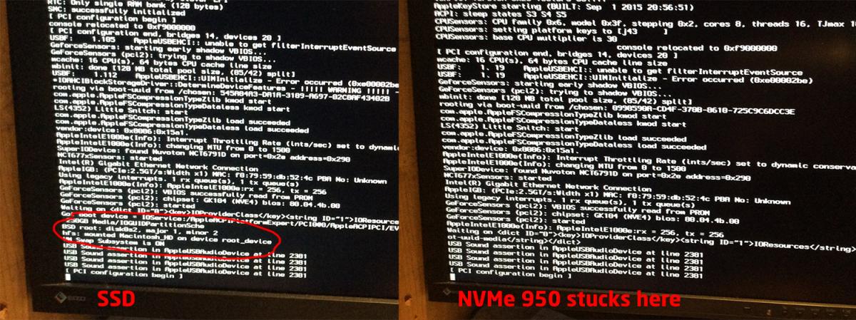

I dont want it as boot volume, so I didnt try this. As there is a normal EFI partition on the disk, it should work.
Update: Tried to boot, no luck, stuck at "PCI configuration begin". But perfect as work volume - and for aplications and cache.
sorry ... but you have not tried to do a clean install on this nvme? It seems strange to me .... and I'll explain why: I do not see the disk from the BIOS ... and yet ... I BIOS has support for nvme.
So You have cloned osx on It? And You have set To bios. .The first boot?

I have a Asus x99 Deluxe with 5960x and 950 Pro NVMe. After a lot of  trying I managed to boot from 950 Pro, but only twice. Would you mind to post your Clover config here, which EFI drivers you are using, which kexts and so on. Would be very helpful.
It seems while booting from NVMe 950 my system does not see the BSD subsystem, so stucks at "Configuration begin". Dont know how to solve this. No problem when booting from a normal SSD with same settings.
Hi onmybikedrunk
Did you try to reboot several times?
Have you set in BIOS ( first boot) 950 pro ?
Yes, of course.
I also tried to boot with just the 950 Pro connected, or loading EFI from normal SSD and switch in Clover boot screen to 950 Pro, without success.
But this is strange: The 950 Pro has only a entry "UEFI OS"without addition in BIOS, while the normal SSD is named "UEFI OS (P7: Samsung 850 ..."
Yes, of course.
Have you installed on it clover boot?
Yes, of course.
Yes, Clover folder is on EFI partition of 950 Pro.
There is a entry in Bios accordingly to the P... named entrys "N1: Samsung 950 Pro..." which is not usable as UEFI boot at all (of course). The "UEFI OS" entry does not have the addition "UEFI OS (N1:Samsung 950...) .
I start to think it is not a BIOS problem but a Clover/Kext problem not recognizing the BSD root system. See attached file where the file system entrys are missing.
Missing:
BSD root:...
hfs:...
VM Swap Subsystem is ON
Missing:
BSD root:...
hfs:...
Many strange. ..can you attached pic your BIOS about boot manager?
