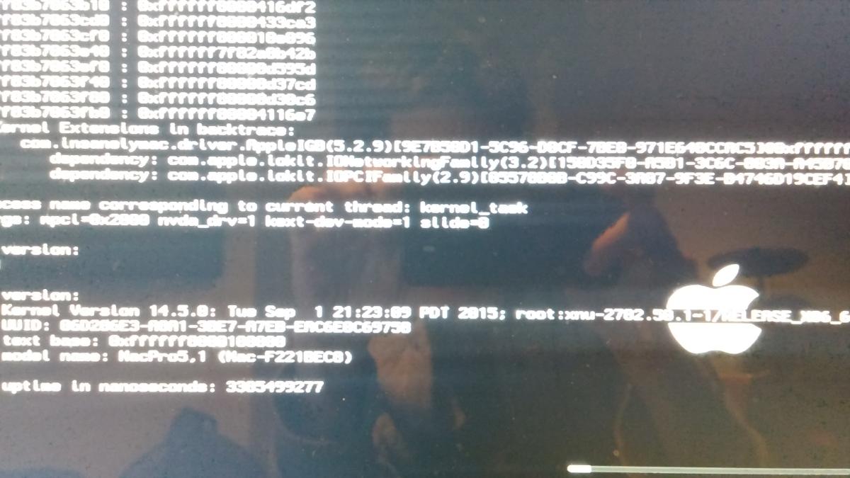

zeppelin Posted November 21, 2015 Share Posted November 21, 2015 Hi there, I installed Mac OSX 10.10.5 Yosemite with the RampageDev method using clover on an X99 system Asus X99 Deluxe with 3.1 USB card i7 5820k - 6 core, not overclocked yet 32 gig memory Zotec 980 NVIDIA Card Firewire Card Sonnet Tempo e4p 4 x eSata Card Sony Optiarc 5280 DVD RW When it boots to the login screen, it works beautifully, everything works really well. I've been getting these Kernel Panics as of late. Sometimes I'll get one, then it will boot fine. Sometimes 3-4, sometimes none. Edit: I repaired disk permissions and the issue still happens. Also.... the Ethernet internet connection sometimes works, sometimes doesn't, sometimes drops out (and then I have to turn it off, switch to Wifi. I think that these two issues may be related am I right? Once I even unplugged the ethernet cable and the whole machine rebooted itsself. Is there some kext I should remove / patch to help this issue? Has anyone else had an intermittent type problem like this, and do you know why? Thanks! Link to comment https://www.insanelymac.com/forum/topic/309500-kernel-panics-appleigb-ionetworkingfamily-iopcifamily-29/ Share on other sites More sharing options...

Dakdot Posted January 4, 2016 Share Posted January 4, 2016 Hello. The whole kernel panic is cut off a little bit, but I know for sure that it has to do with your Ethernet/WiFi card. The cause of your panics are the AppleIGB.kext, which a quick Google will tell you has to do with Ethernet/WiFi. Could you please provide us with what card you are using specifically (or if it's on the motherboard)? Thanks. Link to comment https://www.insanelymac.com/forum/topic/309500-kernel-panics-appleigb-ionetworkingfamily-iopcifamily-29/#findComment-2202951 Share on other sites More sharing options...
llamafilm Posted July 30, 2016 Share Posted July 30, 2016 Same problem here. I have a different motherboard, but I believe we both have the same NICs. I use AppleIGB for the i211, and it sometimes causes a panic at boot. Rebooting a few times usually gets me going. The easy solution is to remove AppleIGB, and use IntelMausiEthernet with the i218. But that doesn't help if you require two NICs (I do). I'm still looking for a solution to this. I also use npci=0x2000 and OsxAptioFixDrv.efi in order to boot. Link to comment https://www.insanelymac.com/forum/topic/309500-kernel-panics-appleigb-ionetworkingfamily-iopcifamily-29/#findComment-2259850 Share on other sites More sharing options...
TheRacerMaster Posted July 30, 2016 Share Posted July 30, 2016 Have you tried faking your i211 device ID to the i210's (0x1533)? The i210 has native support with AppleIntelI210Ethernet.kext. Link to comment https://www.insanelymac.com/forum/topic/309500-kernel-panics-appleigb-ionetworkingfamily-iopcifamily-29/#findComment-2259855 Share on other sites More sharing options...
llamafilm Posted August 1, 2016 Share Posted August 1, 2016 Have you tried faking your i211 device ID to the i210's (0x1533)? The i210 has native support with AppleIntelI210Ethernet.kext. I'm trying now with 0x15338086 in the LAN Fake ID. DPCI Manager shows two i210 devices in the PCI List, but it doesn't seem to work. I see no ethernet cards in both DPCI Manager Status tab, and System Profiler. Link to comment https://www.insanelymac.com/forum/topic/309500-kernel-panics-appleigb-ionetworkingfamily-iopcifamily-29/#findComment-2260950 Share on other sites More sharing options...
