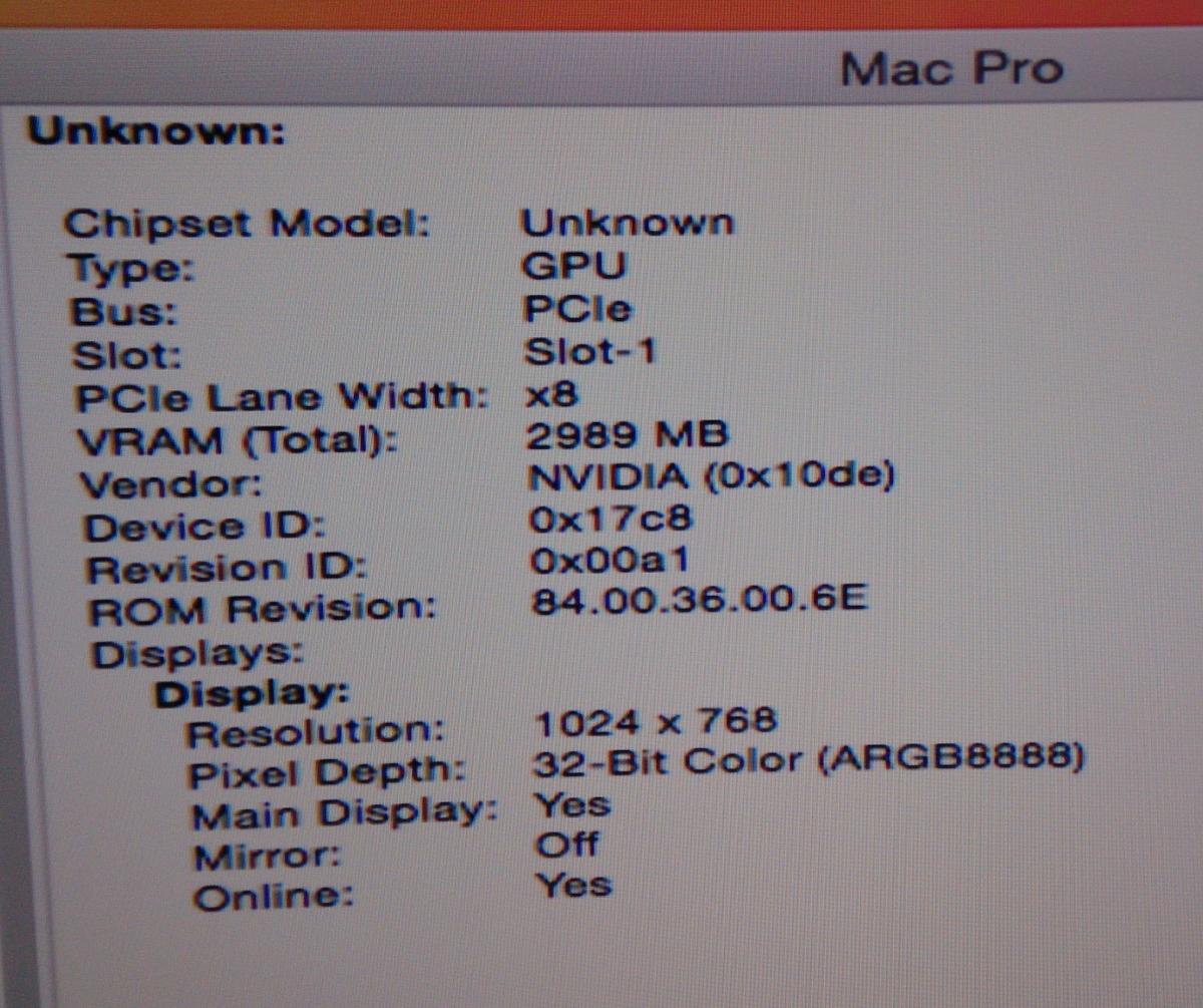

lemarqq Posted November 10, 2015 Share Posted November 10, 2015 I installed the Web driver but the only resolution i have is 1024 x 768And by the way : i have to add nv_disable=1 to or else i can't boot.I mean, i can but i have " NO SIGNAL "Is there maybe an issue with the HDMI ? I'm using a 4K TV Samsung UE40JU6550 - GTX 980 Ti with HDMI - HDMI I have the version OSX Yosemite 10.10.5Any ideas ? Can someone help me, please ?Thank you Link to comment https://www.insanelymac.com/forum/topic/309321-gtx-980-ti-driver/ Share on other sites More sharing options...

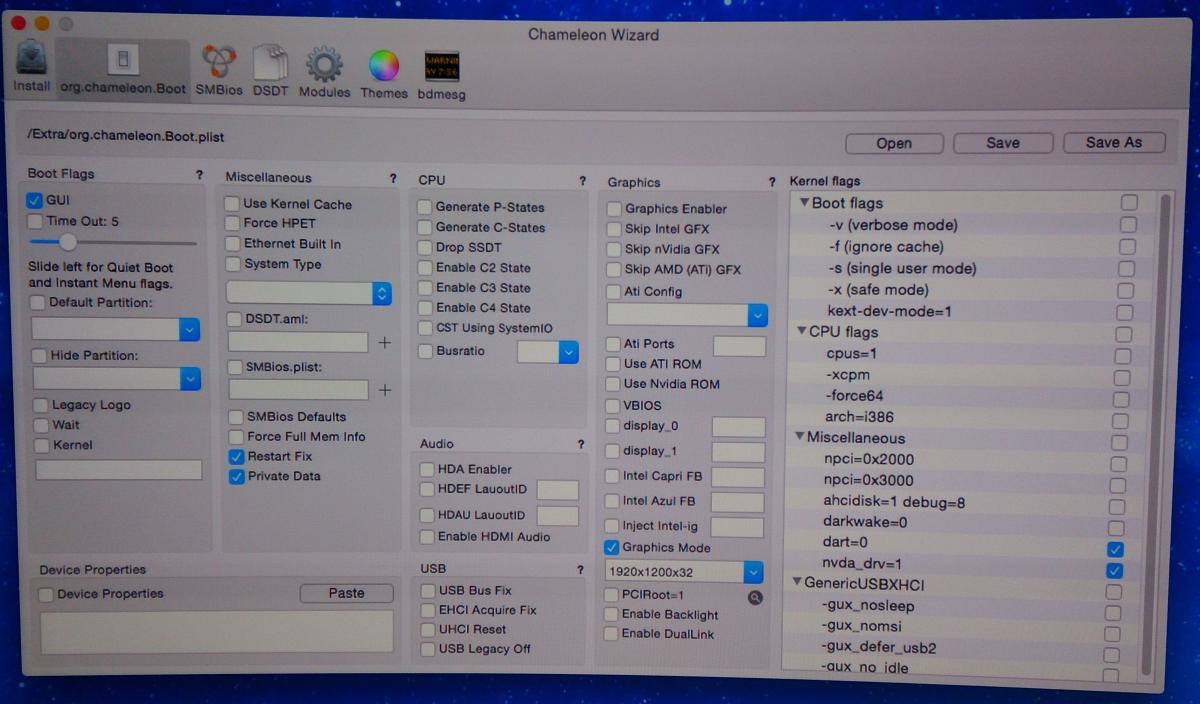

lemarqq Posted November 19, 2015 Author Share Posted November 19, 2015 I attached here 2 images What else do i need to check or uncheck ? Thank you Link to comment https://www.insanelymac.com/forum/topic/309321-gtx-980-ti-driver/#findComment-2189852 Share on other sites More sharing options...
river86 Posted November 19, 2015 Share Posted November 19, 2015 I installed the Web driver but the only resolution i have is 1024 x 768 And by the way : i have to add nv_disable=1 to or else i can't boot. I mean, i can but i have " NO SIGNAL " Is there maybe an issue with the HDMI ? I'm using a 4K TV Samsung UE40JU6550 - GTX 980 Ti with HDMI - HDMI I have the version OSX Yosemite 10.10.5 Any ideas ? Can someone help me, please ? Thank you I attached here 2 images What else do i need to check or uncheck ? Thank you I am currently using that very same card on my home build (x99), the card works pretty good. I am using nvda_drv=1 to get the webdrivers to load, try it on. i did as you said but all i can get is 1920x1080 I also tried imac 14.2 and macpro 6 or something like that My gtx 980 ti is not recognized What else should I try ? Thanks Mac Pro 6.1 got me a black screen until i installed a fix mentioned at that other hackintosh forum/site, i don't recall it right now should post once i get home I have only HDMI on my 4K Samsung tv Could that be the problem, maybe ? Should i try with DP ( graphic card ) to HDMI ( tv ) ? Does it make a difference ? You know the cable might be an issue, depending on the cable version hdmi 1.2 or 1.3 you might find issues like lower supported resolution and lower base framerate, this is true specially with cheap cables. Try a DP cable and tell us how it goes. I am using a p2715q from dell, 4k @60hz via a single DP cable. Hope that info is useful to you. Link to comment https://www.insanelymac.com/forum/topic/309321-gtx-980-ti-driver/#findComment-2189919 Share on other sites More sharing options...

durpflip Posted November 30, 2015 Share Posted November 30, 2015 if that doesn't work,you can always try setting your graphics resolution manually. so if your TV uses 4K you can type as a boot flag in the clover config ; Graphics Mode=3840x2160x32 Link to comment https://www.insanelymac.com/forum/topic/309321-gtx-980-ti-driver/#findComment-2193054 Share on other sites More sharing options...
