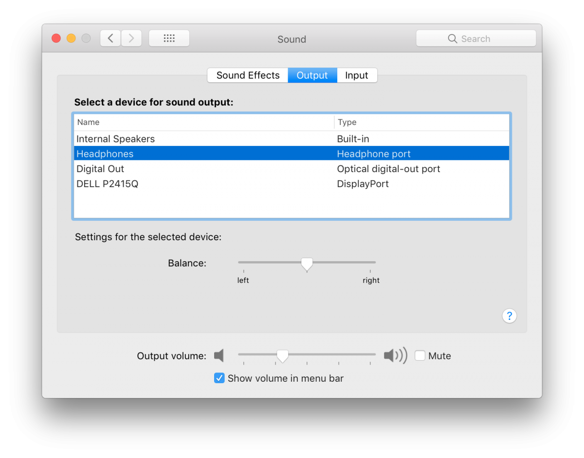

064852029 Posted February 19, 2018 Share Posted February 19, 2018 This is strange, no pin sense on the headphone jack but, on the speaker node. Try this AppleALC, use layout-id 2 AppleALC.kext.zip Try with your kext, and only 0x15 changed to 1 like layout-id 1. However there are all input sources appear in sound. When I plug in headphone to headphone jack, the speaker turn off automatically and sound change to headphone. But when I plug in headphone to headset jack, there is nothing changed. (Have not tried with line in and digital out jacks) Link to comment https://www.insanelymac.com/forum/topic/309283-creative-ca0132-g1sniper-m3-patch-for-applehda-or-voodoohda/page/24/#findComment-2594561 Share on other sites More sharing options...
wern apfel Posted February 20, 2018 Author Share Posted February 20, 2018 Try with your kext, and only 0x15 changed to 1 like layout-id 1. However there are all input sources appear in sound. When I plug in headphone to headphone jack, the speaker turn off automatically and sound change to headphone. But when I plug in headphone to headset jack, there is nothing changed. (Have not tried with line in and digital out jacks) Not sure what you mean by "only 0x15 changed to 1". Did you selected the second device called Headphones? Link to comment https://www.insanelymac.com/forum/topic/309283-creative-ca0132-g1sniper-m3-patch-for-applehda-or-voodoohda/page/24/#findComment-2595457 Share on other sites More sharing options...
064852029 Posted February 21, 2018 Share Posted February 21, 2018 Not sure what you mean by "only 0x15 changed to 1". Did you selected the second device called Headphones? I mean 0x15 in pinsense output. Selected headphones but there is no output Link to comment https://www.insanelymac.com/forum/topic/309283-creative-ca0132-g1sniper-m3-patch-for-applehda-or-voodoohda/page/24/#findComment-2595691 Share on other sites More sharing options...

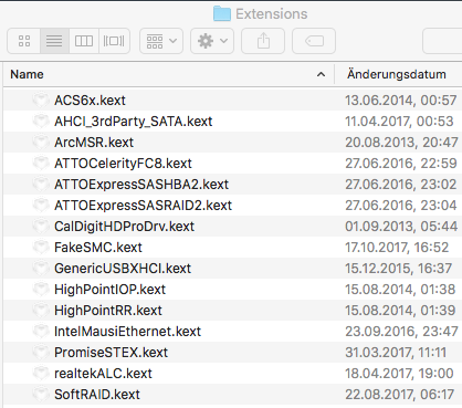

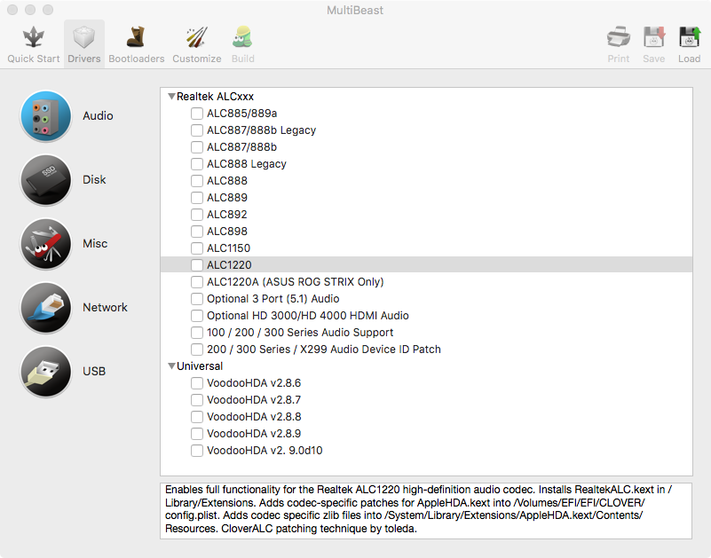

wern apfel Posted March 17, 2018 Author Share Posted March 17, 2018 Ok, so you want to use AppleALC. Download the latest release where Lilu.kext is mandatory, copy both files to the clover/kexts/Other folder. Also delete the /Library/Extensions/realtekALC.kext and copy CodecCommanderkext to this folder and repair permissions. Then you can try layout-id 4,5,6 with layout-id 4 you can use this little App to switch to headphones or speakers. If you have not already done so, pack the ioreg file as a zip file. I think only images and zip files can be uploaded. There are 25 posts per page, 445 should not be on page 17 + 20 posts? 1 Link to comment https://www.insanelymac.com/forum/topic/309283-creative-ca0132-g1sniper-m3-patch-for-applehda-or-voodoohda/page/24/#findComment-2603634 Share on other sites More sharing options...
