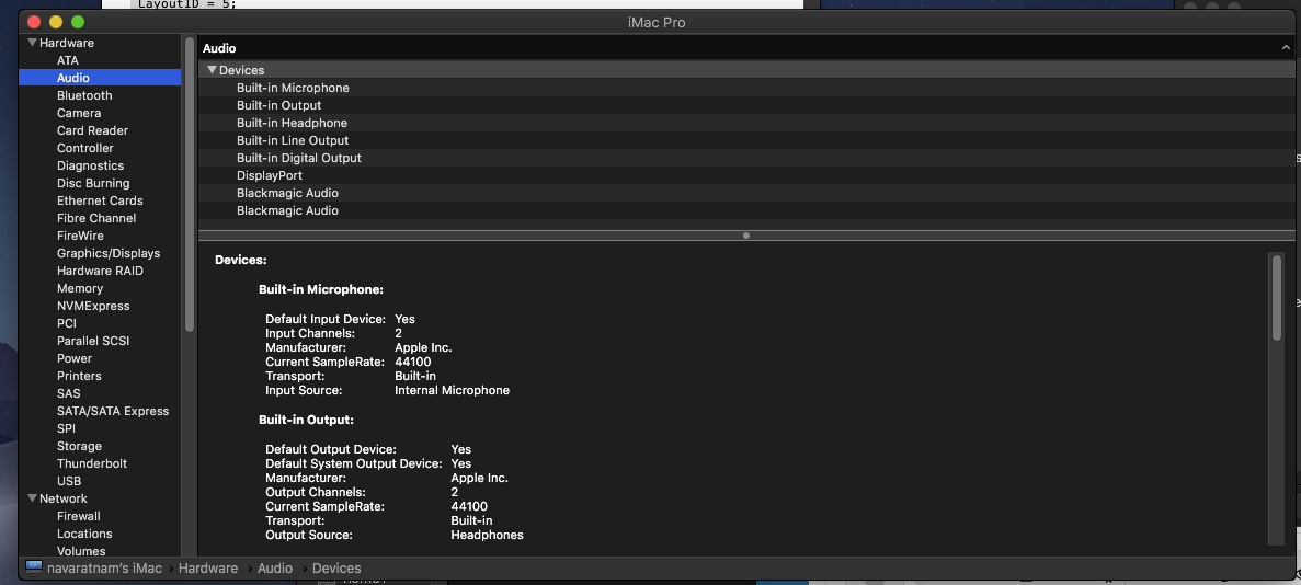

Luminadevapps Posted June 10, 2018 Share Posted June 10, 2018 Thanks @wern apfel 10.14 Beta 18A293u LayoutID = 5 AppleHDA.kext.zip Link to comment https://www.insanelymac.com/forum/topic/309283-creative-ca0132-g1sniper-m3-patch-for-applehda-or-voodoohda/page/25/#findComment-2618218 Share on other sites More sharing options...
wern apfel Posted June 11, 2018 Author Share Posted June 11, 2018 On 6/10/2018 at 11:29 AM, MikeSantos said: Great thanks I forgot to mention that you need to use the boot argument -alcbeta and -lilubeta or -lilubetall for all Lilu plugins. On 6/10/2018 at 3:42 PM, nmano said: Thanks @wern apfel 10.14 Beta 18A293u LayoutID = 5 AppleHDA.kext.zip AppleALC works as before with layout-id 5, use the boot arguments 1 Link to comment https://www.insanelymac.com/forum/topic/309283-creative-ca0132-g1sniper-m3-patch-for-applehda-or-voodoohda/page/25/#findComment-2618530 Share on other sites More sharing options...

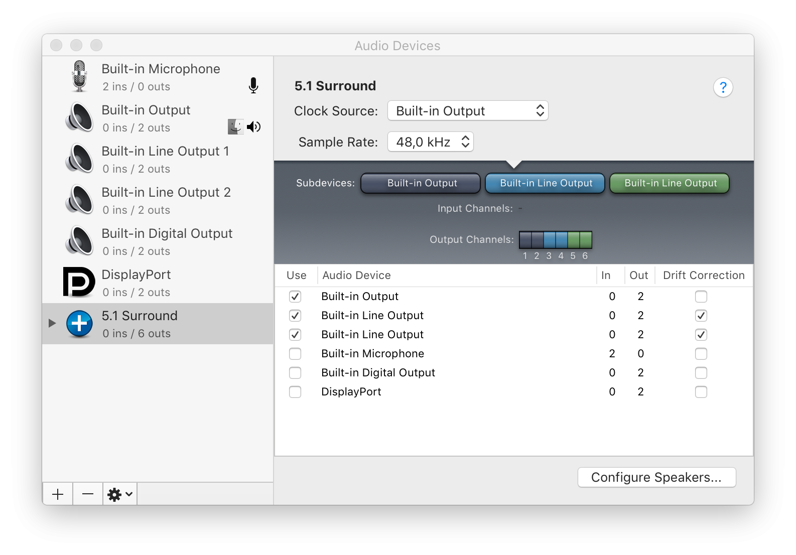

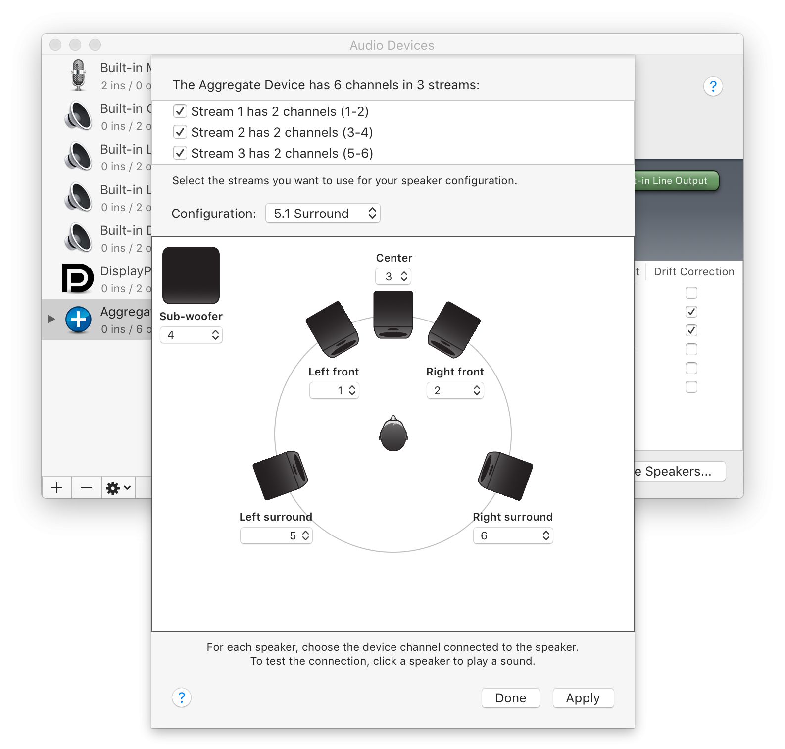

wern apfel Posted June 22, 2018 Author Share Posted June 22, 2018 On 6/20/2018 at 2:13 PM, MikeSantos said: Ok, yes its truth......thanks. Just one dude: AppleAlc.kext is prepared to ca0132, why it is necessary to use a special Codeccomander.kext to make it works? Thanks CodecCommander is needed for multichannel and the front headphone jack. If you use only line-out and the rear headphone jack, try layout-id 1 it should work without CodecCommander. Link to comment https://www.insanelymac.com/forum/topic/309283-creative-ca0132-g1sniper-m3-patch-for-applehda-or-voodoohda/page/25/#findComment-2621741 Share on other sites More sharing options...

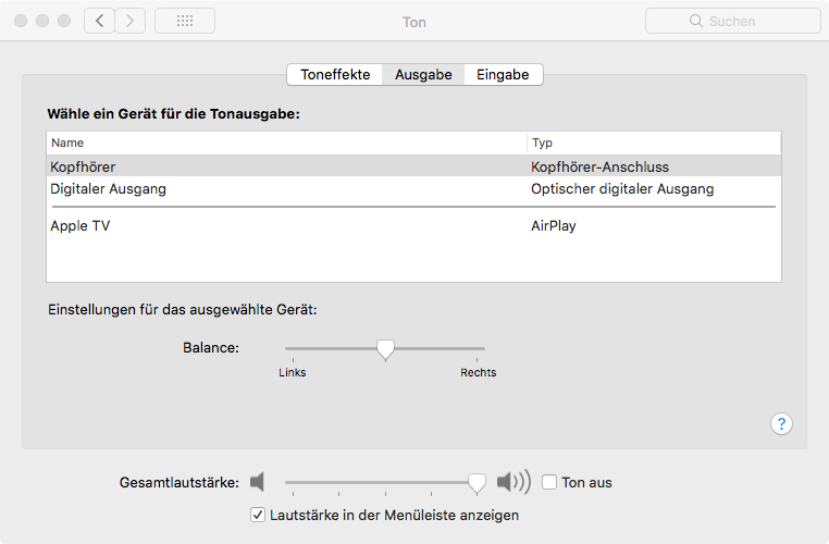

madicineman Posted August 24, 2018 Share Posted August 24, 2018 (edited) On 3/17/2018 at 10:03 AM, wern apfel said: Ok, so you want to use AppleALC. Download the latest release where Lilu.kext is mandatory, copy both files to the clover/kexts/Other folder. Also delete the /Library/Extensions/realtekALC.kext and copy CodecCommanderkext to this folder and repair permissions. Then you can try layout-id 4,5,6 with layout-id 4 you can use this little App to switch to headphones or speakers. If you have not already done so, pack the ioreg file as a zip file. I think only images and zip files can be uploaded. There are 25 posts per page, 445 should not be on page 17 + 20 posts? Dear Wern Apfel, it took some time, but I am back. I was a little reluctant to use a foreign dsdt, but finally decided to try yours. Before I did so, I tried to rescue the only important data (a Photo mediathek) from this hack. But the time to copy that file to an external drive was always to short until the random freeze kicked in. Just by pure luck I found out, that, if I reseted my bios settings, I could prolong the time until the freeze occured. So I was able to rescue that file. Copying it, a message popped up, that my system was due for a minor update to 10.13.6. Well, there was nothing to loose and I did so. What shall I say? Full success (ATI Radeon RX 580 ooB, Messages runs like a charm etc.)! No freezes anymore! So I downloaded the new postinstallation tool (which must not be named) for 10.13.6. With that tool I installed Apple ALC. Manually I did all the steps in your quoted post. But I was not able to find out, how to "try out layout-id 4,5,6" and your little App did not start. So I checked, where the tool which must not be named is saving the AppleALC and Lilu.kext. Well, it is not Clover! Actually the EFIMounter was not able to find any EFI at my drives (one SATA M2 with Mac OS and one SATA with SuseLinux). Apple ALC and Lilu.kext I can find in /Library/Extensions/. I was able to find a folder "EFI-Backups" with 3 sub-folders "r46XX" with "EFI/kexts/other"-subsubsubsub-folders inside. Any of these "other"-folders had only a fake-SMC-file inside... Does that mean anything to you? Is it possible to adjust your tool to the different location? Can you help, please? The ioreg should be in the attachement... Thanks in advance! - Gichin My build: GA-Z170X Gaming 7, i7-6700, Ballistix Sport RAM 32GB, Sapphire Pulse RX 580, Broadcom-WiFi, Phanteks Eclipse P400S ioreg_20180823.zip Edited August 25, 2018 by madicineman Link to comment https://www.insanelymac.com/forum/topic/309283-creative-ca0132-g1sniper-m3-patch-for-applehda-or-voodoohda/page/25/#findComment-2631520 Share on other sites More sharing options...
wern apfel Posted August 26, 2018 Author Share Posted August 26, 2018 On 8/24/2018 at 11:14 AM, madicineman said: Dear Wern Apfel, it took some time, but I am back. I was a little reluctant to use a foreign dsdt, but finally decided to try yours. Before I did so, I tried to rescue the only important data (a Photo mediathek) from this hack. But the time to copy that file to an external drive was always to short until the random freeze kicked in. Just by pure luck I found out, that, if I reseted my bios settings, I could prolong the time until the freeze occured. So I was able to rescue that file. Copying it, a message popped up, that my system was due for a minor update to 10.13.6. Well, there was nothing to loose and I did so. What shall I say? Full success (ATI Radeon RX 580 ooB, Messages runs like a charm etc.)! No freezes anymore! So I downloaded the new postinstallation tool (which must not be named) for 10.13.6. With that tool I installed Apple ALC. Manually I did all the steps in your quoted post. But I was not able to find out, how to "try out layout-id 4,5,6" and your little App did not start. So I checked, where the tool which must not be named is saving the AppleALC and Lilu.kext. Well, it is not Clover! Actually the EFIMounter was not able to find any EFI at my drives (one SATA M2 with Mac OS and one SATA with SuseLinux). Apple ALC and Lilu.kext I can find in /Library/Extensions/. I was able to find a folder "EFI-Backups" with 3 sub-folders "r46XX" with "EFI/kexts/other"-subsubsubsub-folders inside. Any of these "other"-folders had only a fake-SMC-file inside... Does that mean anything to you? Is it possible to adjust your tool to the different location? Can you help, please? The ioreg should be in the attachement... Thanks in advance! - Gichin My build: GA-Z170X Gaming 7, i7-6700, Ballistix Sport RAM 32GB, Sapphire Pulse RX 580, Broadcom-WiFi, Phanteks Eclipse P400S ioreg_20180823.zip AppleALC works, you should see some devices in the system preferences, but CodecCommander is missing. Install CodecCommander to /L/E repair permissions and rebuild the cache, then it should work, the switcher too. If you want to try the DSDT, rename it and add it into the Clover/ACPI/patched folder and choose it from the clover menu, if it works as it should, replace the old one. Since 10.13.6 the EFI mounter tools need admin privileges, so use an updated version. Link to comment https://www.insanelymac.com/forum/topic/309283-creative-ca0132-g1sniper-m3-patch-for-applehda-or-voodoohda/page/25/#findComment-2631748 Share on other sites More sharing options...
madicineman Posted August 27, 2018 Share Posted August 27, 2018 (edited) On 8/26/2018 at 1:21 PM, wern apfel said: AppleALC works, you should see some devices in the system preferences, but CodecCommander is missing. Install CodecCommander to /L/E repair permissions and rebuild the cache, then it should work, the switcher too. If you want to try the DSDT, rename it and add it into the Clover/ACPI/patched folder and choose it from the clover menu, if it works as it should, replace the old one. Since 10.13.6 the EFI mounter tools need admin privileges, so use an updated version. Dear Wern Apfel, thank you very much for your quick answer. And I am one step further. Here is what I did: 1) I checked for the Codec Commander. And it was already installed in /L/E with permissions "wide open" (see picture). Can I do something beyond that? 2) I learnt, how to rebuild a cache (I hope) and cleaned it with "DiskCleaner". 3) I tried to open CA0132Switcher but nothing happened neither with direct click nor with right mouse click and "Open" in the menu... I am kind of clueless, what is my failure here? 4) Then I was switching between the two headphone-connectors with now success. In a moment of silence due to my frustration I could hear something very faintly. So tuned up the system volume and the hardware-volume of my connected old Cambridge Soundworks DTT 2200 analog 5.1-Soundsystem to the maximum. 5) I could hear music and, no, it was not in my head... But I can barely hear it. The music is only at front speakers (left and right, but not at center) and the Subwoofer. Nothing at the rear speakers. But the music is kind of distorted (especially voices) and very faint. The headphones are still not working in neither position. No HDMI audio. Yes, System Preferences shows me headphones, digital audio output and my Apple TV in the next room (see picture 2). Do you have any suggestions? Can we speak directly? Telephone? I appreciate your help very much. Thank you again! Gichin Edited August 27, 2018 by madicineman Link to comment https://www.insanelymac.com/forum/topic/309283-creative-ca0132-g1sniper-m3-patch-for-applehda-or-voodoohda/page/25/#findComment-2631911 Share on other sites More sharing options...
madicineman Posted August 27, 2018 Share Posted August 27, 2018 (edited) On 8/26/2018 at 1:21 PM, wern apfel said: AppleALC works, you should see some devices in the system preferences, but CodecCommander is missing. Install CodecCommander to /L/E repair permissions and rebuild the cache, then it should work, the switcher too. If you want to try the DSDT, rename it and add it into the Clover/ACPI/patched folder and choose it from the clover menu, if it works as it should, replace the old one. Since 10.13.6 the EFI mounter tools need admin privileges, so use an updated version. Wow, I got the CA0132Switcher running. Sorry, I did not recognized that it was a package... Here is the output: Edited August 27, 2018 by madicineman Link to comment https://www.insanelymac.com/forum/topic/309283-creative-ca0132-g1sniper-m3-patch-for-applehda-or-voodoohda/page/25/#findComment-2631912 Share on other sites More sharing options...

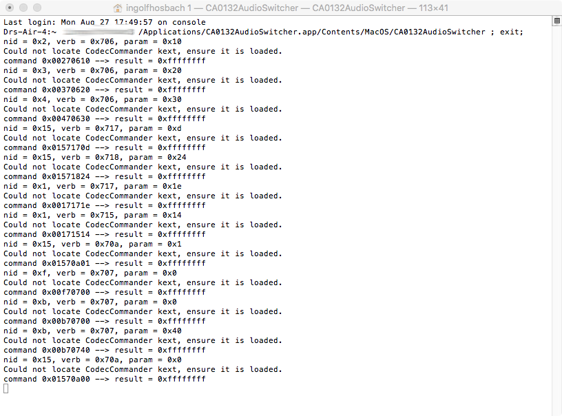

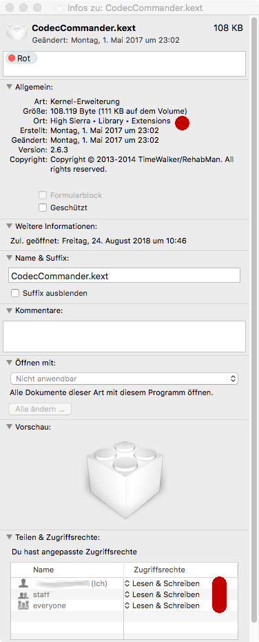

madicineman Posted August 27, 2018 Share Posted August 27, 2018 1 hour ago, madicineman said: Wow, I got the CA0132Switcher running. Sorry, I did not recognized that it was a package... Here is the output: So, I got the CodecCommander in the right place with all the permissions he should get, but the Switch can´t locate him... What shall I do? Thanks in advance for any suggestions... - Gichin Link to comment https://www.insanelymac.com/forum/topic/309283-creative-ca0132-g1sniper-m3-patch-for-applehda-or-voodoohda/page/25/#findComment-2631922 Share on other sites More sharing options...

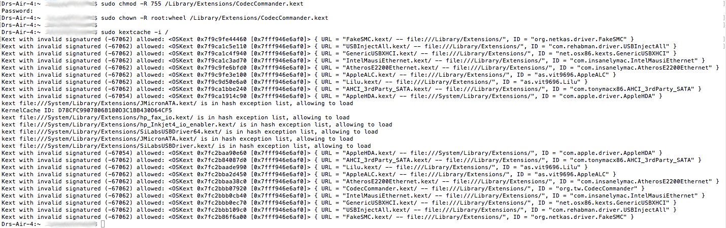

wern apfel Posted August 28, 2018 Author Share Posted August 28, 2018 Enter the following commands to the terminal window to repair the permissions. sudo chmod -R 755 /Library/Extensions/CodecCommander.kext && sudo chown -R root:wheel /Library/Extensions/CodecCommander.kext and then sudo kextcache -i / You should see something like: not signed but allowed. When you start the switcher, you will see a speaker icon in the menu bar where you can change from speakers to headphones. All Apple apps are folders with this type of content. 1 Link to comment https://www.insanelymac.com/forum/topic/309283-creative-ca0132-g1sniper-m3-patch-for-applehda-or-voodoohda/page/25/#findComment-2632034 Share on other sites More sharing options...
madicineman Posted August 29, 2018 Share Posted August 29, 2018 (edited) On 8/28/2018 at 5:15 PM, wern apfel said: Enter the following commands to the terminal window to repair the permissions. sudo chmod -R 755 /Library/Extensions/CodecCommander.kext && sudo chown -R root:wheel /Library/Extensions/CodecCommander.kext and then sudo kextcache -i / You should see something like: not signed but allowed. When you start the switcher, you will see a speaker icon in the menu bar where you can change from speakers to headphones. All Apple apps are folders with this type of content. Dear Wern Apfel, thank you again for the new answer. I did what you said: The result is in the screenshot as attachment. This time the Switcher worked to the point, where I could switch between "Headphones", "Loudspeakers" and "Fake Surround". But whatever I clicked, I only got blurred and faint music from 2 of the 5 loudspeakers. No sound via headphones neither front nor back. The menu showed two further items: "Microphone front" and "Microphone back". But a click did not make a selection of one of the two despite a connected microphone. So for the meantime I had a new intermediate possibility: I got my new LG monitor yesterday with Bluetooth and a quite good sound. See the picture... But nevertheless I am eager to get that internal sound working. So appreciate more of your input... Thank you so much! Gichin Update: After a reboot it changed a lot: Now I got clear sound from 2 of 5 speakers (+"ump!" from the subwoofer) but with some background noise like jingle bells. I have the speakers with the Switcher switched to "headphones". All other options are switching off the sound of the speakers, but no sound from the headphones in the front-plug in. The option "loudspeakers" switches to the headphones in the back (but very faint sound) Edited August 29, 2018 by madicineman Link to comment https://www.insanelymac.com/forum/topic/309283-creative-ca0132-g1sniper-m3-patch-for-applehda-or-voodoohda/page/25/#findComment-2632219 Share on other sites More sharing options...
