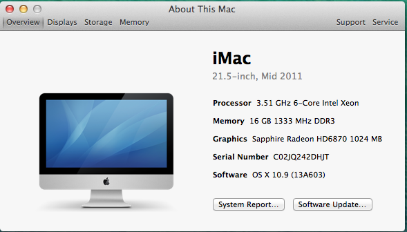

spakk Posted October 7, 2015 Share Posted October 7, 2015 Hi, I've been a hackintosh user for a while now and I've managed to successfuly build several builds (incl. from 10.5 till Yosemite). I've bought a LG Ultrawide monitor (25UM57-P) and since then I've been struglin' to enable the full resolution. I've already read everything that google brings up, but didn't found anything to fix that. I am runnin with full QE/CI and VGA works OOB but the pixels look terrible and all I see is blurry text. The monitor is shown as a Television on my hackintosh (even on MBP 2009, MBP 2010, MBP 2014). The "Force to RGB Mode" fix didn't help If somebody is familiar with the problem, please respond as I get very desperated here.. Thanks in advance! All the best My specs: MB: ASUS m5a99x Evo r2.0 CPU: AMD FX 6300 3.5 ghz RAM: 16 gb Corsair Vengeance Pro 1600 VGA: Sapphire 6870 1 GB GDDR5 According to the information in "About this Mac" is written: 10.9 Build 13A603. But you write that you have installed Yosemite. Do you have the same problems with the graphics under Yosemite? Have you anything changed under S / L / Extension? Do you use a DSDT? Which kernel are you using? It is not easy without mire details to make a possible statement. Incidentally, the same graphics card can lead to different results under Intel or AMD hackintosh. Maybe you are missing other drivers? just a guess. Link to comment Share on other sites More sharing options...
DTrax Posted October 10, 2015 Author Share Posted October 10, 2015 According to the information in "About this Mac" is written: 10.9 Build 13A603. But you write that you have installed Yosemite. Do you have the same problems with the graphics under Yosemite? Have you anything changed under S / L / Extension? Do you use a DSDT? Which kernel are you using? It is not easy without mire details to make a possible statement. Incidentally, the same graphics card can lead to different results under Intel or AMD hackintosh. Maybe you are missing other drivers? just a guess. Thanks for response. I've tried this on: Mountain 10.8.5, Mavericks 10.9/10.9.5, Yosemite 10.10.1 (Niresh's) and the result is blury text and stuff... Didn't use any DSDT because my VGA works OOB as i said early. It got 60fps with Cinebench using the Duckweed framebuffer. With my old 1080p monitor there weren't any problems... Wrote to LG and it seems that they don't have an answer aswell, so i tought you guys could know the trick P.s. used mostly the Bronya kernels (depending on distro I am using) Mine say the same but no blur what so ever, wondering if that TV is really the problem... As far as I found several results it is a slight problem and might affect your monitor's performance (colors and stuff) but if you don't have any problems you can easily switch on full RGB mode and the TV problem will dissapear. You can use this as a guide: http://www.ireckon.net/2013/03/force-rgb-mode-in-mac-os-x-to-fix-the-picture-quality-of-an-external-monitor I think the most bizzare thing is that I can't get the full resolution on this monitor even on the Macbooks. I got Macbook pro 2010 with nvidia 320 which can support 2560x1600 maximum resolution and the best I got with it was 1080p and 1080i (which are TV resolution aswell). I think its a monitor problem and not VGA or driver issue Link to comment Share on other sites More sharing options...
