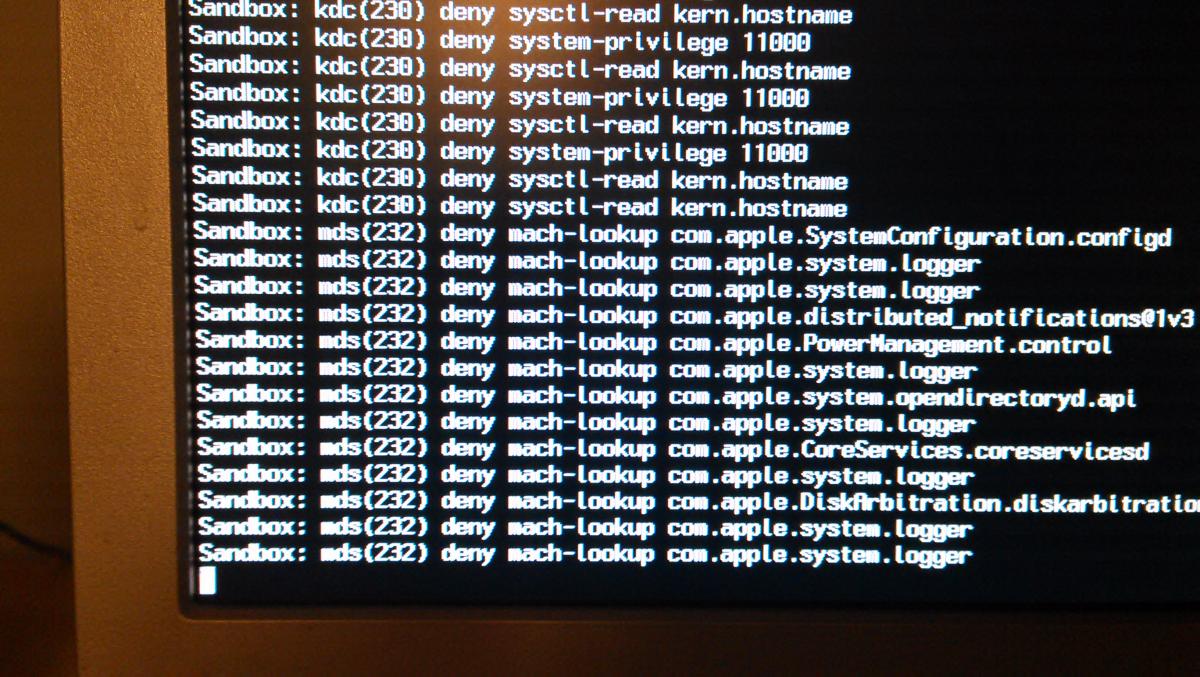

marvelloard Posted September 20, 2015 Share Posted September 20, 2015 Hi there, I try to replace Chameleon with Clover (mainly because of an easier possibility to setup a dual-boot with Linux (elementaryOS)). However, it's problematic. Hardware: EP45-DS3L, NVidia GTX 650 Ti, Intel Core2Quad 2,83GHz Currently Yosemite is working fine on this machine. It boots in seconds (SSD) and is absolutely stable, quick and reliable (as far as Yosemite can considered to be reliable..). So I installed Clover for a test run on a USB drive. Loader shows up BUT: -Yosemite loads until the login screen, then screen fades to blac (energy saving). Keyboard still responding (caps lock light working, mouse LED responding) so no complete freeze but graphical problem. Boot flags from Chameleon do not solve the problem. Old Chameleon config: <?xml version="1.0" encoding="UTF-8"?> <!DOCTYPE plist PUBLIC "-//Apple//DTD PLIST 1.0//EN" "http://www.apple.com/DTDs/PropertyList-1.0.dtd"> <plist version="1.0"> <dict> <key>Boot Banner</key> <string>No</string> <key>Graphics Mode</key> <string>1440x900x32</string> <key>GraphicsEnabler</key> <string>Yes</string> <key>Kernel Flags</key> <string>kext-dev-mode=1 PCIRootUID=1</string> <key>Legacy Logo</key> <string>Yes</string> <key>PciRoot</key> <string>1</string> <key>Theme</key> <string>Choose_Your_OS</string> <key>Timeout</key> <string>2</string> <key>UseKernelCache</key> <string>Yes</string> </dict> </plist> Clover config attached. -During verbose boot I get lots of those messages (TONS, boot is extremely slow with Clover): (see attached image) Process name changes, "deny" is flooding my screen -Trying to start Linux from it's partition leads to GRUB, which freezes the system. GRUB stays on the screen, can't get past that point. Can someone help me? config.plist.txt Link to comment https://www.insanelymac.com/forum/topic/308136-replace-chameleon-with-clover/ Share on other sites More sharing options...

marvelloard Posted September 21, 2015 Author Share Posted September 21, 2015 Thank you for your minimal config!As I am using a USB drive I still can test Clover. Sadly, it just doesn't work. Black screen (monitor going to energy saving), HDD active so no freeze. Also while booting my screen still gets flooded with "Sandbox ... deny..". I almost think this is related. With Chameleon, I never was able to make my Linux HDD visible. Installed Grub2 to MBR, to sda1 (root partition), tried to install on GPT HDD (Grub takes care because I have only BIOS, not UEFI), nothing. Chameleon will not recognise. Any ideas? Link to comment https://www.insanelymac.com/forum/topic/308136-replace-chameleon-with-clover/#findComment-2169503 Share on other sites More sharing options...

blackosx Posted September 22, 2015 Share Posted September 22, 2015 Oops. Good spot Rehabman. Sorry about that marvelloard. Your black screen indicates the video hasn’t kicked in. I’m using an ATI video card so haven’t any recent experience with NVidia card but I see you're using Chameleon’s GraphicsEnabler so let’s enable Clover’s. <?xml version="1.0" encoding="UTF-8"?> <!DOCTYPE plist PUBLIC "-//Apple//DTD PLIST 1.0//EN" "http://www.apple.com/DTDs/PropertyList-1.0.dtd"> <plist version="1.0"> <dict> <key>ACPI</key> <dict> <key>SSDT</key> <dict> <key>DropOem</key> <true/> <key>Generate</key> <true/> </dict> </dict> <key>Boot</key> <dict> <key>Arguments</key> <string>-v kext-dev-mode=1</string> <key>Legacy</key> <string>PBR</string> <key>Timeout</key> <integer>5</integer> </dict> <key>GUI</key> <dict> <key>Language</key> <string>de:0</string> <key>Mouse</key> <dict> <key>Enabled</key> <true/> </dict> <key>Scan</key> <true/> <key>ScreenResolution</key> <string>1440x900</string> <key>Theme</key> <string>iclover</string> </dict> <key>Graphics</key> <dict> <key>Inject</key> <dict> <key>NVidia</key> <true/> </dict> </dict> <key>SystemParameters</key> <dict> <key>InjectKexts</key> <string>Detect</string> </dict> </dict> </plist> Link to comment https://www.insanelymac.com/forum/topic/308136-replace-chameleon-with-clover/#findComment-2169583 Share on other sites More sharing options...
marvelloard Posted September 22, 2015 Author Share Posted September 22, 2015 Thank you guys again. Unfortunately I still get a black screen instead of desktop. Also I must mention I still cannot boot Linux from Clover as depending on which of the two entries I select the computer either simply reboots or I get a Windows-Bootcamp-Logo, where any keypress brings me back to Clover. It might be of interest that I changed my BIOS to Cartri long time ago, which made installing OSX a breeze (back in Snow Leopard days). Maybe a conflict? I completely forgot about that.. Link to comment https://www.insanelymac.com/forum/topic/308136-replace-chameleon-with-clover/#findComment-2169629 Share on other sites More sharing options...
