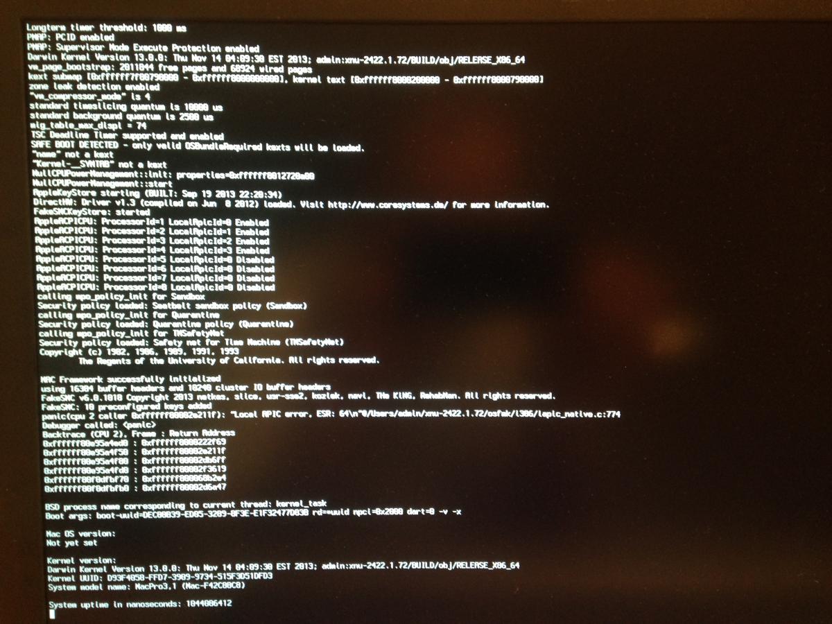

sasa.micovic Posted August 23, 2015 Share Posted August 23, 2015 Guys, In installation after first reboot, osx freeze on booting it stopped on system uptime in nanoseconds, check img: any idea how to fix this? spec of notebook:https://www.dropbox.com/s/yu680uahcimo51s/HP-ENVY-17-k100-Notebook.txt?dl=0Thanks Link to comment https://www.insanelymac.com/forum/topic/307733-mavericks-boot-problem-on-hp-envy-notebook/ Share on other sites More sharing options...

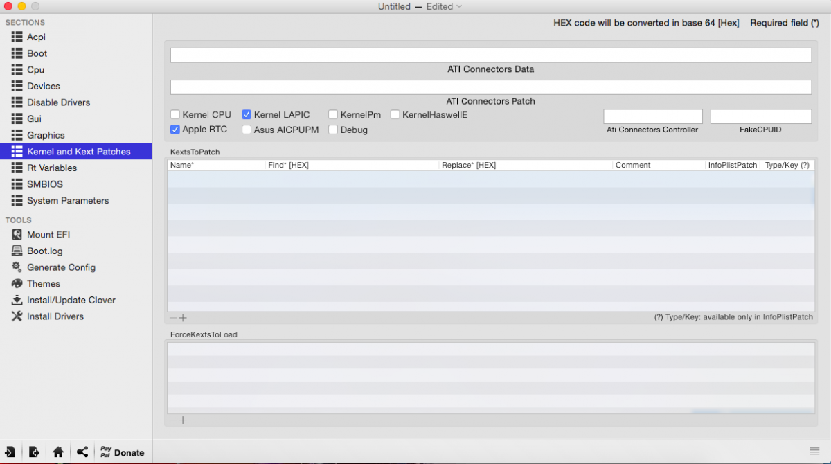

anonymousnbs Posted August 23, 2015 Share Posted August 23, 2015 (edited) Guys, In installation after first reboot, osx freeze on booting it stopped on system uptime in nanoseconds, check img: any idea how to fix this? spec of notebook: https://www.dropbox.com/s/yu680uahcimo51s/HP-ENVY-17-k100-Notebook.txt?dl=0 Thanks lapic kernel + If u used clover --> stick kernel lapic example : + if u use chameleon or enoch etc bootloader --> add bootflags : cpus=1 Edited August 23, 2015 by Allan Glued posts. Link to comment https://www.insanelymac.com/forum/topic/307733-mavericks-boot-problem-on-hp-envy-notebook/#findComment-2162773 Share on other sites More sharing options...

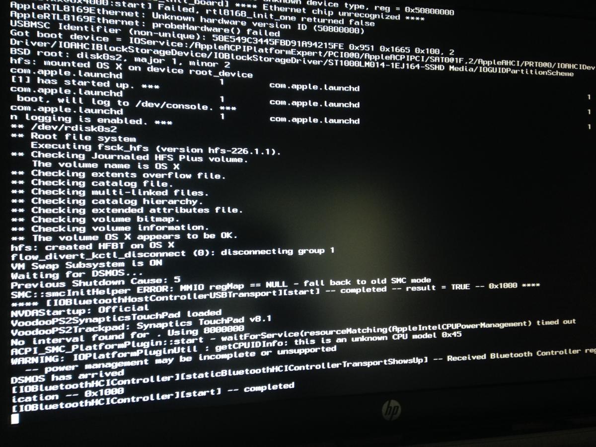

sasa.micovic Posted August 23, 2015 Author Share Posted August 23, 2015 with cpus=1 i get stuck with new message, now freeze on [iOBluetoothHCIController][start] – completed Link to comment https://www.insanelymac.com/forum/topic/307733-mavericks-boot-problem-on-hp-envy-notebook/#findComment-2162786 Share on other sites More sharing options...

sasa.micovic Posted August 23, 2015 Author Share Posted August 23, 2015 with boot flags: cpus=1 nv_disable=1 -v -x finally i come to desktop:) now we will see how it work... 1 Link to comment https://www.insanelymac.com/forum/topic/307733-mavericks-boot-problem-on-hp-envy-notebook/#findComment-2162831 Share on other sites More sharing options...

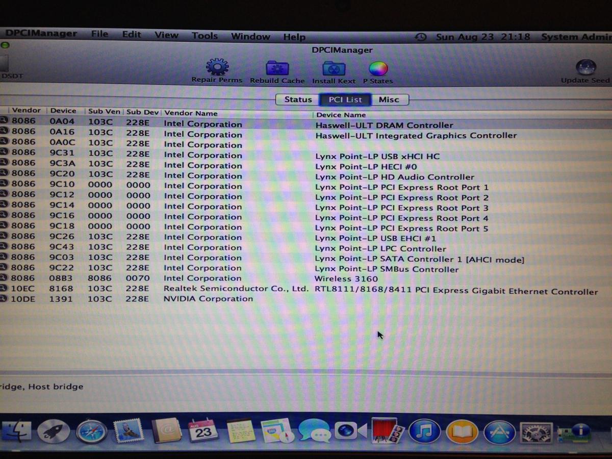

Allan Posted August 23, 2015 Share Posted August 23, 2015 You can download Clover/Chameleon/kexts using another PC/SO But for download in your own Hack, obiovuly you'll need Ethernet/WiFi working. So, what you can do is: Using another PC download DPCIManager, after install got to PCIList, take a screenshot and post here. Link to comment https://www.insanelymac.com/forum/topic/307733-mavericks-boot-problem-on-hp-envy-notebook/#findComment-2162848 Share on other sites More sharing options...
sasa.micovic Posted August 23, 2015 Author Share Posted August 23, 2015 check img Link to comment https://www.insanelymac.com/forum/topic/307733-mavericks-boot-problem-on-hp-envy-notebook/#findComment-2162868 Share on other sites More sharing options...
Allan Posted August 23, 2015 Share Posted August 23, 2015 WiFi = Is not compatible with OS X, you can replace for a compatible one. Here is the list of supported and unsupported card ( Yellow means work with WifiInjector kext, Green means work OOB, red means unsupported, HMB cards are cards also have Bluetooth )Or you can use a wifi dongle which is supported by OS X, but it also has downsides like battery draining, weak signal or causing sleep issues. Ethernet: RealtekRTL81xx-0_0_90.rar Link to comment https://www.insanelymac.com/forum/topic/307733-mavericks-boot-problem-on-hp-envy-notebook/#findComment-2162875 Share on other sites More sharing options...
