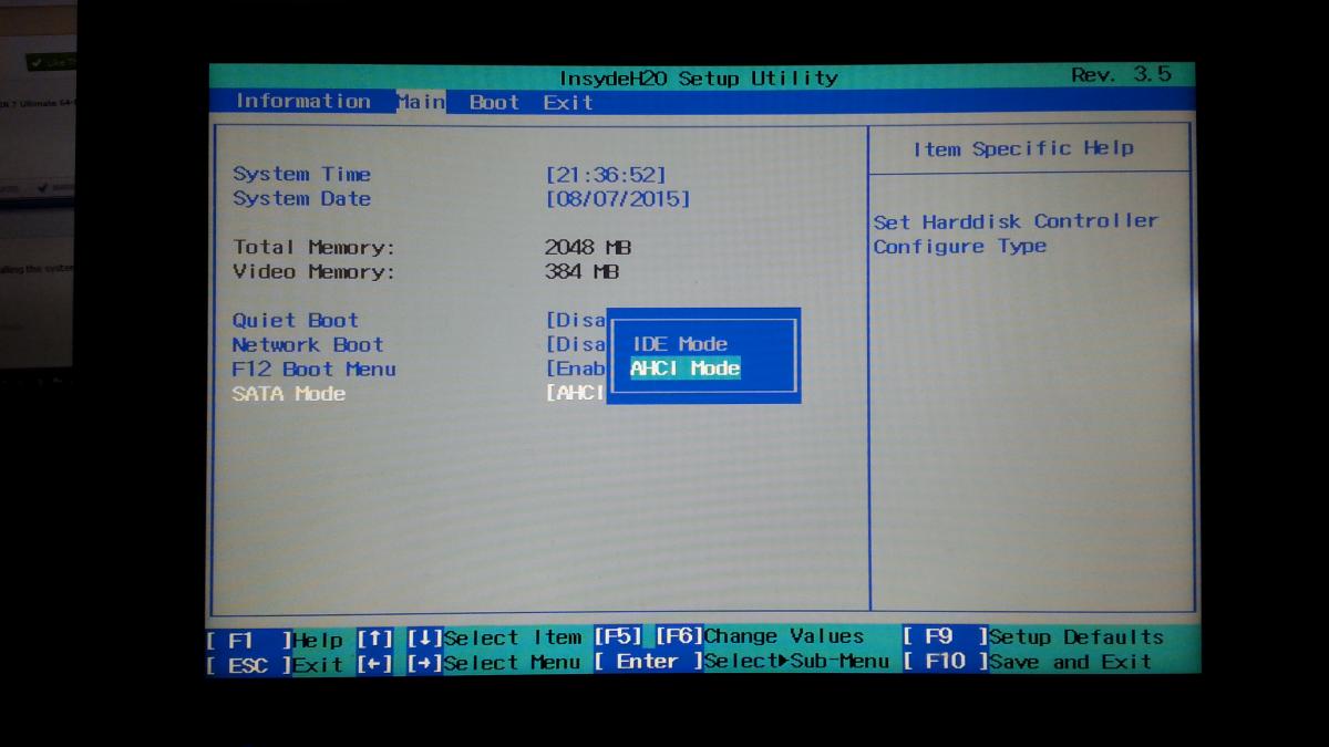

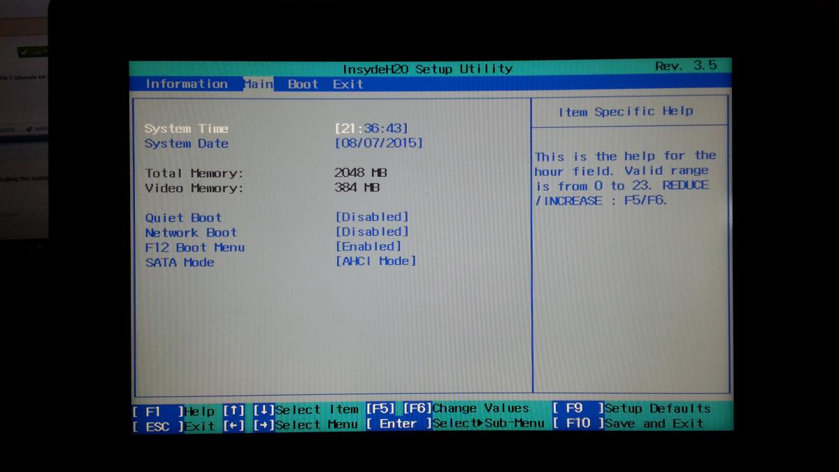

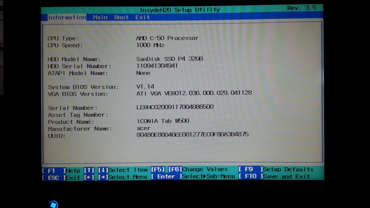

sniper9911 Posted August 7, 2015 Share Posted August 7, 2015 hello guys it seems this tablet amd cpu is not supported by most amd kernels , i dont see why but oh well specs : Acer Iconia tab W500 : amd c-50 cpu with hd6250 graphics , 2gb ddr3 ram and 32gb ssd , insydeh2o efi 3.5 NB bios v1.14 year 2011 , ahci enabled , no uefi option in bios i am trying to install one of the following os x : lion , mountain lion , mavricks , yosmite so far i tried myhack 3.3.1 and did usb installer from yosmite app from appstore , i also got lion app from my older hack and BOTH of them HALT after 5 seconds of booting with amd patched kernels what should i do ? screen shot : i also tried a distro at first but failed so i am going back to make it as vanilla as possible my distro tryout failed to start installation but it loads most kernels at first then it hangs/black screen this is the distro link : http://www.hackintosh.zone/hackintosh-topic/7089-acer-iconia-tab-w500-on-yosmitezone-10101/ Link to comment https://www.insanelymac.com/forum/topic/307477-help-hackintosh-on-acer-iconia-tab-w500/ Share on other sites More sharing options...

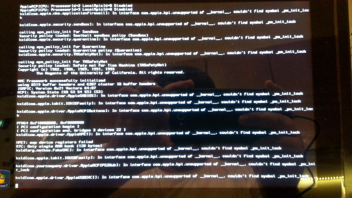

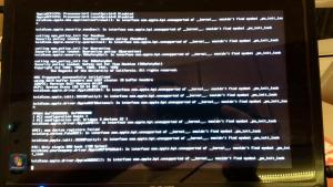

sniper9911 Posted August 7, 2015 Author Share Posted August 7, 2015 using bronya rc13 kernel for lion i tried both flags and still stuck on black sceen just like this nothing on screen for over 10 minutes on each try i just sent you photoes from galaxy note 2 , i will try in the afternoon , 2am now very sleepy update : still stuck on black screen after i tried -x with all flags Link to comment https://www.insanelymac.com/forum/topic/307477-help-hackintosh-on-acer-iconia-tab-w500/#findComment-2158692 Share on other sites More sharing options...

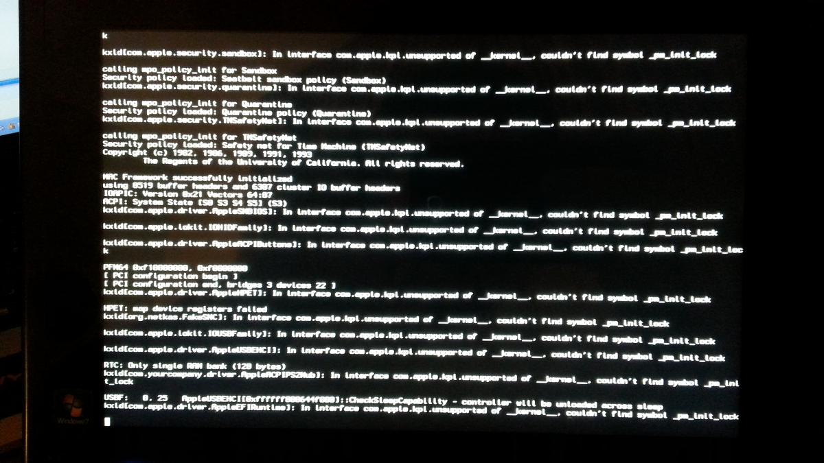

sniper9911 Posted August 8, 2015 Author Share Posted August 8, 2015 gonna try lots of kernels now .. wish me luck update : 1. kernel Bronzovka 10.7.4 : used -v flag , black screen after loading kexts 2. kernel Bronzovka 10.7.5 : used -v flag , black screen after loading kexts 3. kernel connactic : a. used -v flag : got this b. used -v arch=x86_64 got this c. used -v arch=i386 stopped earlier than before at this update : 4.a. IiTz ShAnE 10.7.4 kernel : used flag -v only , got this b. IiTz ShAnE 10.7.4 kernel : used flag -v -nossse3bit , got this Link to comment https://www.insanelymac.com/forum/topic/307477-help-hackintosh-on-acer-iconia-tab-w500/#findComment-2158853 Share on other sites More sharing options...

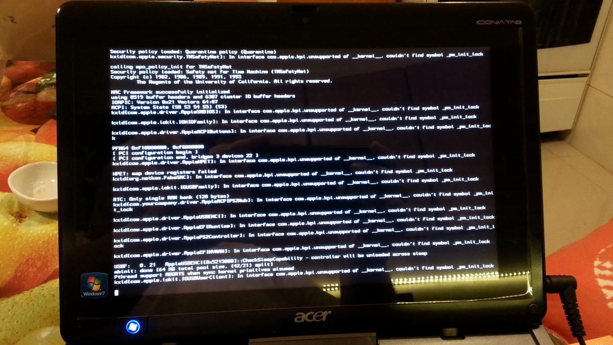

sniper9911 Posted August 9, 2015 Author Share Posted August 9, 2015 Using tora kernel 10.7.5 gives me this Link to comment https://www.insanelymac.com/forum/topic/307477-help-hackintosh-on-acer-iconia-tab-w500/#findComment-2159094 Share on other sites More sharing options...

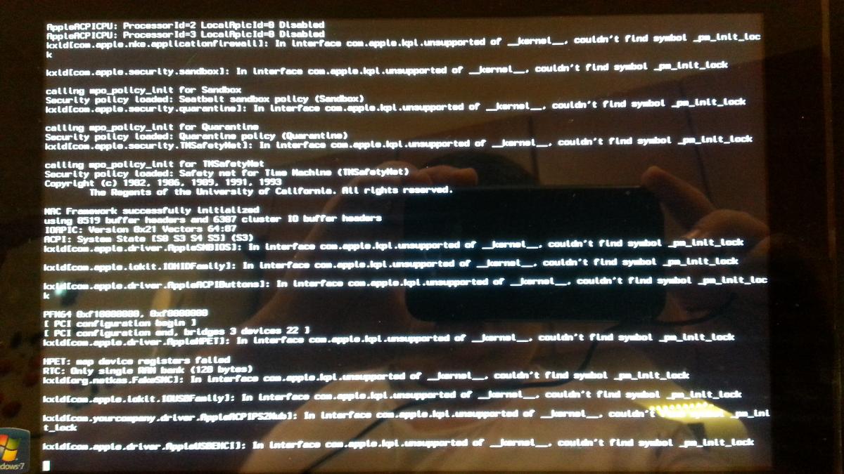

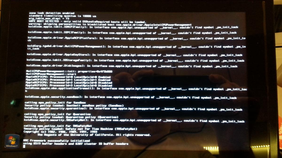

sniper9911 Posted August 10, 2015 Author Share Posted August 10, 2015 ok trying now -v -f -x npci=0x2000 GraphicsEnabler=Yes USBLegacyOff=Yes -v -f npci=0x2000 GraphicsEnabler=Yes USBLegacyOff=Yes both stops at : Mac framework successfully initialized using 8519 buffer headers and 6307 cluster IO buffer headers _ -v -f -x npci=0x2000 GraphicsEnabler=Yes or No USBBusFix=yes stops after loading kext and before the screen font changes to a smaller one Link to comment https://www.insanelymac.com/forum/topic/307477-help-hackintosh-on-acer-iconia-tab-w500/#findComment-2159193 Share on other sites More sharing options...

sniper9911 Posted August 22, 2015 Author Share Posted August 22, 2015 i got a reply to one of the other posts i did on another site says that my bios HPET is on and only way to make it off is by flashing another bios which i am against and very afraid to do anyway i think i hit a dead end Link to comment https://www.insanelymac.com/forum/topic/307477-help-hackintosh-on-acer-iconia-tab-w500/#findComment-2162575 Share on other sites More sharing options...
