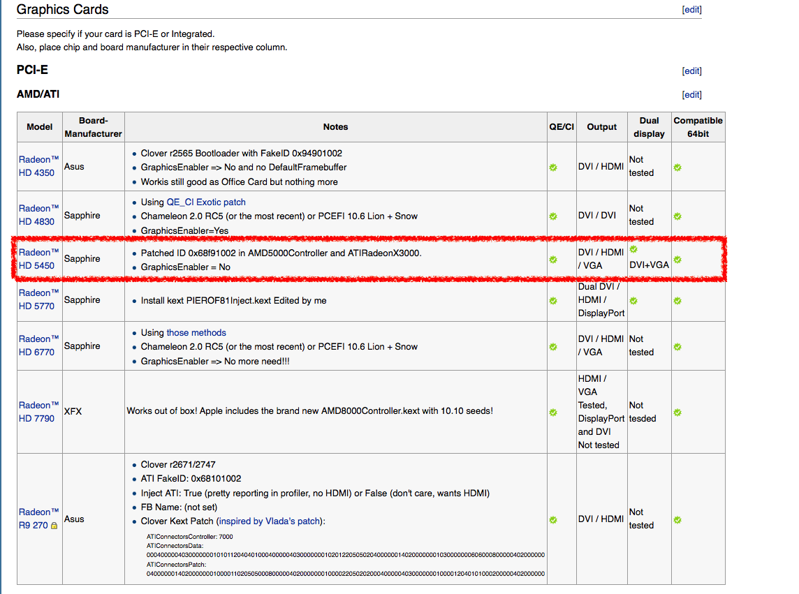

owbp Posted November 6, 2015 Share Posted November 6, 2015 Seems like it does http://wiki.osx86project.org/wiki/index.php/HCL_10.9.3 Edit http://www.insanelymac.com/forum/topic/301145-multi-monitors-on-yosemite/?p=2082293 1 Link to comment https://www.insanelymac.com/forum/topic/307176-cheapest-video-card-for-yosemitemavericks/#findComment-2185994 Share on other sites More sharing options...
d620osx Posted November 6, 2015 Share Posted November 6, 2015 Does Sapphire HD5450 512mb supports dual monitors?Yes, I had 2 dell 2209 wa's running with my one. I had to get a HDMI to dvi cable for the second monitor. 1 Link to comment https://www.insanelymac.com/forum/topic/307176-cheapest-video-card-for-yosemitemavericks/#findComment-2186095 Share on other sites More sharing options...
