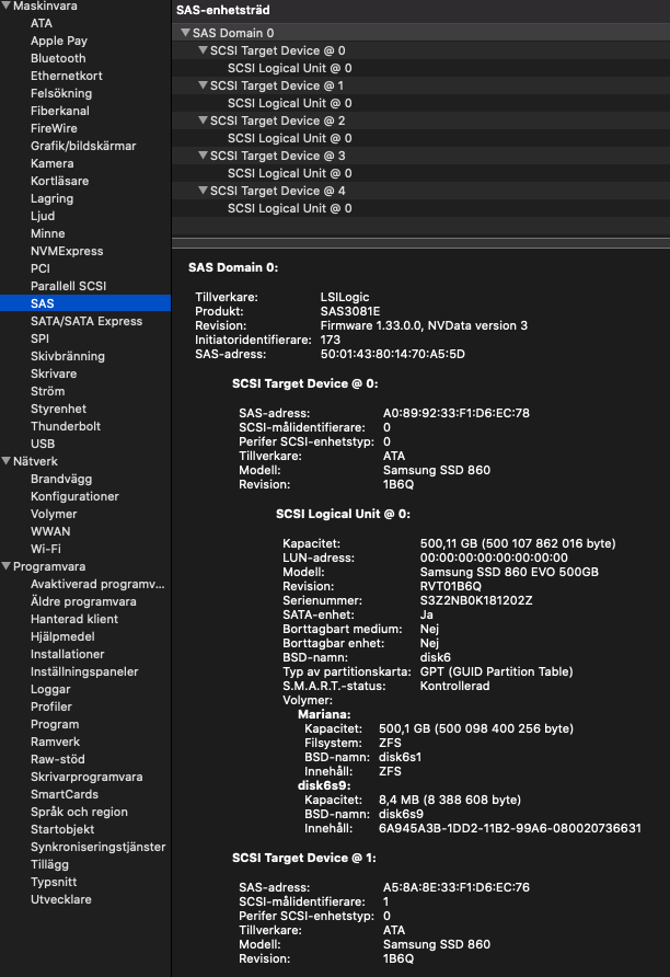

I found a way to flash the firmware and bios of the SAS3081/1068 controller into IT mode so that I could connect another bunch of drives where I have my ZFS pool. 😃👍
https://andybrown.me.uk/forum/index.php?topic=14.361

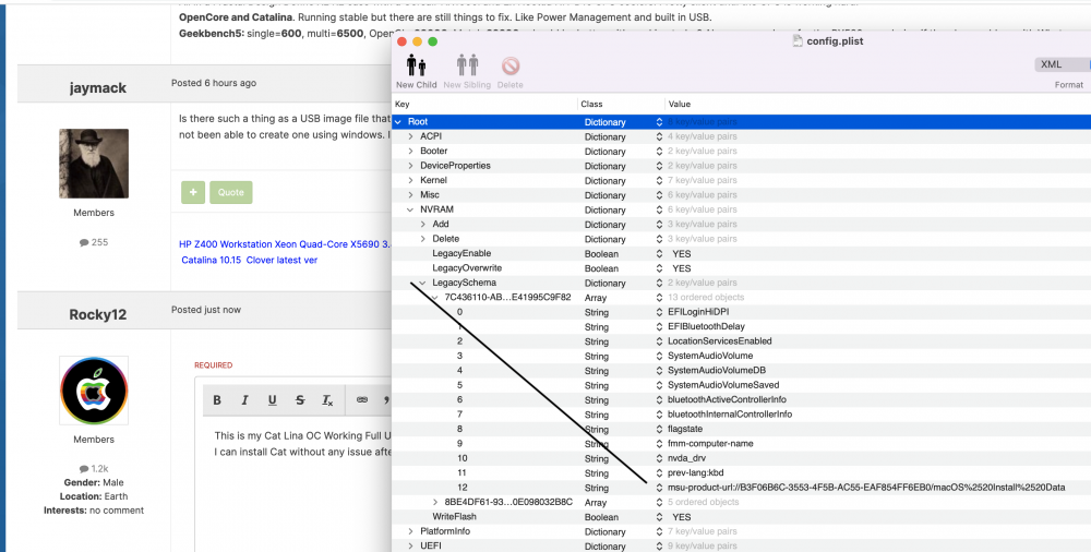

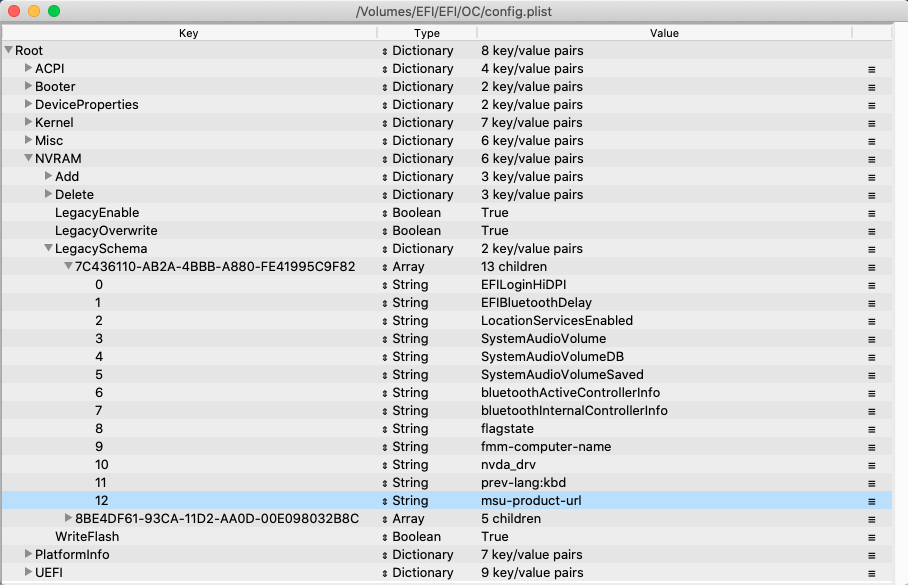

2. Add the additional value "msu-product-url" to the "LegacySchema" section under "7C436110-AB2A-4BBB-A880-FE41995C9F82"
3. Add the necessary value to the NVRAM using following command:
sudo nvram msu-product-url="msu-product-url://$(diskutil info /System/Volumes/Data | grep "Volume UUID" | awk '{print $3}')/macOS%2520Install%2520Data"
4. Upgrade to BigSur from inside Catalina
5. The system restarts now to a working updater
6. After several restarts the system is updated to BigSur
7. Remove NVRAM variable and previous added OC config Entry "msu-product-url"
8. Have Fun with BigSur

(Still can’t get the emulated NVRAM to work or maybe it’s working but gets wiped at shutdown for whatever reason? It retains whatever data I put in it but not after reboot.)
Now I just have to figure out how to shuffle the small ssd’s I have to make a bootable drive that I can then clone onto the NVMe drive. 🤔
EDIT 2:
This msu-product…. variable that needs to be in the Nvram, could it not be put there at boot by editing the OC config.plist?
I have tried this many times now and even verified that the LogoutHook is in place in com.apple.loginwindow but it still will not retain NVRAM variables after rebooting.
