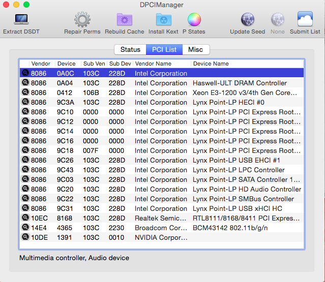

Allan Posted July 1, 2015 Share Posted July 1, 2015 Download DPCIManager, go to PCIList and take a screenshot. Post here. Or if you know what is your Hardware specs, would be good post here. And for battery, you can use: VoodooBattery or ACPIBatteryManager.kext All you need is use search box: DSDT/SSDT: Enable battery by patching your DSDT using pre-made patches ( Laptop-exclusive ) Link to comment https://www.insanelymac.com/forum/topic/306901-battery-problem-and-wifi-hp-envy/#findComment-2149769 Share on other sites More sharing options...

artur_pt Posted July 1, 2015 Share Posted July 1, 2015 hello try this one DSDT.aml.zip ur wifi is not compatible good hack 2 Link to comment https://www.insanelymac.com/forum/topic/306901-battery-problem-and-wifi-hp-envy/#findComment-2149809 Share on other sites More sharing options...
klaud Posted July 1, 2015 Author Share Posted July 1, 2015 hello try this one DSDT.aml.zip ur wifi is not compatible good hack hello, thank you, where do I copy it? in efi/clover/acpi/patched? Link to comment https://www.insanelymac.com/forum/topic/306901-battery-problem-and-wifi-hp-envy/#findComment-2149813 Share on other sites More sharing options...
Allan Posted July 1, 2015 Share Posted July 1, 2015 hello, thank you, where do I copy it? in efi/clover/acpi/patched? Yes. Link to comment https://www.insanelymac.com/forum/topic/306901-battery-problem-and-wifi-hp-envy/#findComment-2149815 Share on other sites More sharing options...
klaud Posted July 1, 2015 Author Share Posted July 1, 2015 Yes. yes yes yes!!!!!!!!! i am very happy !! and for the wifi?thank you !!! 1 Link to comment https://www.insanelymac.com/forum/topic/306901-battery-problem-and-wifi-hp-envy/#findComment-2149831 Share on other sites More sharing options...
Allan Posted July 1, 2015 Share Posted July 1, 2015 Like related before, your WiFi is not compatible with OS X. You can buy a compatible PCI card or a USB dondle. Link to comment https://www.insanelymac.com/forum/topic/306901-battery-problem-and-wifi-hp-envy/#findComment-2149839 Share on other sites More sharing options...
klaud Posted July 1, 2015 Author Share Posted July 1, 2015 Like related before, your WiFi is not compatible with OS X. You can buy a compatible PCI card or a USB dondle. what is compatible? Link to comment https://www.insanelymac.com/forum/topic/306901-battery-problem-and-wifi-hp-envy/#findComment-2149844 Share on other sites More sharing options...
Allan Posted July 1, 2015 Share Posted July 1, 2015 Man, you really need use our search bar huh!? With a little search and using the right words, look what i can find: The right hardware for your Hackintosh Link to comment https://www.insanelymac.com/forum/topic/306901-battery-problem-and-wifi-hp-envy/#findComment-2149850 Share on other sites More sharing options...
mnfesq Posted July 1, 2015 Share Posted July 1, 2015 what is compatible? Azurewave AW-CE123H 802.11ac/nbg WiFi+BT Broadcom Bluetooth 4.0 Just use a firmware injector kext and add your VID/PID in decimal format. 1 Link to comment https://www.insanelymac.com/forum/topic/306901-battery-problem-and-wifi-hp-envy/#findComment-2149853 Share on other sites More sharing options...

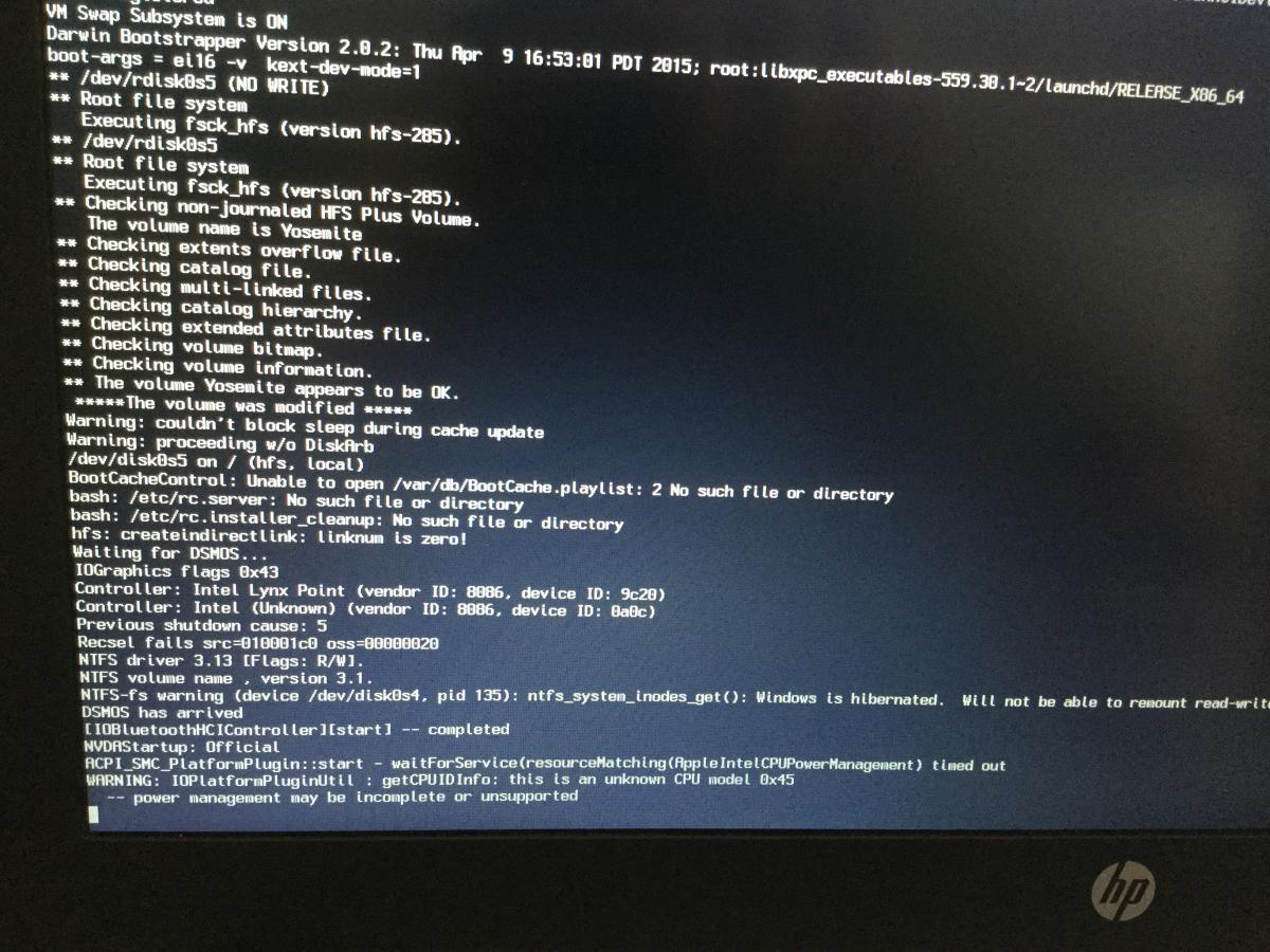

klaud Posted July 2, 2015 Author Share Posted July 2, 2015 Don't worry about that. We want to help our users to know how use the available tools. So, you can solve your problems without having to open new topics. I do not know if the place is right and I had to open a new post, but after the upgrade of Yosemite pc reboots always, in verbose mode comes this how to fix? Link to comment https://www.insanelymac.com/forum/topic/306901-battery-problem-and-wifi-hp-envy/#findComment-2150132 Share on other sites More sharing options...
Allan Posted July 2, 2015 Share Posted July 2, 2015 Use a correct SMBios. Link to comment https://www.insanelymac.com/forum/topic/306901-battery-problem-and-wifi-hp-envy/#findComment-2150134 Share on other sites More sharing options...
klaud Posted July 2, 2015 Author Share Posted July 2, 2015 Use a correct SMBios. how to solve? what should I do? Link to comment https://www.insanelymac.com/forum/topic/306901-battery-problem-and-wifi-hp-envy/#findComment-2150135 Share on other sites More sharing options...
Allan Posted July 2, 2015 Share Posted July 2, 2015 Search bar? Post#22 Custom SMBios Link to comment https://www.insanelymac.com/forum/topic/306901-battery-problem-and-wifi-hp-envy/#findComment-2150139 Share on other sites More sharing options...
klaud Posted July 2, 2015 Author Share Posted July 2, 2015 Search bar? Post#22 Custom SMBios ok but what do I have to change to fix it? Search bar? Post#22 Custom SMBios SMBios MacBookPro11,1 it's wrong? Link to comment https://www.insanelymac.com/forum/topic/306901-battery-problem-and-wifi-hp-envy/#findComment-2150142 Share on other sites More sharing options...
Allan Posted July 2, 2015 Share Posted July 2, 2015 You need choose a SMBios with similarity of real Macs: http://www.everymac.com/ultimate-mac-lookup/?search_keywords=MacBookPro11,2 Link to comment https://www.insanelymac.com/forum/topic/306901-battery-problem-and-wifi-hp-envy/#findComment-2150145 Share on other sites More sharing options...
