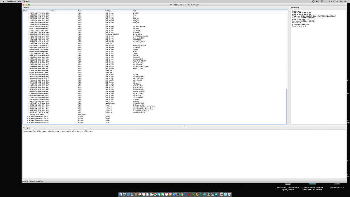

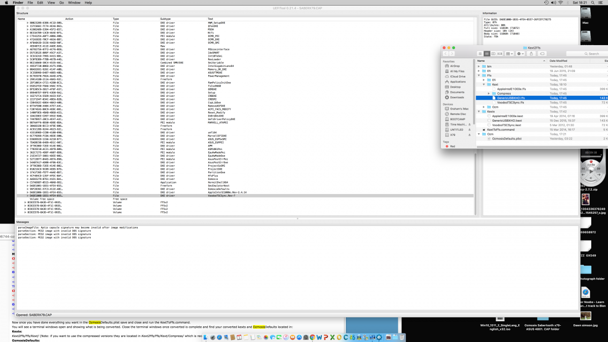

BALDY_MAN Posted July 2, 2016 Share Posted July 2, 2016 Hi All As you can see from the screenshot i have tried to convert kext file to ffs to and to bios. have converted kext but when i have added to bios comes up as DXE driver not ffs why is it not stay a ffs file Link to comment https://www.insanelymac.com/forum/topic/306744-ozmosis-uefi-bios-modding-guide/page/2/#findComment-2247325 Share on other sites More sharing options...
crusher Posted July 2, 2016 Share Posted July 2, 2016 Use my kext2ffs Hi All As you can see from the screenshot i have tried to convert kext file to ffs to and to bios. have converted kext but when i have added to bios comes up as DXE driver not ffs why is it not stay a ffs file Say which CPU you have? How much core have? Link to comment https://www.insanelymac.com/forum/topic/306744-ozmosis-uefi-bios-modding-guide/page/2/#findComment-2247349 Share on other sites More sharing options...
BALDY_MAN Posted July 3, 2016 Share Posted July 3, 2016 @crusher. thank you for sharing your Kext2Ffs tool that worked first try. as you can see from the screen shot . i'm undecided what cpu to use. i have a Xeon E5-2603. Quad core. i was going to try it with. i have set the default plist to a mac 6.1. i should have my motherboard back sometime next week and i was just setting myself up. trying out these wonderful bios tools. the all the developers have made for us to use (Thanks to all the back ground boys and girls) i have add the latest bios attempt. for you to glance at if you have a spare moment Best Regards Graham Sabertooth x 79 Ozmosis. version.2 .zip Link to comment https://www.insanelymac.com/forum/topic/306744-ozmosis-uefi-bios-modding-guide/page/2/#findComment-2247489 Share on other sites More sharing options...
