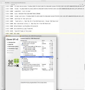

fusion71au Posted June 4, 2015 Share Posted June 4, 2015 @uPaymeiFixit, On my legacy BIOS desktop (GAP55aUD3/Intel i5 750/AMD HD 5770), I found installing Clover with the BiosBlockIO option greatly reduced the time taken to reach the Clover Main Menu: You can also compile Clover yourself with CloverGrowerPro and use the "-D DISABLE_USB_SUPPORT" option to disable scanning for USB devices except the keyboard during boot - see @Maniac10's guide here (in Spanish - use google translate ). The "Activate Only SATA0 Patch by default" option will allow Clover to scan for only the hard disk attached to the first SATA port. Good Luck! 3 Link to comment https://www.insanelymac.com/forum/topic/306465-clover-takes-20-seconds-is-this-slow/#findComment-2141892 Share on other sites More sharing options...
