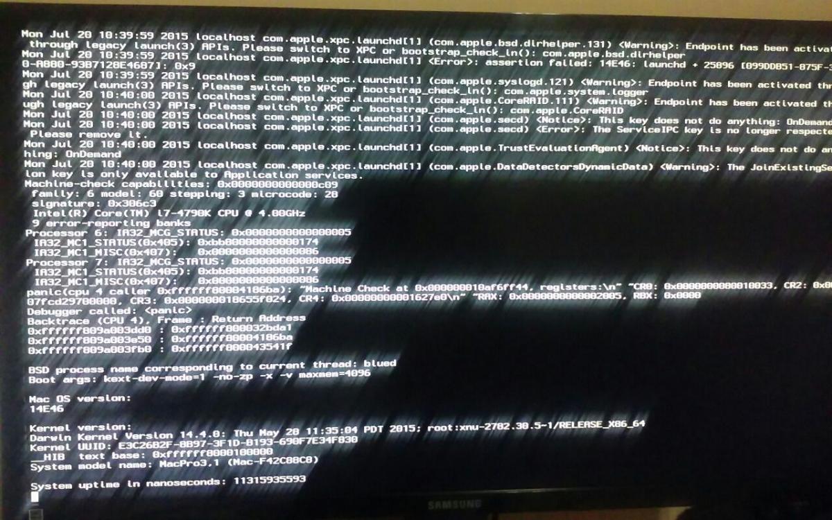

santi.ramirezv Posted July 21, 2015 Share Posted July 21, 2015 Hi dudes! I'm having these Kernel Panic. CPU Caller 4 "Machine Check at 0x000000010af6ff44, registers:\n" In the attachment you can see the the whole thing. I tried both [url="http://www.insanelymac.com/forum/topic/279450-why-insanelymac-does-not-support-tonymacx86/"]#####[/url] and Clover in order to get Yosemite 10.10.3 I also had problems installing Ubuntu with a bootloader, so I don't know whats happening with my PC. Don't know much about computers and feel kind of desperate. GA Z97X UD7 TH Intel i7 4790K Internal Graphics Samsung 850 EVO 500GB Link to comment https://www.insanelymac.com/forum/topic/306328-yosemite-ga-z97x-ud7-th-i7-4790k-install-notes/#findComment-2154630 Share on other sites More sharing options...
dougaa Posted July 22, 2015 Author Share Posted July 22, 2015 Hi dudes! I'm having these Kernel Panic. CPU Caller 4 "Machine Check at 0x000000010af6ff44, registers:\n" In the attachment you can see the the whole thing. I tried both ##### and Clover in order to get Yosemite 10.10.3 I also had problems installing Ubuntu with a bootloader, so I don't know whats happening with my PC. Don't know much about computers and feel kind of desperate. GA Z97X UD7 TH Intel i7 4790K Internal Graphics Samsung 850 EVO 500GB Did you build your computer, and did you do any tests to make sure the hardware is working properly? If a straightforward install of Ubuntu (or another linux) doesn't work, there's probably some hardware problem you'll have to solve first. With linux installed, you could run memtest86+ to test the memory, and that's also a pretty good test of the machine as a whole. I always run it for a while after building a new machine. You can also make a memtest86+ boot disk or USB stick, and run it standalone. For OS X, make sure VT-D is disabled in the BIOS, as I wrote above. Link to comment https://www.insanelymac.com/forum/topic/306328-yosemite-ga-z97x-ud7-th-i7-4790k-install-notes/#findComment-2154689 Share on other sites More sharing options...
santi.ramirezv Posted July 22, 2015 Share Posted July 22, 2015 Sorry for my noobness but what is the fastest way to do make a memtest86 usb from a Macbook Pro? Could be that the config.plist is giving me problems instead of hardware? If so, How can I change it for my computer to work? Thank you very much for your help! Link to comment https://www.insanelymac.com/forum/topic/306328-yosemite-ga-z97x-ud7-th-i7-4790k-install-notes/#findComment-2154693 Share on other sites More sharing options...
santi.ramirezv Posted July 31, 2015 Share Posted July 31, 2015 Hi! So I managed to install Ubuntu. This could tell me that my hardware is alright at least at making one OS to function. My current status is this: Tried to install Yosemite 10.10.3 with Clover using this guide. I change the EFI folder with this one: https://www.dropbox.com/s/oqyghhlg2o1c4yj/EFI%20Quadie.zip?dl=0 Moderator Quadie did it for me. Change the BIOS Settings with this guide. And finally it all freeze here: Link to comment https://www.insanelymac.com/forum/topic/306328-yosemite-ga-z97x-ud7-th-i7-4790k-install-notes/#findComment-2156799 Share on other sites More sharing options...
dougaa Posted July 31, 2015 Author Share Posted July 31, 2015 In the BIOS, have you disabled VT-d? Have you tried booting in safe mode? Link to comment https://www.insanelymac.com/forum/topic/306328-yosemite-ga-z97x-ud7-th-i7-4790k-install-notes/#findComment-2156802 Share on other sites More sharing options...
santi.ramirezv Posted August 3, 2015 Share Posted August 3, 2015 Hi! I finally get to work Yosemite 10.10.4. I just used cpus=1 on config.plist. Activate it with Clover Configurator. Now I have some problems with the Magic Trackpad and with Chrome Browser. Trackpad has issues with most of the gestures. They just don't work. And I use the same trackpad on another hackintosh of a friend and was working just fine. Chrome crashes every time I open it. Just a few seconds after. Thunderbolt does not work yet. But haven't installed the drivers with Windows. Could this be done with Crossover? And the hackintosh is booting very slow. For the gear it is, should boot faster. I takes likes two and half minutes to get to the users login. I didn't disable VT-d, which is weird, because in every place I read that it is needed but in the guide Quadie gave me it did not mention it at all. Could this solve the slow booting issue? Link to comment https://www.insanelymac.com/forum/topic/306328-yosemite-ga-z97x-ud7-th-i7-4790k-install-notes/#findComment-2157389 Share on other sites More sharing options...
