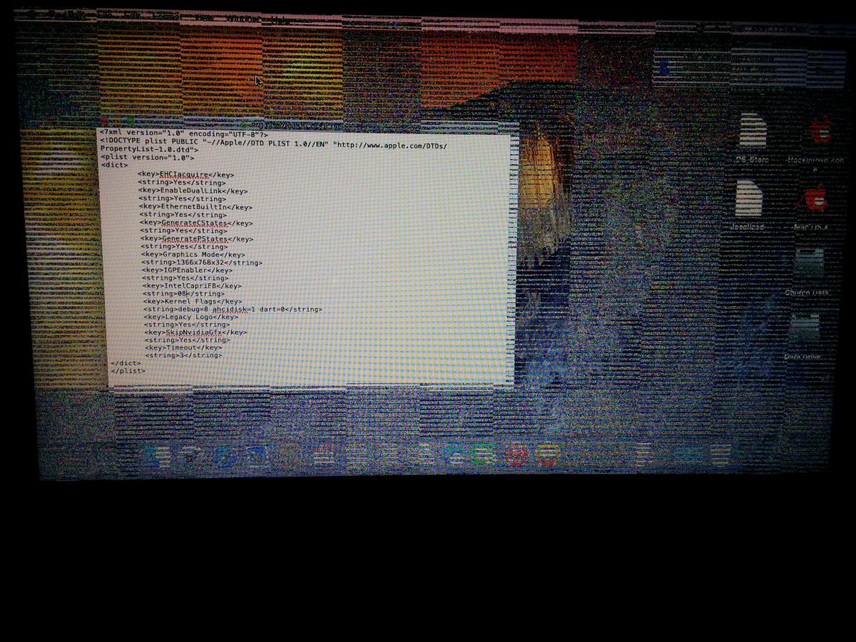

David John Posted April 13, 2015 Share Posted April 13, 2015 My screen is flickering, but the graphics is working with acceleration. Please help me fix flickering for yosemite. Tried with all values of IntelCapriFB. I have no success! Please help me Link to comment https://www.insanelymac.com/forum/topic/305641-lenovo-g500-screen-flickering-on-intel-hd4000/ Share on other sites More sharing options...
Mirone Posted April 13, 2015 Share Posted April 13, 2015 use this value in ig-platform-id = 01660004 but rather edit the binary of your AppleIntelFramebufferCapri.kext Copy the values of 01660003, 01660004 to (only LVDS). AAPL, ig-platform-id: 01660003, Stolen RAM is FB: 64MB, Pipes: 2, Ports: 4, FBMem: 2 @ 0, 05 03 00 00 02 00 00 00 30 00 00 00 // (LVDS) @ 1 02 05 00 00 00 04 00 00 07 04 00 00 // (DisplayPort) @ 2 03 04 00 00 00 04 00 00 81 00 00 00 // (DisplayPort) @ 3 04 06 00 00 00 04 00 00 81 00 00 00 // (DisplayPort) AAPL, ig-platform-id: 01660004, Stolen RAM is FB: 32MB, Pipes: 3, Ports: 1, FBMem: 1 @ 0, 05 03 00 00 02 00 00 00 30 02 00 00 // (LVDS) ---> switch to @ 0, 05 03 00 00 02 00 00 00 30 00 00 00 Link to comment https://www.insanelymac.com/forum/topic/305641-lenovo-g500-screen-flickering-on-intel-hd4000/#findComment-2127795 Share on other sites More sharing options...

Mirone Posted April 13, 2015 Share Posted April 13, 2015 use this App http://www.macupdate.com/app/mac/22589/hex-fiend to open the Binary. open the binary find for: 05 03 00 00 02 00 00 00 30 02 00 00 replace: 05 03 00 00 02 00 00 00 30 00 00 00 Link to comment https://www.insanelymac.com/forum/topic/305641-lenovo-g500-screen-flickering-on-intel-hd4000/#findComment-2127809 Share on other sites More sharing options...
David John Posted April 13, 2015 Author Share Posted April 13, 2015 use this App http://www.macupdate.com/app/mac/22589/hex-fiend to open the Binary. open the binary find for: 05 03 00 00 02 00 00 00 30 02 00 00 replace: 05 03 00 00 02 00 00 00 30 00 00 00 I tried doing it. But I still see the same thing happening. I am using chameleon bootloader and how do I add this boot flag "use this value in ig-platform-id = 01660004" ??? I tried doing it. But I still see the same thing happening. I am using chameleon bootloader and how do I add this boot flag "use this value in ig-platform-id = 01660004" ??? use this App http://www.macupdate.com/app/mac/22589/hex-fiend to open the Binary. open the binary find for: 05 03 00 00 02 00 00 00 30 02 00 00 replace: 05 03 00 00 02 00 00 00 30 00 00 00 Hi Mirone, How do I edit the binary? Can u brief me please? use this value in ig-platform-id = 01660004 but rather edit the binary of your AppleIntelFramebufferCapri.kext Copy the values of 01660003, 01660004 to (only LVDS). AAPL, ig-platform-id: 01660003, Stolen RAM is FB: 64MB, Pipes: 2, Ports: 4, FBMem: 2 @ 0, 05 03 00 00 02 00 00 00 30 00 00 00 // (LVDS) @ 1 02 05 00 00 00 04 00 00 07 04 00 00 // (DisplayPort) @ 2 03 04 00 00 00 04 00 00 81 00 00 00 // (DisplayPort) @ 3 04 06 00 00 00 04 00 00 81 00 00 00 // (DisplayPort) AAPL, ig-platform-id: 01660004, Stolen RAM is FB: 32MB, Pipes: 3, Ports: 1, FBMem: 1 @ 0, 05 03 00 00 02 00 00 00 30 02 00 00 // (LVDS) ---> switch to @ 0, 05 03 00 00 02 00 00 00 30 00 00 00 I tried the same way that you suggested me Mirone, This is my chameleon code: <?xml version="1.0" encoding="UTF-8"?> <!DOCTYPE plist PUBLIC "-//Apple//DTD PLIST 1.0//EN" "http://www.apple.com/DTDs/PropertyList-1.0.dtd"> <plist version="1.0"> <dict> <key>EHCIacquire</key> <string>Yes</string> <key>EnableDualLink</key> <string>Yes</string> <key>EnableWifi</key> <string>Yes</string> <key>EthernetBuiltIn</key> <string>Yes</string> <key>GenerateCStates</key> <string>Yes</string> <key>GeneratePStates</key> <string>Yes</string> <key>Graphics Mode</key> <string>1366x768x32</string> <key>IGPEnabler</key> <string>Yes</string> <key>InjectIntel-ig</key> <string>01660004</string> <key>Kernel Flags</key> <string>dart=0</string> <key>Legacy Logo</key> <string>Yes</string> <key>SkipNvidiaGfx</key> <string>Yes</string> <key>Timeout</key> <string>3</string> <key>device-properties</key> <string>640000000100000001000000580000000100000002010c00d041030a000000000101060000010101060000007fff04002c0000004100410050004c002c00690067002d0070006c006100740066006f0072006d002d006900640000000800000004006601</string> </dict> </plist> and this is my device-properties.plist file: <?xml version="1.0" encoding="UTF-8"?> <!DOCTYPE plist PUBLIC "-//Apple//DTD PLIST 1.0//EN" "http://www.apple.com/DTDs/PropertyList-1.0.dtd"> <plist version="1.0"> <dict> <key>PciRoot(0x0)/Pci(0x1,0x0)/Pci(0x0,0x0)</key> <dict> <key>AAPL,ig-platform-id</key> <string>0x01660004</string> </dict> </dict> </plist> Can someone please help me out as I have tried all my known ways. Don't know what to do? Link to comment https://www.insanelymac.com/forum/topic/305641-lenovo-g500-screen-flickering-on-intel-hd4000/#findComment-2127814 Share on other sites More sharing options...
Mirone Posted April 13, 2015 Share Posted April 13, 2015 try this kext: AppleIntelFramebufferCapri.kext.zip 2 Link to comment https://www.insanelymac.com/forum/topic/305641-lenovo-g500-screen-flickering-on-intel-hd4000/#findComment-2127842 Share on other sites More sharing options...
David John Posted April 14, 2015 Author Share Posted April 14, 2015 try this kext: AppleIntelFramebufferCapri.kext.zip This Kext works after I changed and generated a new hex for the device properties... Awesommm Mirone! Will this kext work for all versions of Yosemite? Link to comment https://www.insanelymac.com/forum/topic/305641-lenovo-g500-screen-flickering-on-intel-hd4000/#findComment-2127875 Share on other sites More sharing options...
