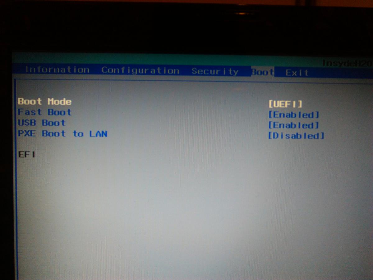

hello, I also own Intel HD 5500 graphics card, you can help me?

currently installed os x el capitan UEFI bios settings
Solaris82: create a specific topic.
So you have installed Mac or just set the bios ?
So you have video memory option in your bios ?
Have you set it to 64mb or more ?
You can follow my guide to install El capitan on Hp 820 G2 who as 5300u and hd5500.
http://www.insanelymac.com/forum/topic/308047-guide-hp-elitebook-820-840-g2-i5-5300u-hd5500-el-capitan-eng/?fromsearch=1
Cheers
Cheers
bios in there 'a chance to change 32 - 64- 128

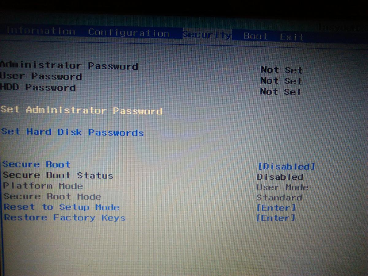

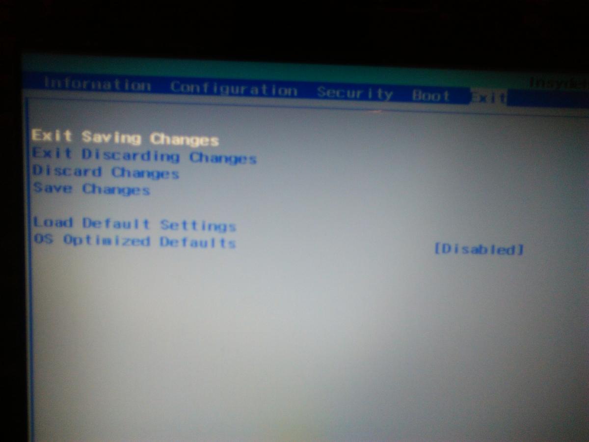

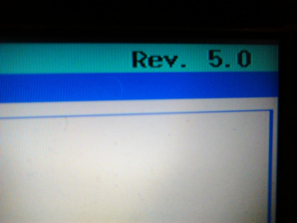

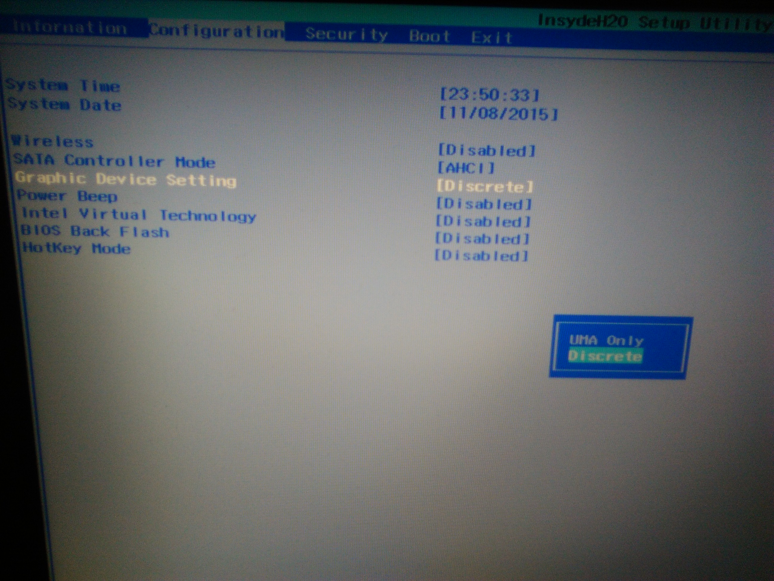

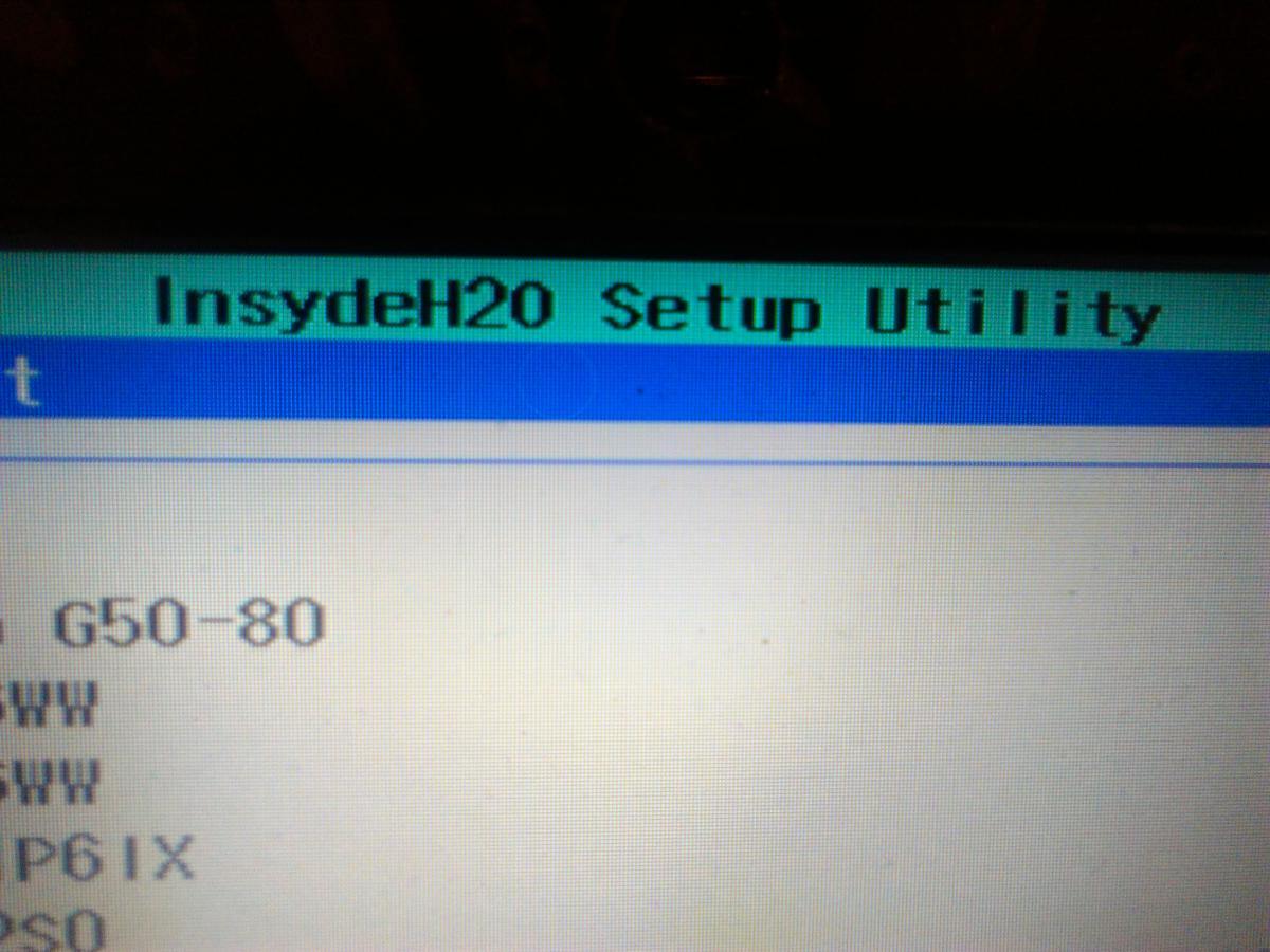

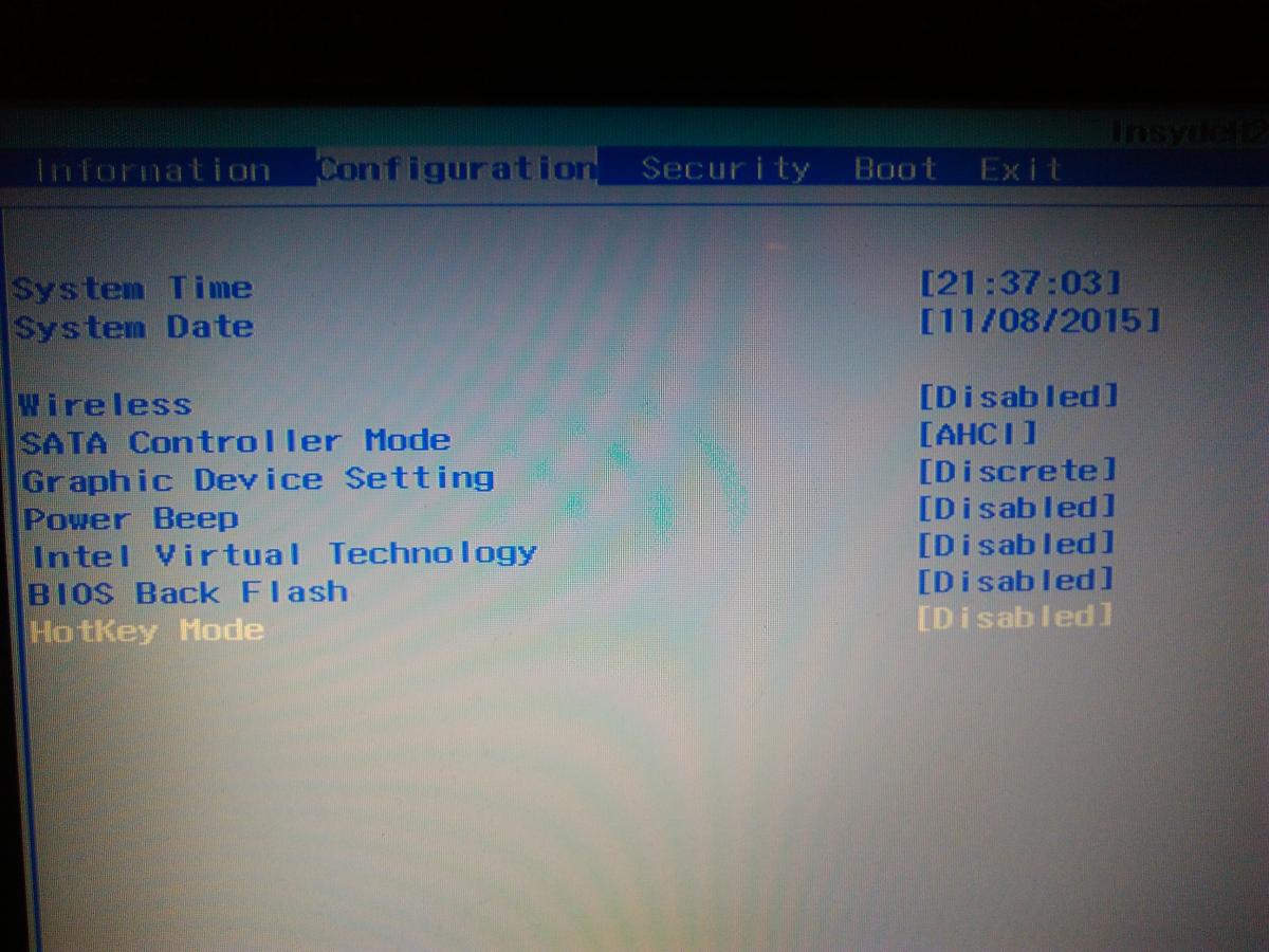

I have a Lenovo G50-80 Laptop and like to crack the bios Insydeh20 Rev. 5.0, to increase the Vram of my 64 mb Intel HD Graphics 5500.
in the zip folder there are 5 versions of the BIOS, the b0cn75ww/// b0cn79ww/// b0cn80ww/// b0cn95ww the last update b0cn96ww. I do not know what is best to unlock: solaris82.altervista.org/BIOS.zip /// last update the site lenovo: https://download.lenovo.com/consumer/mobiles/b0cn96ww.exe
Can somebody please crack it? Or show which Laptops use the same Bios as my?
