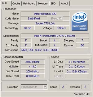

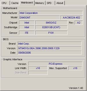

aster Posted July 13, 2007 Share Posted July 13, 2007 I have an Intel Core duo with the D945GNT (see jpgs). 10.4.8 worked perfectly without Networking and without sound. I really need the network. Link to comment https://www.insanelymac.com/forum/topic/30419-core-2-duo-on-intel-945-board/#findComment-407351 Share on other sites More sharing options...

master54 Posted March 1, 2010 Share Posted March 1, 2010 I have an Intel Core duo with the D945GNT (see jpgs).10.4.8 worked perfectly without Networking and without sound. I really need the network. Wtf... This is PENTIUM dual core, not Core duo... Link to comment https://www.insanelymac.com/forum/topic/30419-core-2-duo-on-intel-945-board/#findComment-1420787 Share on other sites More sharing options...
