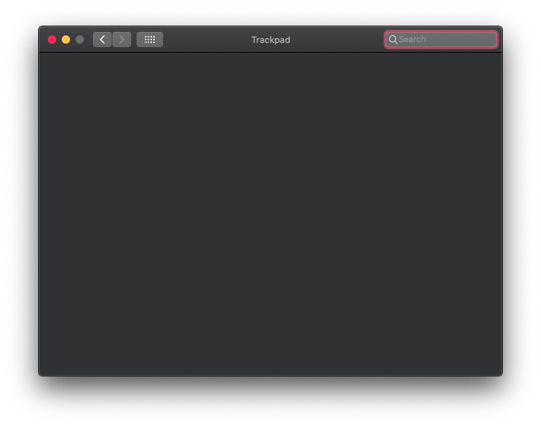

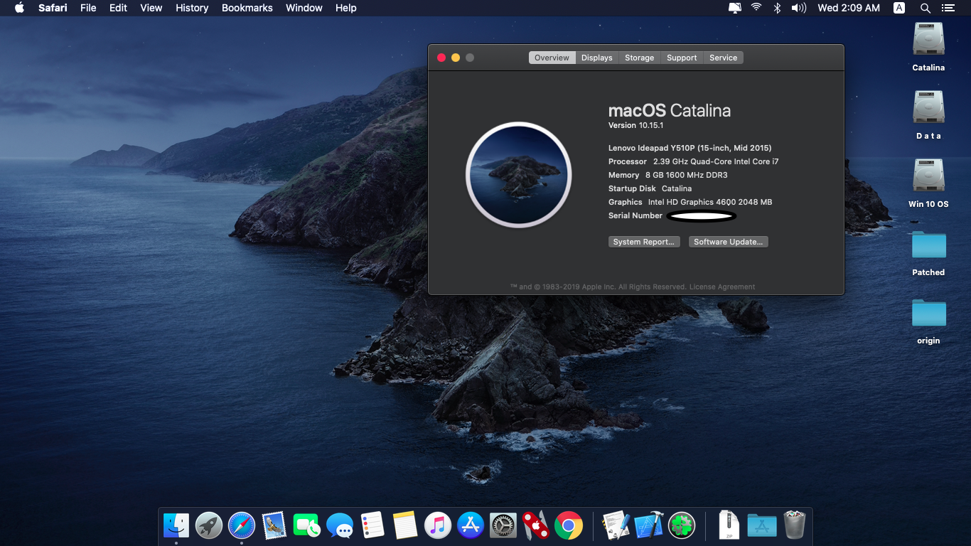

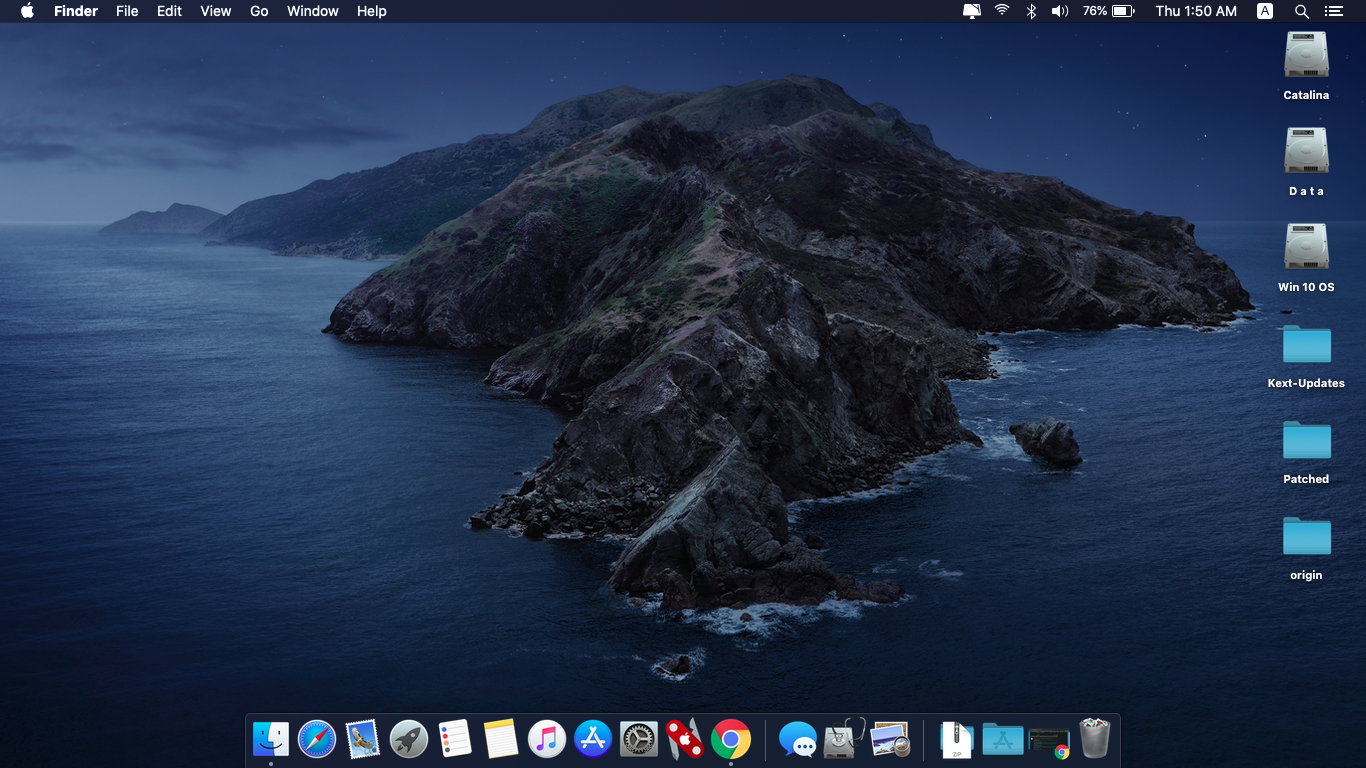

Allordcs Posted November 5, 2019 Share Posted November 5, 2019 (edited) I installed macOS Catalina 10.15.1 and everything works like a charm except the battery and the touchpad , if anyone have an idea to make them work I will be grateful . Edited November 5, 2019 by Allordcs Link to comment https://www.insanelymac.com/forum/topic/303276-guide-for-installing-os-x-on-lenovo-ideapad-y510p/page/57/#findComment-2696209 Share on other sites More sharing options...
hellrokr Posted November 6, 2019 Share Posted November 6, 2019 22 hours ago, Allordcs said: I installed macOS Catalina 10.15.1 and everything works like a charm except the battery and the touchpad , if anyone have an idea to make them work I will be grateful . For battery, you have to patch your DSDT. For touchpad, first of all check which touchpad you have. If its ELAN, https://osxlatitude.com/forums/topic/1948-elan-focaltech-and-synaptics-smart-touchpad-driver-mac-os-x Or else use Voodoo https://github.com/acidanthera/VoodooPS2 1 Link to comment https://www.insanelymac.com/forum/topic/303276-guide-for-installing-os-x-on-lenovo-ideapad-y510p/page/57/#findComment-2696300 Share on other sites More sharing options...
Allordcs Posted November 6, 2019 Share Posted November 6, 2019 2 hours ago, hellrokr said: For battery, you have to patch your DSDT. For touchpad, first of all check which touchpad you have. If its ELAN, https://osxlatitude.com/forums/topic/1948-elan-focaltech-and-synaptics-smart-touchpad-driver-mac-os-x Or else use Voodoo https://github.com/acidanthera/VoodooPS2 Thank you dud ! after searching I found that the only compatible version from battery kext is 1.70.2 , now the battery works ! but for the touchpad is works partially ... Link to comment https://www.insanelymac.com/forum/topic/303276-guide-for-installing-os-x-on-lenovo-ideapad-y510p/page/57/#findComment-2696314 Share on other sites More sharing options...
hellrokr Posted November 6, 2019 Share Posted November 6, 2019 24 minutes ago, Allordcs said: Thank you dud ! after searching I found that the only compatible version from battery kext is 1.70.2 , now the battery works ! but for the touchpad is works partially ... That's great. So touchpad is usually easy. Especially our laptop has PS2 touchpad. I think you have Synaptic touchpad. Mine was ELAN so, the link that I shared earlier worked for me. I have a HP laptop with Synaptic. I used this Voodoo rather than rehabman's https://github.com/acidanthera/VoodooPS2/releases Check this out. It has inbuilt gestures and everything and works out of the box. 1 Link to comment https://www.insanelymac.com/forum/topic/303276-guide-for-installing-os-x-on-lenovo-ideapad-y510p/page/57/#findComment-2696321 Share on other sites More sharing options...

Allordcs Posted November 7, 2019 Share Posted November 7, 2019 8 hours ago, hellrokr said: That's great. So touchpad is usually easy. Especially our laptop has PS2 touchpad. I think you have Synaptic touchpad. Mine was ELAN so, the link that I shared earlier worked for me. I have a HP laptop with Synaptic. I used this Voodoo rather than rehabman's https://github.com/acidanthera/VoodooPS2/releases Check this out. It has inbuilt gestures and everything and works out of the box. 8 hours ago, hellrokr said: If this doesn't work, let me know. I'll upload what I'm using on my HP. That should work. yes , the touchpad that I have is Synaptic , and after testing the voodoop2 doesnt work probably , and appleps2smarttouchpad works partially as I said . Okay upload it and let me test it if it works Link to comment https://www.insanelymac.com/forum/topic/303276-guide-for-installing-os-x-on-lenovo-ideapad-y510p/page/57/#findComment-2696364 Share on other sites More sharing options...

hellrokr Posted November 8, 2019 Share Posted November 8, 2019 54 minutes ago, Allordcs said: Thank you my friend but are you test it on catalina ? because its the same that I tested it before ! yes, My Hp is at catalina and it works perfectly. Honestly, it was the easiest one to setup. All gestures and everything worked just by placing this kext in Clover. Is your trackpad detected in Preferences? Or it says no trackpad found but it still works. I had the above-described issue earlier. What fixed for me was to generate the DSDT again and applying the patches again. I had messed up earlier something which somehow was affecting the trackpad. If nothing works, remove all your DSDT patches and try booting. Then check if trackpad works. If it does then start applying patches one by one. Link to comment https://www.insanelymac.com/forum/topic/303276-guide-for-installing-os-x-on-lenovo-ideapad-y510p/page/57/#findComment-2696515 Share on other sites More sharing options...

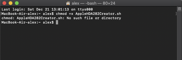

part1zan-00 Posted December 21, 2019 Share Posted December 21, 2019 Good afternoon. Tell me, I want to fix the sound with AppleHDA. Downloaded file AppleHDA282Creator.sh in the Download folder, and also copied it to the Hard Drive. I go to Terminal and write-chmod +x AppleHDA282Creator.sh . in response, I get the error-chmod: AppleHDA282Creator.sh: No such file or directory. What am I doing wrong? Thanks. Link to comment https://www.insanelymac.com/forum/topic/303276-guide-for-installing-os-x-on-lenovo-ideapad-y510p/page/57/#findComment-2701355 Share on other sites More sharing options...

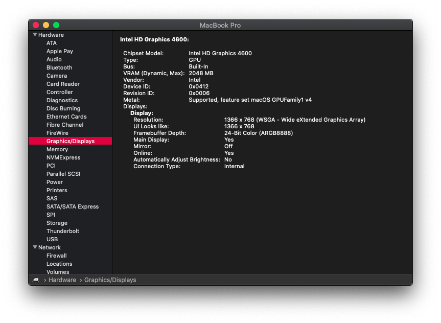

Allordcs Posted May 10, 2020 Share Posted May 10, 2020 (edited) On 5/6/2020 at 3:11 AM, sahib1989 said: can you please share your efi folder for catalina and all the kexts you used, thanks in advance anyways dude, the important files have been attached. Note: All you need to do is select the proper config.plist < based on screen resolution > then convert all dsl files to aml and put them in this path EFI/Clover/ACPI/patched. that's it. Important_files.zip Edited May 10, 2020 by Allordcs Link to comment https://www.insanelymac.com/forum/topic/303276-guide-for-installing-os-x-on-lenovo-ideapad-y510p/page/57/#findComment-2721822 Share on other sites More sharing options...
Allordcs Posted May 29, 2020 Share Posted May 29, 2020 After testing macOS Catalina 10.15.5 it works fine without problems. Link to comment https://www.insanelymac.com/forum/topic/303276-guide-for-installing-os-x-on-lenovo-ideapad-y510p/page/57/#findComment-2724192 Share on other sites More sharing options...
