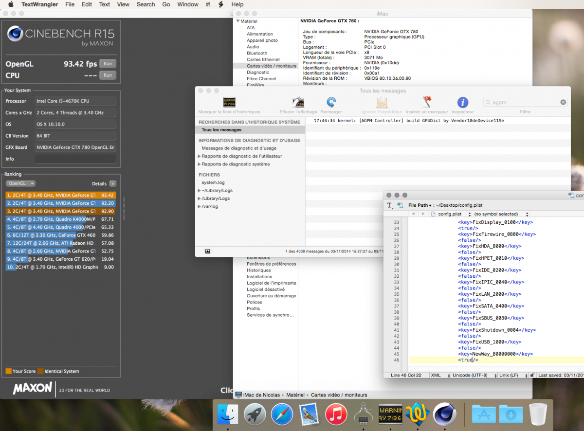

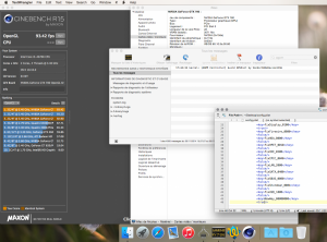

The Real Deal Posted November 1, 2014 Share Posted November 1, 2014 My GTX 780 (EVGA SuperClocked rev. A1 chip) have at least two P-States : 324 to 1123 reported in HWMonitor ; despite AGPM unknown bla in console. AGPM kext is loaded though. I need to do a Cinebench ; will report ASAP. (iMac14,1 + Web Drivers + 10.9.5) PS : 119d is 775M 119e is 780M https://pci-ids.ucw.cz/read/PC/10de/119e EDIT : OK, so i made a run of Cinebench : 90 FPS ; the card have a lot of P-States but does not fully boost (Kepler boost). In Luxmark the card hit the kepler boost for all the duration of the run. UPDATED : clean method Here is what i have done for my GTX 780 ; update proof method : Rig set as iMac14,2 with matching (SMBios) Mac-xxxxxxxxx number in AGPM ; in the related section of AGPM, i picked 10de 119e (GTX 780M) to inject via Clover. Then in config plist : <key>FixDisplay_0100</key> <true/> <key>NewWay_80000000</key> <true/> <key>NVidia</key> <string>0x119e10de</string> (FakeID) Leads to : 03/11/2014 17:44:34,000 kernel[0]: [AGPM Controller] build GPUDict by Vendor10deDevice119e 3 Link to comment https://www.insanelymac.com/forum/topic/301787-nvidia-gtx-780-agpm-patch-in-yosemite-1010/#findComment-2079586 Share on other sites More sharing options...
edeseven Posted November 4, 2014 Author Share Posted November 4, 2014 Thanks @The Real Deal I did your FakeID method in clover - can confirm that this works!! I did not use the FixDisplay and NewWay fix in clover, do we really need to use these as well? However will this faked injection method change anything else? I mean in terms on the nvidia drivers etc? And do you know how can we check the p-states for our graphic cards? Link to comment https://www.insanelymac.com/forum/topic/301787-nvidia-gtx-780-agpm-patch-in-yosemite-1010/#findComment-2081037 Share on other sites More sharing options...
The Real Deal Posted November 4, 2014 Share Posted November 4, 2014 np, FixDisplay_0100This is a very functional patch for video devices. Recommended even if you don't want to inject properties to the device. When this bit is set other settings like FakeID will be applied as well. Old way: this patch will affect all video cards, included embedded Intel GFX.New way: Intel will be patched separately. For the power management, beyond HWMonitor, you can check in ioreg Link to comment https://www.insanelymac.com/forum/topic/301787-nvidia-gtx-780-agpm-patch-in-yosemite-1010/#findComment-2081060 Share on other sites More sharing options...

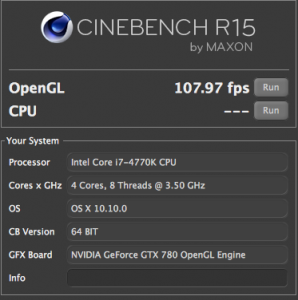

The Real Deal Posted December 5, 2014 Share Posted December 5, 2014 OC'ed but still not full boost as it should be (Kepler Boost) Link to comment https://www.insanelymac.com/forum/topic/301787-nvidia-gtx-780-agpm-patch-in-yosemite-1010/#findComment-2092301 Share on other sites More sharing options...
edeseven Posted December 5, 2014 Author Share Posted December 5, 2014 Looks good!! I don't think my kepler boost is working properly too, but I'm not sure what's the best way to figure this out Are you still using fakeid injection to get AGPM working? Link to comment https://www.insanelymac.com/forum/topic/301787-nvidia-gtx-780-agpm-patch-in-yosemite-1010/#findComment-2092446 Share on other sites More sharing options...
Baja-king Posted December 8, 2014 Share Posted December 8, 2014 My GTX 780 (EVGA SuperClocked rev. A1 chip) have at least two P-States : 324 to 1123 reported in HWMonitor ; despite AGPM unknown bla in console. AGPM kext is loaded though. I need to do a Cinebench ; will report ASAP. (iMac14,1 + Web Drivers + 10.9.5) PS : 119d is 775M 119e is 780M https://pci-ids.ucw.cz/read/PC/10de/119e EDIT : OK, so i made a run of Cinebench : 90 FPS ; the card have a lot of P-States but does not fully boost (Kepler boost). In Luxmark the card hit the kepler boost for all the duration of the run. UPDATED : clean method Here is what i have done for my GTX 780 ; update proof method : Rig set as iMac14,2 with matching (SMBios) Mac-xxxxxxxxx number in AGPM ; in the related section of AGPM, i picked 10de 119e (GTX 780M) to inject via Clover. Then in config plist : <key>FixDisplay_0100</key> <true/> <key>NewWay_80000000</key> <true/> <key>NVidia</key> <string>0x119e10de</string> (FakeID) Leads to : 03/11/2014 17:44:34,000 kernel[0]: [AGPM Controller] build GPUDict by Vendor10deDevice119e Hi Real Deal, I have the same problem but I'm new to clover: running 10.10.1 with clover on a Z77x-UD5H with 2 x 670 GTX's and i'm getting kernel panic after a deep sleep. can you explain how to do the above in simpler terms please Thanks in advance Link to comment https://www.insanelymac.com/forum/topic/301787-nvidia-gtx-780-agpm-patch-in-yosemite-1010/#findComment-2093335 Share on other sites More sharing options...
The Real Deal Posted December 13, 2014 Share Posted December 13, 2014 Looks good!! I don't think my kepler boost is working properly too, but I'm not sure what's the best way to figure this out Are you still using fakeid injection to get AGPM working? Yep still fake ID NVIDIA GeForce GTX 780 Ti : Jeu de composants : NVIDIA GeForce GTX 780 Ti Type : Processeur graphique (GPU) Bus : PCIe Logement : PCI Slot 0 Longueur de la voie PCIe : x8 VRAM (totale) : 3071 Mo Fournisseur : NVIDIA (0x10de) Identifiant du périphérique : 0x119e Identifiant de révision : 0x00a1 Révision de la ROM : VBIOS 80.80.34.00.80 Moniteurs : Hi Real Deal, I have the same problem but I'm new to clover: running 10.10.1 with clover on a Z77x-UD5H with 2 x 670 GTX's and i'm getting kernel panic after a deep sleep. can you explain how to do the above in simpler terms please Thanks in advance Which problem? 6xx is not same architecture as Kepler Link to comment https://www.insanelymac.com/forum/topic/301787-nvidia-gtx-780-agpm-patch-in-yosemite-1010/#findComment-2094787 Share on other sites More sharing options...
