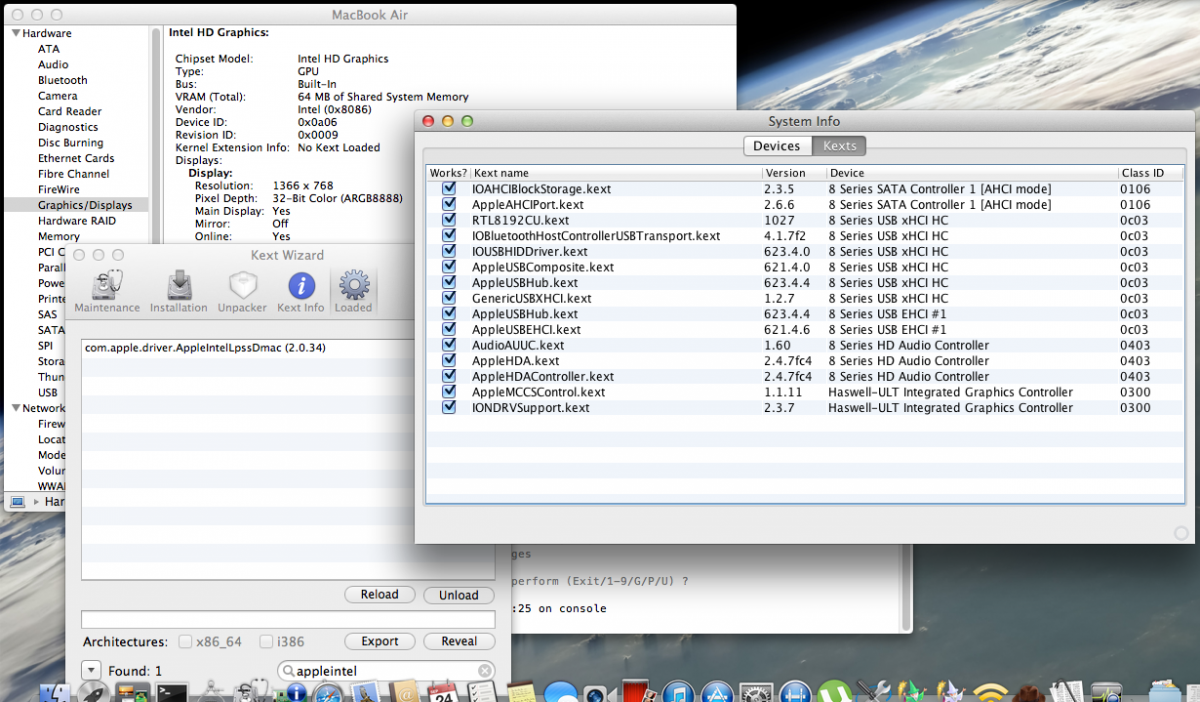

LeonTravowski Posted September 24, 2014 Share Posted September 24, 2014 I'm currently running 10.8.5 on an Acer C720 Chromebook (Haswell Celeron 2995U). Certainly, there is a long way to go, however I've had some success with patching AppleHDA to enable sound, and I am using a DWA-131 USB wi-fi adapter...so I'm borderlining on having a functional system. Regarding graphics, the Niresh 10.8.5 install allowed for basic support. No acceleration, No Kext loaded & showed up as Intel HD Graphics 64Mb in System Profiler. Fine for basic tasks. Despite what I'd read, I've managed to get 10.8.5 to load AppleIntelFrameBufferAzul.kext & AppleIntelHD5000.kext through a DSDT patch. I set the platform ID to the MacbookAir (0a260005) & the device ID to the HD5000 (0a26). In System Profiler, it Shows up as Intel HD Graphics VRAM (Total) 1024Mb. The graphics is still "glitchy", but in checking the Chess App (before vs. after), it seems like some acceleration is taking place. Also, in display->system preferences, it allows me to change the screen resolution (No brightness slider however). So, initially encouraging. I'm not by any means a guru in this department so I'm hoping some other folks can comment. Everywhere I've read "no way no how" regarding the HD Graphics (Haswell GT1) (0a26), but this small success seems to suggest maybe there is some hope? My DSDT patch is below. Also, uploading some screenshots at different stages of DSDT patching showing the kext's are loaded. My initial thoughts is that if I can get the VRAM to load only 256Mb, and perhaps tweak the HD5000.kext, maybe it will behave better? I tried using the appleintelframebufferazul.sh script at...; https://github.com/Piker-Alpha/AppleIntelFramebufferAzul.sh ...but it doesn't seem to have any affect on changing the VRAM size. Any comments or suggestions would be greatly appreciated. into method label _DSM parent_adr 0x00020000 remove_entry; into device name_adr 0x00020000 insert begin Method (_DSM, 4, NotSerialized)\n {\n If (LEqual (Arg2, Zero)) { Return (Buffer() { 0x03 } ) }\n Return (Package()\n {\n "device-id", Buffer() { 0x26, 0x0a, 0x00, 0x00 },\n "AAPL,ig-platform-id", Buffer() { 0x05, 0x00, 0x26, 0x0a },\n "hda-gfx", Buffer() { "onboard-1" },\n })\n }\n end; 1 Link to comment https://www.insanelymac.com/forum/topic/301082-acer-c720-chromebook-intel-hd-graphics-haswell-gt1-0a06/ Share on other sites More sharing options...

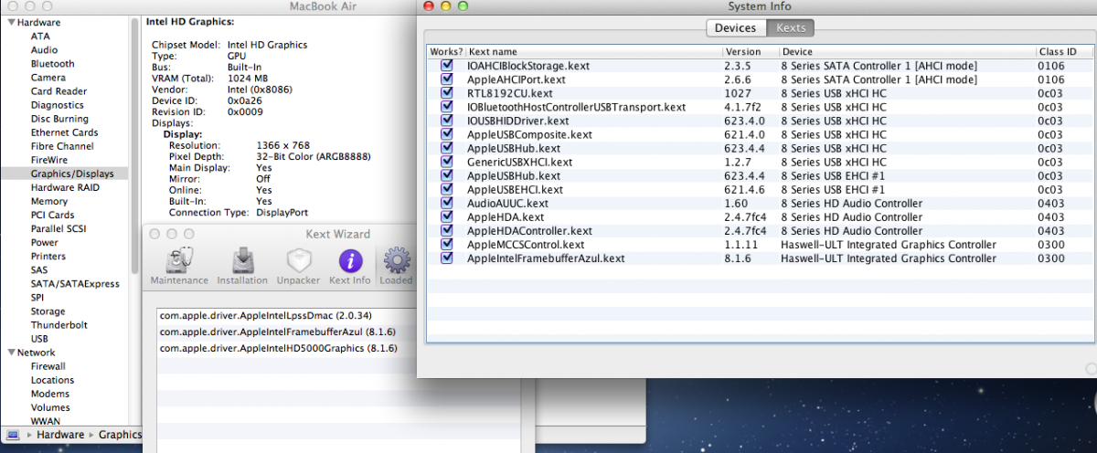

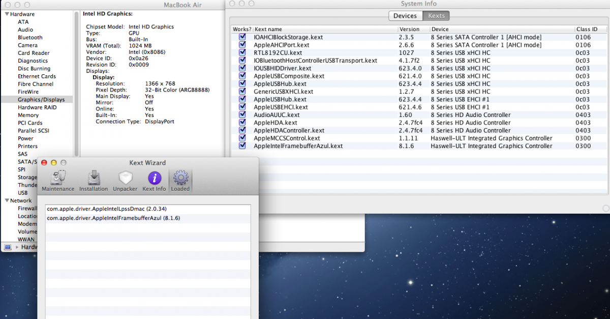

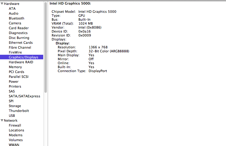

LeonTravowski Posted December 28, 2014 Author Share Posted December 28, 2014 Sorry for the late response. Have you tried injecting the gfx card to be recognized as HD4400 (0a16)? Can you do a screengrab of the graphics panel in System Information? I was actually able to boot Yosemite on the Celeron chrome book, but graphics performance was intolerable so now I'm back on 10.8.5. First of all: thumbs up for what you've accomplished so far... It's encouraging to see someone not surrendering to, as you put it, "no way no how"... I'm trying to follow your steps, however, although an old wolf in computing (30 years or so), just a new born lamb in hackintosh (30 days or so :'( )... I've built a hackintosh with a Pentium G3220, ignorant that it would be so difficult (hope not impossible) to configure the grafx... no need for fancy things... In fact, only need it 'cause I want to develop apps for iOS... But the flickering video is annoying, specially in Safari... Any ideas how to adapt your procedure to a normal desktop with such processor, and a UEFI hd booting clover? The whole specs are: MB: GA-B85M-DS3H CPU: Intel G3220 HD: 1TB WD, UEFI, already installed and running Win7, Fedora Linux and OSX Mavericks 10.9.5 RAM: 8GB OSX has LAN configured. No audio (don't need it, but wouldn't mind having it) Best Regards. Alfredo Meraz Link to comment https://www.insanelymac.com/forum/topic/301082-acer-c720-chromebook-intel-hd-graphics-haswell-gt1-0a06/#findComment-2098342 Share on other sites More sharing options...
