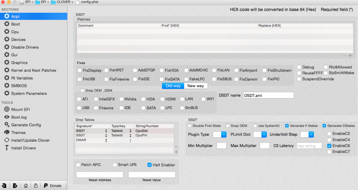

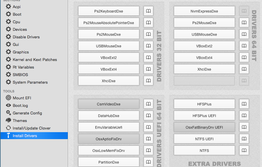

Pieroman Posted August 16, 2014 Share Posted August 16, 2014 I managed to get Yosemite install and work pretty well, using Clover from this post: http://www.insanelymac.com/forum/topic/299865-clover-v2k-r2780-special-edition-yosemite-beta/ To get clover to work on this board, I needed to install OSxAptioFixDrv-64, and in the clover config.plist, I removed all the DSDT fixes. In order to get a nice resolution in clover, I also installed CsmVideoDxe-64, and activated patchVbios in config.plist. I then added RealtekRTL8111.kext in the appropriate clover kext folder (the clover version from the link installs fakeSMC) for the network... and voilà (I didn't install anything yet for USB 3.0, TRIM, or sound since I use an external interface). But... my board was updated to the U1L UEFI BIOS, which allowed me to install UEFI Clover. This is honestly something you could try, it is possible to keep Mavericks working around the update. The main thing that needs to be done is removing the DSDT. Link to comment https://www.insanelymac.com/forum/topic/300208-appealing-to-anyone-with-a-successful-ga-z68-ud3h-b3-yosemite/#findComment-2052290 Share on other sites More sharing options...

coolpal Posted August 20, 2014 Share Posted August 20, 2014 I have Z68X-UD3H-B3 with ATI 6870 card and i5 2500K, running the UEFI bios. I was able to install and run Yosemite public beta with no issues... everything works including audio, networking, iMessages, iCoud. Here's what I did. 1. Used the "Clover_v2k_r2780_Special Edition_Yosemite Beta" by Chris1111 to prepare the Yosemite USB and install 2. Used the same tool again to install Clover to the Yosemite install drive 3. Installed the networking, appleHda and Hdaenabler kexts pulled from my working Maverics install using kext wizard 4. Added kext-dev-mode=1 boot flag to the apple boot plist (/Library/Preferences/SystemConfiguration/com.apple.Boot.plist). If iCloud or iMessages didn't work, make sure the ethernet adapter is the first networking device (en1 ?) Link to comment https://www.insanelymac.com/forum/topic/300208-appealing-to-anyone-with-a-successful-ga-z68-ud3h-b3-yosemite/#findComment-2053633 Share on other sites More sharing options...

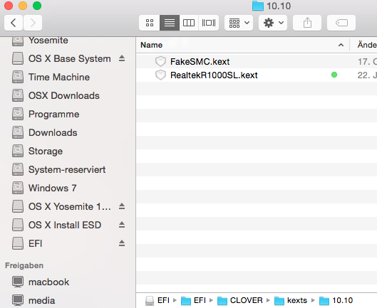

Alsterwasser Posted October 18, 2014 Share Posted October 18, 2014 Thank you clipper! I updated to the UEFI Bios, using Clover r2953 with the sugested options from Pieroman in post #7 and a FakeSMC. Yosemite is running very well now! Link to comment https://www.insanelymac.com/forum/topic/300208-appealing-to-anyone-with-a-successful-ga-z68-ud3h-b3-yosemite/#findComment-2071122 Share on other sites More sharing options...

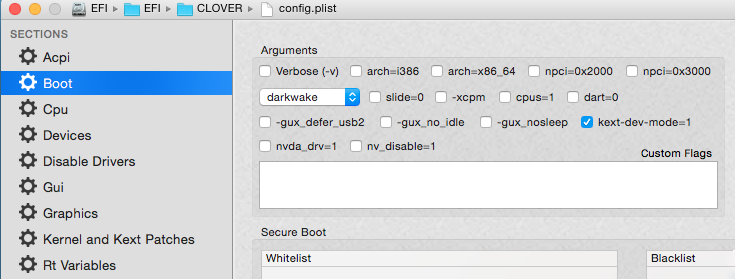

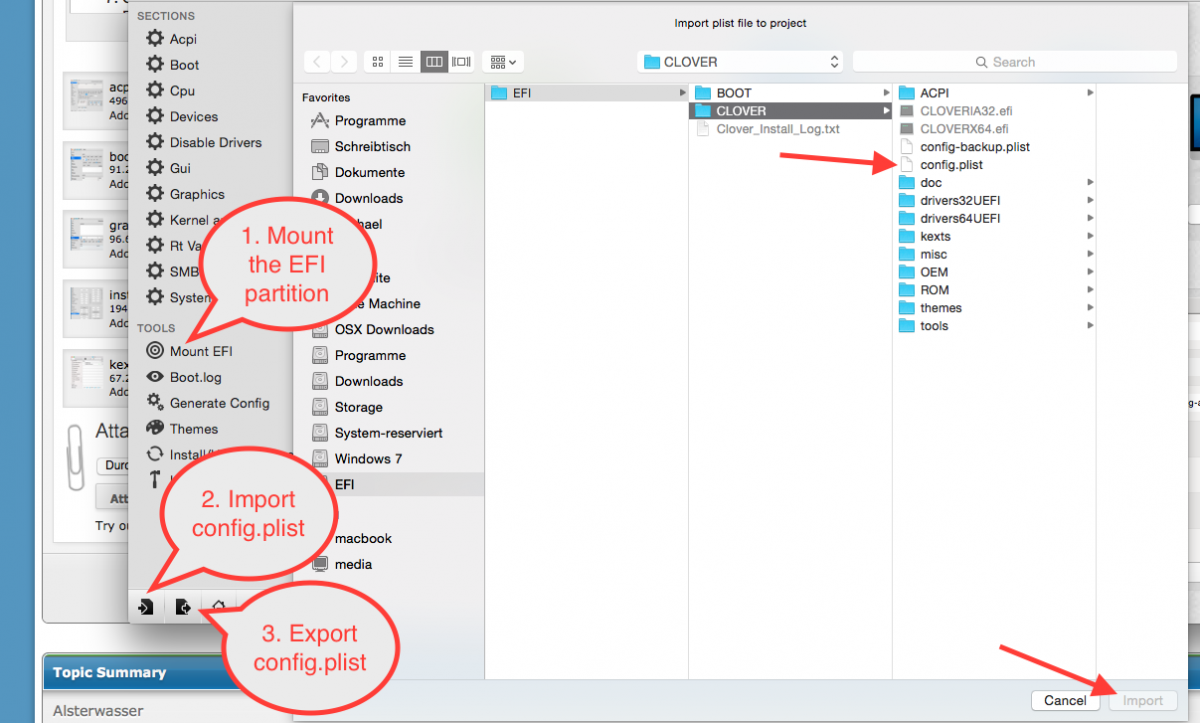

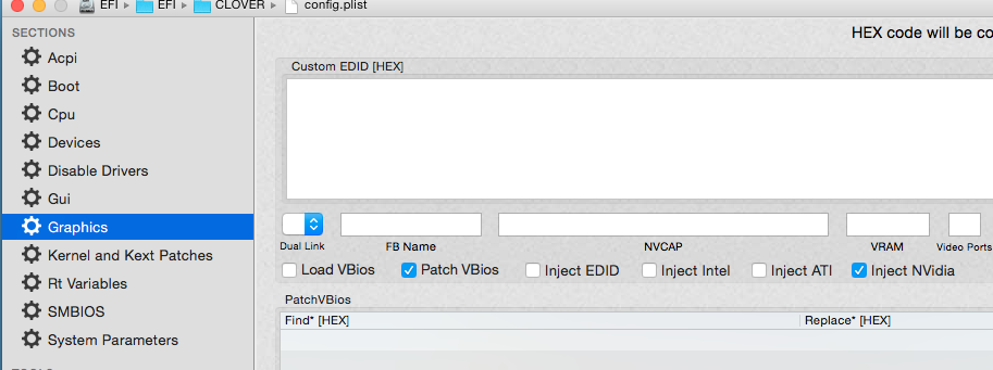

Alsterwasser Posted November 3, 2014 Share Posted November 3, 2014 Okay, i try to summarise the steps i did on my system. Please keep in mind, depending on your system, some steps might be different. Creating the installer FYI: First we need to create our install medium. I don't know why, but using the createinstallmedia tool from apple didn't worked for me. So i had to do it the old way.In order to create a bootable flash drive, you will need: - Minimum 8GB USB drive formatted with Mac OS X Extended, Journaled partition. - OS X Yosemite Installation.app downloaded from the Mac App Store. Use Disk Utility to format your USB flash drive as a Mac OS Extended (Journaled) using a GUID partition table. Find the file named InstallESD.dmg within the Yosemite installer app by right-clicking (or Control+click) and choose Show Package Contents. Go to Contents - SharedSupport and double click and mount this disk image. (The dmg file might be hidden) You need to mount another file within InstallESD.dmg, and this file is named *BaseSystem.dmg”. Make sure your USB flash drive is mounted, and in Disk Utility, select BaseSystem.dmg (not OS X Base System) in Disk Utility’s sidebar, and then click the Restore tab in the right pane. Drag the USB flash drive name into the Destination box in the right pane. Then click the Restore button and a bootable OS X Yosemite base system will be created. If prompted, enter an Administrator user name and password. Open the destination USB flash drive and navigate to the System folder, and then open the Installation folder. You’ll see an alias named Packages. Delete that alias. Open the mounted OS X Install ESD volume, and you’ll see a folder named Packages. Drag that folder into the Installation folder on your destination drive (where the alias was). The folder is about 5GB in size, so the copy will take a while, especially if you’re copying to a slow flash drive.Source for this HowTo. One last step, i had to do, was new for me. Open up the OS X Install ESD volume and copy over the BaseSystem.dmg and the BaseSystem.chunklist to the root of your installer. Installing a boot loader to the installer FYI: I used clover in revision 2953 in my case. If there is a newer version out there, you might want to use that one. Double click the Install Clover 2k r2953.pkg and click continue Important: Do NOT click Install as it points to your current macintosh hd. Instead click on Change install location and choose your usb flash drive. Now click Customize and choose the following settings- Install for UEFI booting only - Install Clover in the ESP Under Drivers64UEFI choose - CsmVideoDxe-64 - OsxAptioFixDrv-64 Now click Install Copy over FakeSMC.kext I had to due two last steps to get the Yosemite installer to boot. I needed to copy over a FakeSMC to the EFI partition of my usb installer and had to configure the Clover config file. Otherwise i was not able to boot from it. If it is not already done, we need to mount the clover efi partition from our usb drive. To keep things simple, i downloaded the Clover Configurator tool. Click on Mount EFI - Mount EFI partition and choose your usb drive on the list of drives. Don't close the tool as we will need it in a second. See config.png Open the mounted partition within finder and navigate to EFI - CLOVER - kexts Within this folder, you need to create a new folder and name it 10.10 Open up the folder and copy your FakeSMC.kext into it. Optional: At this step i also copied the RealtekR1000sl.kext to get my ethernet to work. See kexts.png Go back to the Clover Configurator and load in the config file from the efi partition Under Acpi uncheck all Fixes acpi.png Under Boot check kext-dev-mode=1 boot.png Under Graphics configure your graphics card For example: I have a nVidia 560 so i unchecked "Inject Intel" and instead checked "Inject NVidia" and "Patch VBios" Those settings depend on your graphics card and might be different! graphics.png Save the configuration. With these steps i finally was able to boot from my usb drive and install yosemite on my system. After the installation is complete, use your usb drive to boot into your new yosemite installation. Redo the steps to install clover onto your hard drive and configure it with Clover Configurator. Once again, this are the steps which worked for me and my system. Things could be different for your personal system. If some steps are unclear, feel free to ask and i try my best to explain it. So there is no way to get Yosemite onto F12 "legacy" bios F12? I have the same mobo + i7 2600K + GeForce 560 Ti and have tried several boot loader methods and none work. Always got a black screen. Those of you that updated to the UEFI bios, what exactly are the benefits over legacy bios F12? Acutally i think that there aren't any benefits of the UEFI bios instead the legacy one. But in my case, i didn't find any method getting the installer (regardless if using clover or chameleon) to boot with the F12 bios. Link to comment https://www.insanelymac.com/forum/topic/300208-appealing-to-anyone-with-a-successful-ga-z68-ud3h-b3-yosemite/#findComment-2080362 Share on other sites More sharing options...
