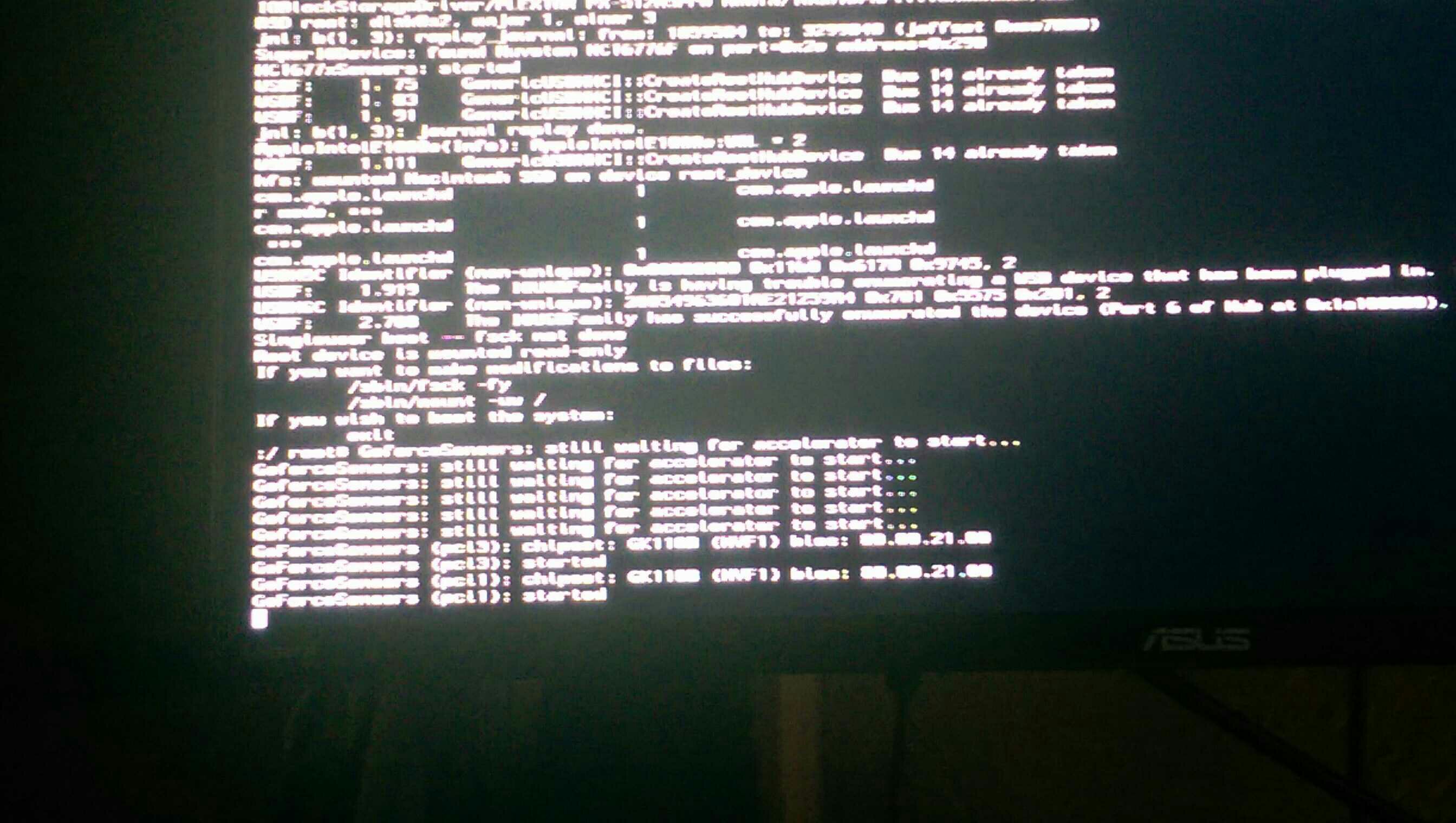

garnerlogan65 Posted July 26, 2014 Share Posted July 26, 2014 Hey guys, I recently made a Yosemite installer using createinstallmedia, and using Clover r2696 as UEFI bootloader andwhen I enter the appropriate flags, and try to boot, it will stop for a second and then let me choose the boot device again, so essentially it's not doing anything. I have a nearly perfect Mavericks install (other than multi-monitor issues) and I don't understand why its not working. Any ideas? Specs: i7 4960X GTX 780 64gb ram Asus Rampage IV Extreme Link to comment https://www.insanelymac.com/forum/topic/299813-cant-install-yosemite-with-createinstallmedia/ Share on other sites More sharing options...

garnerlogan65 Posted July 26, 2014 Author Share Posted July 26, 2014 Got it to partially boot Stuck on GeForceSensors, any ideas? Link to comment https://www.insanelymac.com/forum/topic/299813-cant-install-yosemite-with-createinstallmedia/#findComment-2044870 Share on other sites More sharing options...
crusher Posted July 26, 2014 Share Posted July 26, 2014 Wait several second or minut i have a same problem.Which boot loader you use? Link to comment https://www.insanelymac.com/forum/topic/299813-cant-install-yosemite-with-createinstallmedia/#findComment-2044872 Share on other sites More sharing options...

chris1111 Posted July 26, 2014 Share Posted July 26, 2014 I see your pics , just try to Remove the plugin on your FakeSMC.kext Link to comment https://www.insanelymac.com/forum/topic/299813-cant-install-yosemite-with-createinstallmedia/#findComment-2044900 Share on other sites More sharing options...
garnerlogan65 Posted July 26, 2014 Author Share Posted July 26, 2014 Chris1111, what plugin? Link to comment https://www.insanelymac.com/forum/topic/299813-cant-install-yosemite-with-createinstallmedia/#findComment-2044902 Share on other sites More sharing options...
chris1111 Posted July 26, 2014 Share Posted July 26, 2014 Chris1111, what plugin? Right clic to the FakeSMC.kext //Show Packages contents / Contents / Plugin Open folder plugin delete all plugin and retry to boot Link to comment https://www.insanelymac.com/forum/topic/299813-cant-install-yosemite-with-createinstallmedia/#findComment-2044903 Share on other sites More sharing options...

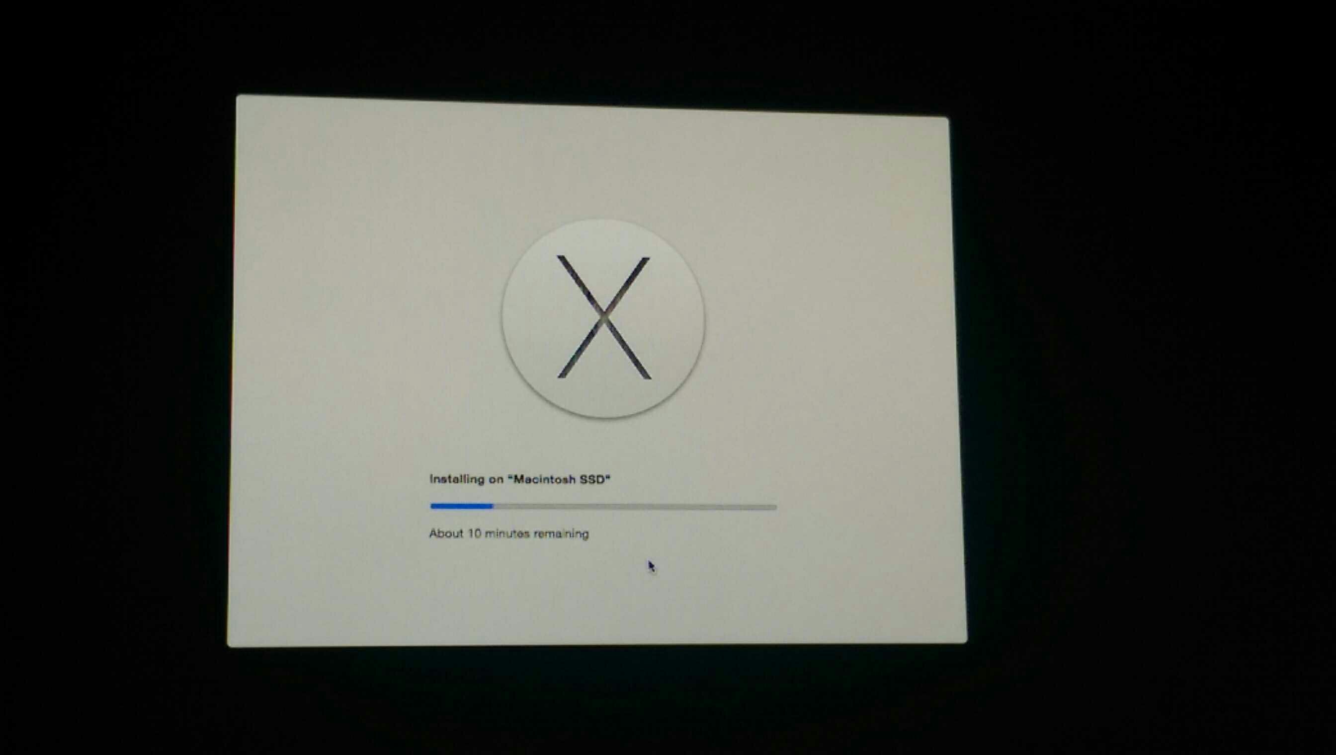

garnerlogan65 Posted July 26, 2014 Author Share Posted July 26, 2014 Ok, waiting for install to finish Link to comment https://www.insanelymac.com/forum/topic/299813-cant-install-yosemite-with-createinstallmedia/#findComment-2044937 Share on other sites More sharing options...
chris1111 Posted July 26, 2014 Share Posted July 26, 2014 Ok, waiting for install to finish1406418402833.jpg Please make your specs on your signature for people helping you to the post installation Link to comment https://www.insanelymac.com/forum/topic/299813-cant-install-yosemite-with-createinstallmedia/#findComment-2044938 Share on other sites More sharing options...
