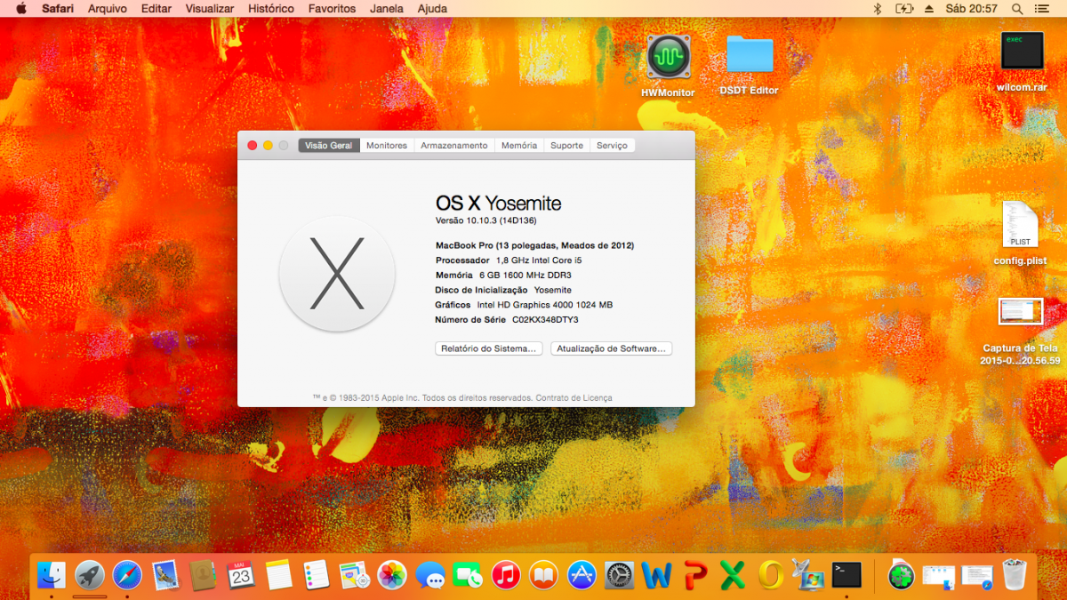

guga-lipe Posted May 23, 2015 Share Posted May 23, 2015 Atualizei pro 10.10.3, agora ja to com aceleraçao grafica, gerenciamento de energia e medidor de bateria, mas so consigo tudo isso se eu apagar a pasta extra... Nao to entendendo nada!! Axo q o problema ta no DSDT... Mas pq antes ele funcionava? Link to comment https://www.insanelymac.com/forum/topic/299772-guia-yosemite-public-beta-no-dell-inspiron-14-3421/page/7/#findComment-2138041 Share on other sites More sharing options...

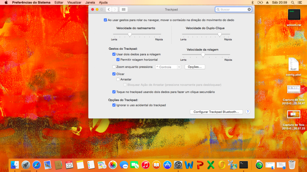

guga-lipe Posted May 23, 2015 Share Posted May 23, 2015 Consegui bootar com o clover em uefi(sem usar dsdt), to com aceleraçao grafica, usb 2.0 e 3.0, webcam, gerenciamento de energia e bateria, porem to sem o touchpad( ele é reconhecido como mouse) e sem audio Link to comment https://www.insanelymac.com/forum/topic/299772-guia-yosemite-public-beta-no-dell-inspiron-14-3421/page/7/#findComment-2138177 Share on other sites More sharing options...
Allan Posted May 23, 2015 Share Posted May 23, 2015 Qual é o controlador do seu Trackpad, e qual é seu codec de audio? 1 Link to comment https://www.insanelymac.com/forum/topic/299772-guia-yosemite-public-beta-no-dell-inspiron-14-3421/page/7/#findComment-2138188 Share on other sites More sharing options...
guga-lipe Posted May 23, 2015 Share Posted May 23, 2015 Trackpad: synaptics, audio alc3221 Eles funcionavam com o chamaleon e com dsdt, mas com o clover nao to podendo carregar o dsdt Link to comment https://www.insanelymac.com/forum/topic/299772-guia-yosemite-public-beta-no-dell-inspiron-14-3421/page/7/#findComment-2138189 Share on other sites More sharing options...
Allan Posted May 23, 2015 Share Posted May 23, 2015 Você tinha aplicado patch para Trackpad e Audio no seu DSDT? 1 Link to comment https://www.insanelymac.com/forum/topic/299772-guia-yosemite-public-beta-no-dell-inspiron-14-3421/page/7/#findComment-2138191 Share on other sites More sharing options...
guga-lipe Posted May 23, 2015 Share Posted May 23, 2015 Eu tinha baixado a dsdt aqui nesse post, foi oq mendietinha postou Consegui habilitar o trackpad hehehe, so falta o audio Link to comment https://www.insanelymac.com/forum/topic/299772-guia-yosemite-public-beta-no-dell-inspiron-14-3421/page/7/#findComment-2138192 Share on other sites More sharing options...

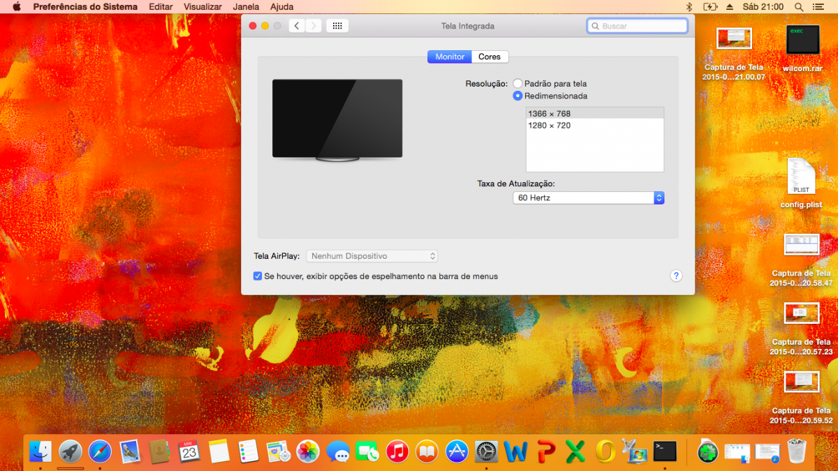

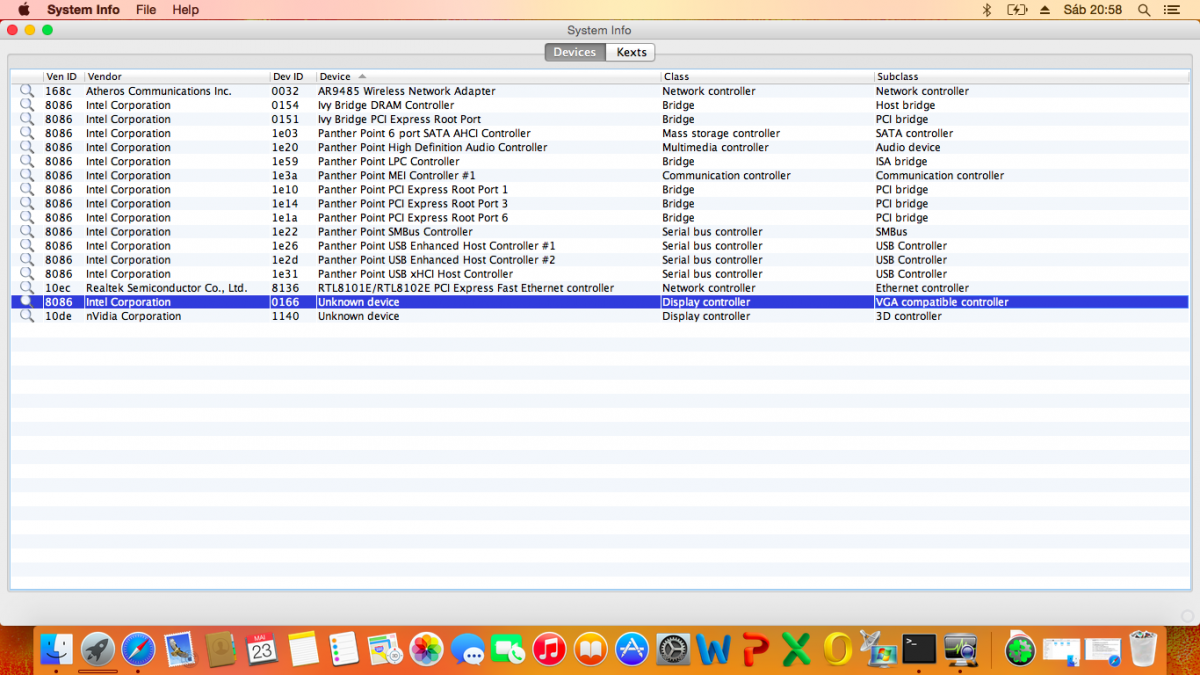

guga-lipe Posted May 24, 2015 Share Posted May 24, 2015 to com aceleração grafica, mas o SystemInfo não reconhece minha placa gráfica... Link to comment https://www.insanelymac.com/forum/topic/299772-guia-yosemite-public-beta-no-dell-inspiron-14-3421/page/7/#findComment-2138200 Share on other sites More sharing options...
Allan Posted May 24, 2015 Share Posted May 24, 2015 O SystemInfo já é antigo, e é sujeito a falhas como essa, por isso recomendamos o DPCIManager. Não precisa se preocupar com isso, o importante é ter aceleração e reconhecimento do video pelo OS X. Já instalou a VoodooHDA, se sim reparou as permissões do OS X? Agora com relação a duvida que me falou por PM, há um maneira mais simples do que retirar todos os patchs da DSDT. Extraia uma DSDT da sua maquina, e juntos vamos aplicando os patchs. Podemos pegar a DSDT do @mendietinha como referencia, mas não para usar em seu Hack. 1 Link to comment https://www.insanelymac.com/forum/topic/299772-guia-yosemite-public-beta-no-dell-inspiron-14-3421/page/7/#findComment-2138207 Share on other sites More sharing options...

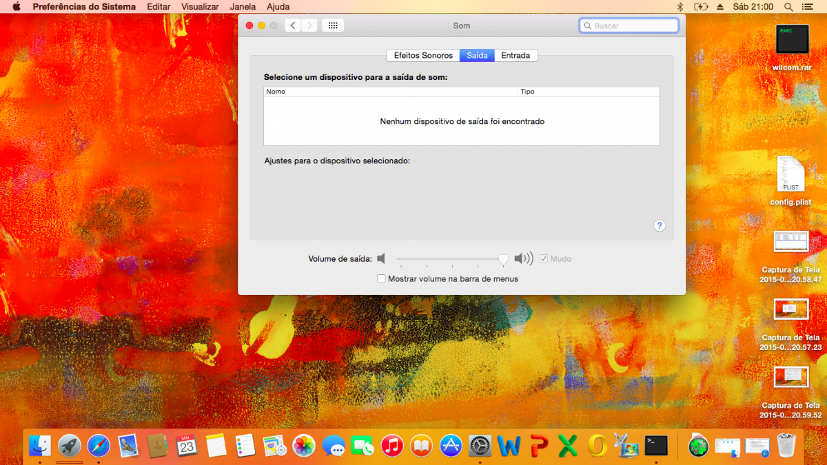

guga-lipe Posted May 24, 2015 Share Posted May 24, 2015 Com voodoohda ele funcionou no chamaleon, nunca testei no clover, mas com o voodoo o som ficava estranho as vezes e o volume ficava um pouco baixo Depois q eu instalei a applehda e a eapdfix do mendietinha, o audio ficou normal Link to comment https://www.insanelymac.com/forum/topic/299772-guia-yosemite-public-beta-no-dell-inspiron-14-3421/page/7/#findComment-2138217 Share on other sites More sharing options...
Allan Posted May 24, 2015 Share Posted May 24, 2015 Ok, pra resolver esses "chiados" no Audio é coisa simples. Mas vamos lá. Testa essa DSDT: DSDT.aml.zip EDIT: Se não der certo, tenta essa aqui: DSDT.aml.zip 1 Link to comment https://www.insanelymac.com/forum/topic/299772-guia-yosemite-public-beta-no-dell-inspiron-14-3421/page/7/#findComment-2138218 Share on other sites More sharing options...
guga-lipe Posted May 24, 2015 Share Posted May 24, 2015 Nenhuma das duas fizeram o audio funcionar, o video ficou dando aqueles glitch... Tem q editar alguma coisa no config.plist do clover? Link to comment https://www.insanelymac.com/forum/topic/299772-guia-yosemite-public-beta-no-dell-inspiron-14-3421/page/7/#findComment-2138220 Share on other sites More sharing options...
