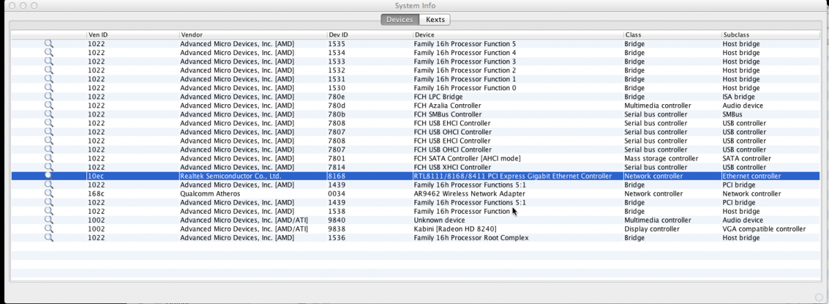

Funky frank Posted July 12, 2015 Share Posted July 12, 2015 Hello, I use OSX 10.9.4 and an Atheros 9280. It works under OSX 10.6.8, but not under OSX 10.9.4. I already set the regdomain to 3A using HCU.exe (ETSI1, europe, DE).... But still the country locale is not set under OSX 10.9.4, only under OSX 10.6.8 it is set to DE. What can I do here now? Athreros40 is loaded, and bluetooth works, too! Thanks for help! Link to comment https://www.insanelymac.com/forum/topic/299732-atheros-9k-series-rom-modding-tools-and-recovery-kit/page/2/#findComment-2152751 Share on other sites More sharing options...
highpowerwifi Posted January 7, 2016 Share Posted January 7, 2016 I have a card with AR9280 chip. Actually it's a reference design with the name AR5BHB92 on label and WN6502AH as the picture shown here https://wikidevi.com/wiki/Lite-On_WN6502AH_%28HP%29 Wikidevi said it has 2x2:2 mimo config rather than AR9285's 1x1:1, however, it seems both of them have two antenna. So I'm known the real difference. I tried the iwleeprom and it works it produced a 4096 byte file. However, it seems that it doesn't the right place for MAC address and CRC. I also tried the dump on windows, but it only produced a 3256 byte of file. However, this tool on windows can show the correct MAC address of this card. Lastly, I tried the dumpathrom tool but it seems not working on both of the two dumped files. The dumpathrom tool seems not work on this AR9280 chip based card. I attach both of the files and if it's possible to create a high power modified version to unlock all restrictions of this card? Supported devices detected: [1] 0000:01:00.0 [RW] AR928X Wireless Adapter (PCI-E) (168c:002a, 103c:3042)Select device [1-1] (or 0 to quit): 1Using device 0000:01:00.0 [RW] AR928X Wireless Adapter (PCI-E)IO driver: ath9kHW: AR9280 (PCI-E) rev 0002RF: integratedChecking NVM size...ath9k short eeprom base: 0 size: 512MAC address : 08:60:01:00:80:02Reg. domain : 168cCapabilities: 6000 Bands: HT 2G: HT20 HT40 HT 5G: HT20 HT40CRC (stored): 0000Calculating EEPROM CRC...............................CRC (eval) : 52fe This is the output of iw list $ iw listWiphy phy0 max # scan SSIDs: 4 max scan IEs length: 2257 bytes max # sched scan SSIDs: 0 max # match sets: 0 Retry short limit: 7 Retry long limit: 4 Coverage class: 0 (up to 0m) Device supports RSN-IBSS. Device supports AP-side u-APSD. Device supports T-DLS. Supported Ciphers: * WEP40 (00-0f-ac:1) * WEP104 (00-0f-ac:5) * TKIP (00-0f-ac:2) * CCMP (00-0f-ac:4) * 00-0f-ac:10 * GCMP (00-0f-ac:8) * 00-0f-ac:9 * CMAC (00-0f-ac:6) * 00-0f-ac:13 * 00-0f-ac:11 * 00-0f-ac:12 Available Antennas: TX 0x3 RX 0x3 Configured Antennas: TX 0x3 RX 0x3 Supported interface modes: * IBSS * managed * AP * AP/VLAN * WDS * monitor * mesh point * P2P-client * P2P-GO Band 1: Capabilities: 0x11ce HT20/HT40 SM Power Save disabled RX HT40 SGI TX STBC RX STBC 1-stream Max AMSDU length: 3839 bytes DSSS/CCK HT40 Maximum RX AMPDU length 65535 bytes (exponent: 0x003) Minimum RX AMPDU time spacing: 8 usec (0x06) HT TX/RX MCS rate indexes supported: 0-15 Bitrates (non-HT): * 1.0 Mbps * 2.0 Mbps (short preamble supported) * 5.5 Mbps (short preamble supported) * 11.0 Mbps (short preamble supported) * 6.0 Mbps * 9.0 Mbps * 12.0 Mbps * 18.0 Mbps * 24.0 Mbps * 36.0 Mbps * 48.0 Mbps * 54.0 Mbps Frequencies: * 2412 MHz [1] (16.0 dBm) * 2417 MHz [2] (16.0 dBm) * 2422 MHz [3] (16.0 dBm) * 2427 MHz [4] (16.0 dBm) * 2432 MHz [5] (16.0 dBm) * 2437 MHz [6] (16.0 dBm) * 2442 MHz [7] (16.0 dBm) * 2447 MHz [8] (16.0 dBm) * 2452 MHz [9] (16.0 dBm) * 2457 MHz [10] (16.0 dBm) * 2462 MHz [11] (16.0 dBm) * 2467 MHz [12] (16.0 dBm) * 2472 MHz [13] (16.0 dBm) (no IR) * 2484 MHz [14] (disabled) Band 2: Capabilities: 0x11ce HT20/HT40 SM Power Save disabled RX HT40 SGI TX STBC RX STBC 1-stream Max AMSDU length: 3839 bytes DSSS/CCK HT40 Maximum RX AMPDU length 65535 bytes (exponent: 0x003) Minimum RX AMPDU time spacing: 8 usec (0x06) HT TX/RX MCS rate indexes supported: 0-15 Bitrates (non-HT): * 6.0 Mbps * 9.0 Mbps * 12.0 Mbps * 18.0 Mbps * 24.0 Mbps * 36.0 Mbps * 48.0 Mbps * 54.0 Mbps Frequencies: * 5180 MHz [36] (15.0 dBm) (no IR) * 5200 MHz [40] (15.0 dBm) (no IR) * 5220 MHz [44] (15.0 dBm) (no IR) * 5240 MHz [48] (15.0 dBm) (no IR) * 5260 MHz [52] (17.0 dBm) (no IR, radar detection) DFS state: usable (for 4464 sec) DFS CAC time: 0 ms * 5280 MHz [56] (16.0 dBm) (no IR, radar detection) DFS state: usable (for 4464 sec) DFS CAC time: 0 ms * 5300 MHz [60] (16.0 dBm) (no IR, radar detection) DFS state: usable (for 4464 sec) DFS CAC time: 0 ms * 5320 MHz [64] (16.0 dBm) (no IR, radar detection) DFS state: usable (for 4464 sec) DFS CAC time: 0 ms * 5500 MHz [100] (17.0 dBm) (no IR, radar detection) DFS state: usable (for 4464 sec) DFS CAC time: 0 ms * 5520 MHz [104] (17.0 dBm) (no IR, radar detection) DFS state: usable (for 4464 sec) DFS CAC time: 0 ms * 5540 MHz [108] (17.0 dBm) (no IR, radar detection) DFS state: usable (for 4464 sec) DFS CAC time: 0 ms * 5560 MHz [112] (17.0 dBm) (no IR, radar detection) DFS state: usable (for 4464 sec) DFS CAC time: 0 ms * 5580 MHz [116] (17.0 dBm) (no IR, radar detection) DFS state: usable (for 4464 sec) DFS CAC time: 0 ms * 5600 MHz [120] (17.0 dBm) (no IR, radar detection) DFS state: usable (for 4464 sec) DFS CAC time: 0 ms * 5620 MHz [124] (17.0 dBm) (no IR, radar detection) DFS state: usable (for 4464 sec) DFS CAC time: 0 ms * 5640 MHz [128] (17.0 dBm) (no IR, radar detection) DFS state: usable (for 4464 sec) DFS CAC time: 0 ms * 5660 MHz [132] (17.0 dBm) (no IR, radar detection) DFS state: usable (for 4464 sec) DFS CAC time: 0 ms * 5680 MHz [136] (17.0 dBm) (no IR, radar detection) DFS state: usable (for 4464 sec) DFS CAC time: 0 ms * 5700 MHz [140] (17.0 dBm) (no IR, radar detection) DFS state: usable (for 4464 sec) DFS CAC time: 0 ms * 5745 MHz [149] (17.0 dBm) (no IR) * 5765 MHz [153] (17.0 dBm) (no IR) * 5785 MHz [157] (17.0 dBm) (no IR) * 5805 MHz [161] (17.0 dBm) (no IR) * 5825 MHz [165] (17.0 dBm) (no IR) Supported commands: * new_interface * set_interface * new_key * start_ap * new_station * new_mpath * set_mesh_config * set_bss * authenticate * associate * deauthenticate * disassociate * join_ibss * join_mesh * remain_on_channel * set_tx_bitrate_mask * frame * frame_wait_cancel * set_wiphy_netns * set_channel * set_wds_peer * tdls_mgmt * tdls_oper * probe_client * set_noack_map * register_beacons * start_p2p_device * set_mcast_rate * channel_switch * set_qos_map * connect * disconnect Supported TX frame types: * IBSS: 0x00 0x10 0x20 0x30 0x40 0x50 0x60 0x70 0x80 0x90 0xa0 0xb0 0xc0 0xd0 0xe0 0xf0 * managed: 0x00 0x10 0x20 0x30 0x40 0x50 0x60 0x70 0x80 0x90 0xa0 0xb0 0xc0 0xd0 0xe0 0xf0 * AP: 0x00 0x10 0x20 0x30 0x40 0x50 0x60 0x70 0x80 0x90 0xa0 0xb0 0xc0 0xd0 0xe0 0xf0 * AP/VLAN: 0x00 0x10 0x20 0x30 0x40 0x50 0x60 0x70 0x80 0x90 0xa0 0xb0 0xc0 0xd0 0xe0 0xf0 * mesh point: 0x00 0x10 0x20 0x30 0x40 0x50 0x60 0x70 0x80 0x90 0xa0 0xb0 0xc0 0xd0 0xe0 0xf0 * P2P-client: 0x00 0x10 0x20 0x30 0x40 0x50 0x60 0x70 0x80 0x90 0xa0 0xb0 0xc0 0xd0 0xe0 0xf0 * P2P-GO: 0x00 0x10 0x20 0x30 0x40 0x50 0x60 0x70 0x80 0x90 0xa0 0xb0 0xc0 0xd0 0xe0 0xf0 * P2P-device: 0x00 0x10 0x20 0x30 0x40 0x50 0x60 0x70 0x80 0x90 0xa0 0xb0 0xc0 0xd0 0xe0 0xf0 Supported RX frame types: * IBSS: 0x40 0xb0 0xc0 0xd0 * managed: 0x40 0xd0 * AP: 0x00 0x20 0x40 0xa0 0xb0 0xc0 0xd0 * AP/VLAN: 0x00 0x20 0x40 0xa0 0xb0 0xc0 0xd0 * mesh point: 0xb0 0xc0 0xd0 * P2P-client: 0x40 0xd0 * P2P-GO: 0x00 0x20 0x40 0xa0 0xb0 0xc0 0xd0 * P2P-device: 0x40 0xd0 software interface modes (can always be added): * AP/VLAN * monitor valid interface combinations: * #{ managed } <= 2048, #{ AP, mesh point } <= 8, #{ P2P-client, P2P-GO } <= 1, total <= 2048, #channels <= 1, STA/AP BI must match * #{ WDS } <= 2048, total <= 2048, #channels <= 1, STA/AP BI must match HT Capability overrides: * MCS: ff ff ff ff ff ff ff ff ff ff * maximum A-MSDU length * supported channel width * short GI for 40 MHz * max A-MPDU length exponent * min MPDU start spacing Device supports TX status socket option. Device supports HT-IBSS. Device supports SAE with AUTHENTICATE command Device supports low priority scan. Device supports scan flush. Device supports AP scan. Device supports per-vif TX power setting P2P GO supports CT window setting Driver supports a userspace MPM Device supports active monitor (which will ACK incoming frames) Driver/device bandwidth changes during BSS lifetime (AP/GO mode) Device supports configuring vdev MAC-addr on create. dumpd.tar.gz Link to comment https://www.insanelymac.com/forum/topic/299732-atheros-9k-series-rom-modding-tools-and-recovery-kit/page/2/#findComment-2203892 Share on other sites More sharing options...
