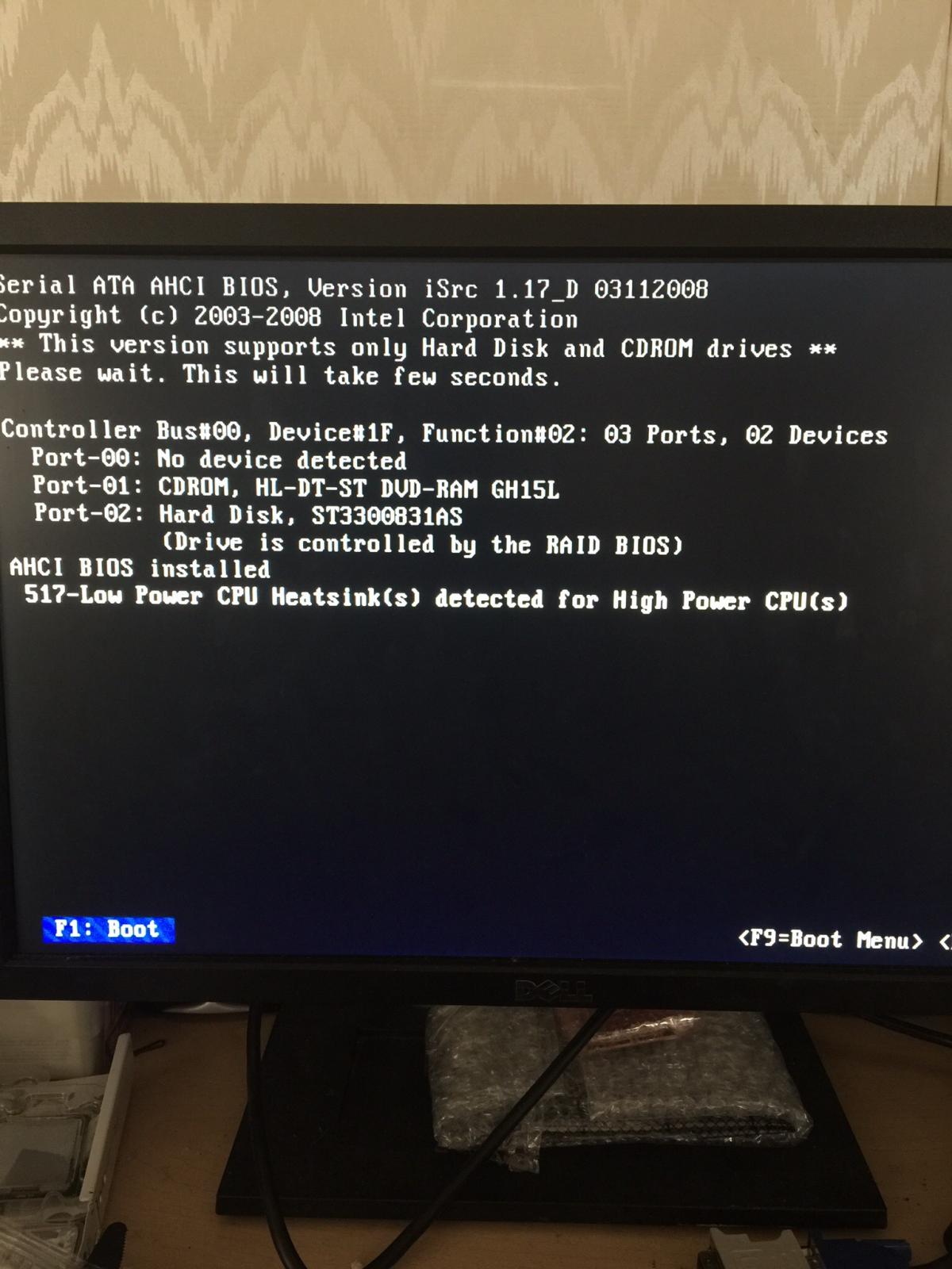

Blaggah Posted February 27, 2016 Share Posted February 27, 2016 (edited) What does this mean guys? It started happening since I installed 2x quad CPUs. Edited February 27, 2016 by Blaggah Link to comment https://www.insanelymac.com/forum/topic/297954-mavericks-1092-on-hp-xw8600/page/4/#findComment-2218952 Share on other sites More sharing options...
jdryyz Posted March 22, 2016 Share Posted March 22, 2016 I fortunately never saw that message with my xw8600. I was able to get a factory CPU heatsink/cooler to match the existing one when I decided to upgrade to dual processors. What heatsink are you using? Too bad you already got new CPUs, I have mine (and the second cooler) up for sale. My CPUs are the more energy efficient 3.0GHz variety (look at my sig). I no longer have the xw8600, by the way. I found a good deal on a REAL 2009 Mac Pro. Link to comment https://www.insanelymac.com/forum/topic/297954-mavericks-1092-on-hp-xw8600/page/4/#findComment-2225819 Share on other sites More sharing options...
Blaggah Posted April 23, 2016 Share Posted April 23, 2016 Well to my surprise, I no longer have that error. I just swapped the CPUs to E5472. Link to comment https://www.insanelymac.com/forum/topic/297954-mavericks-1092-on-hp-xw8600/page/4/#findComment-2234069 Share on other sites More sharing options...
