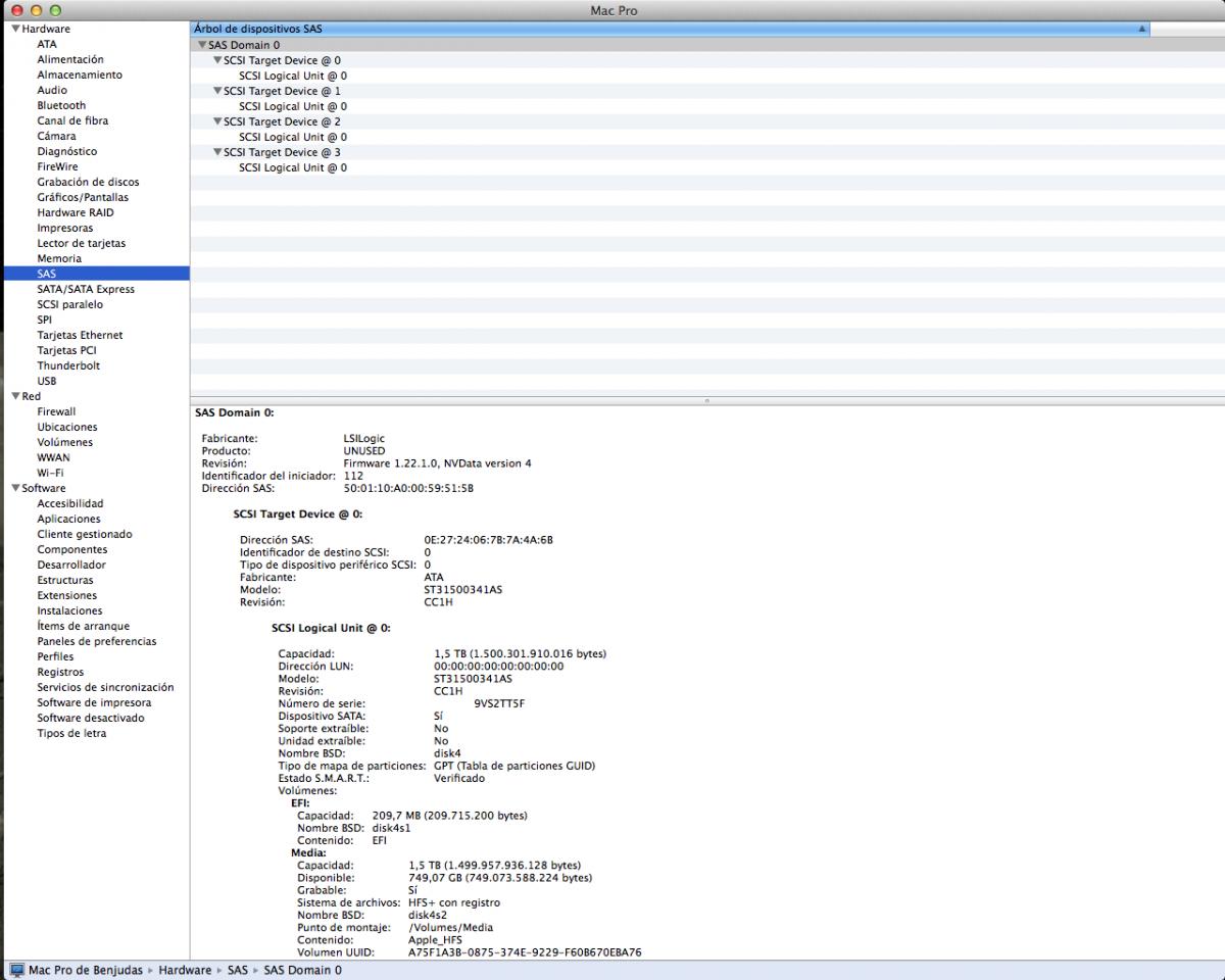

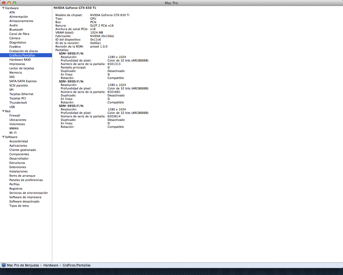

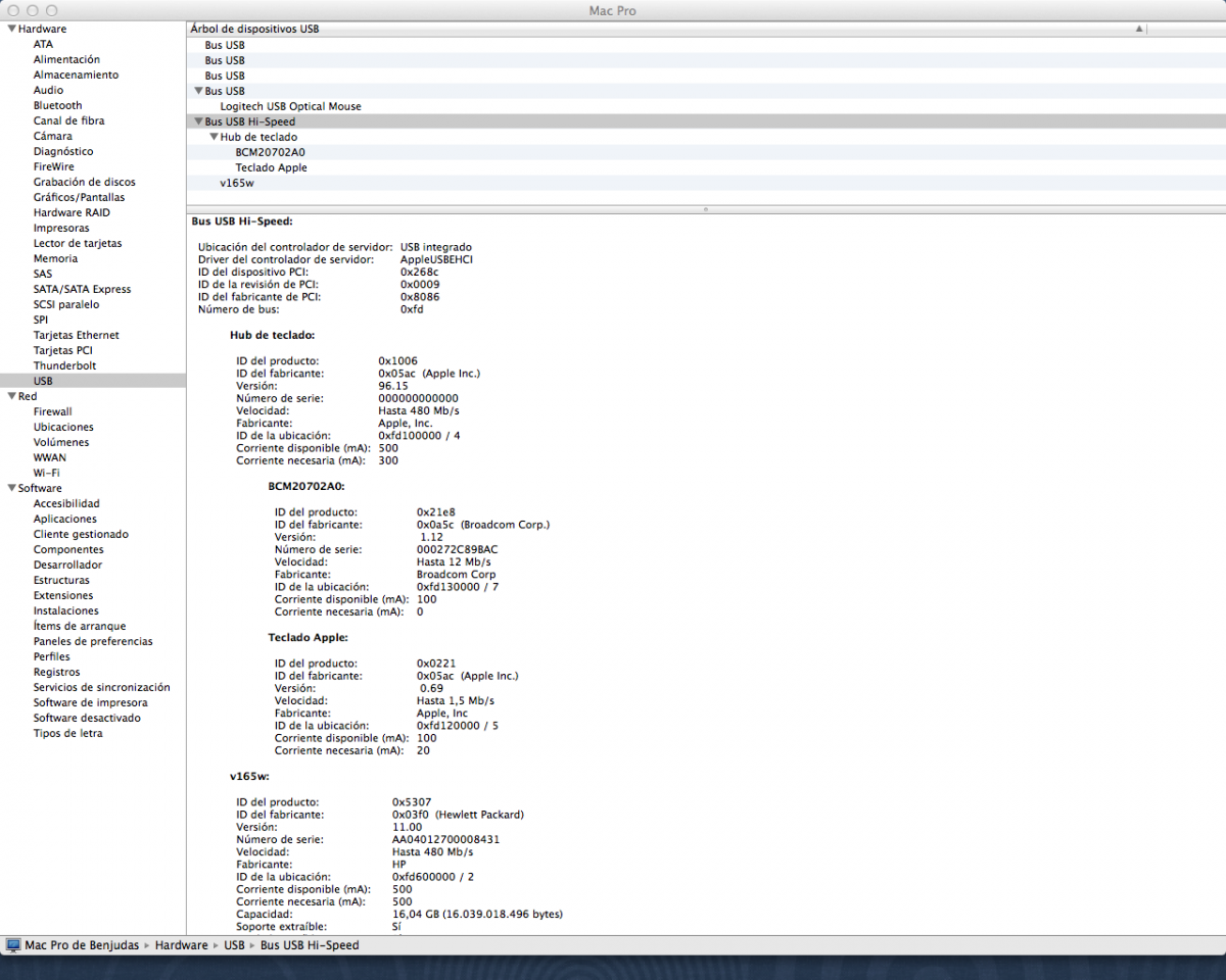

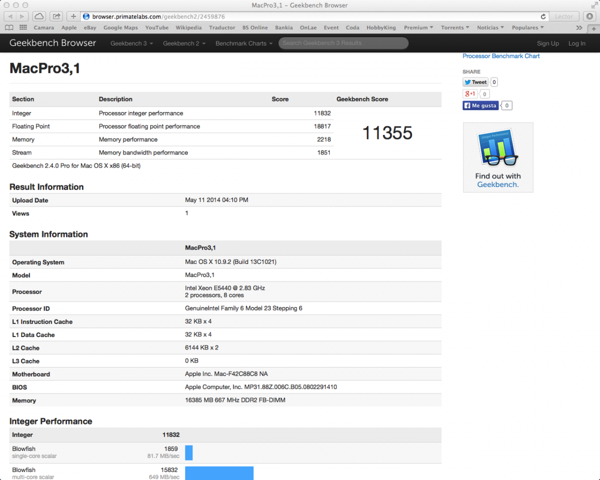

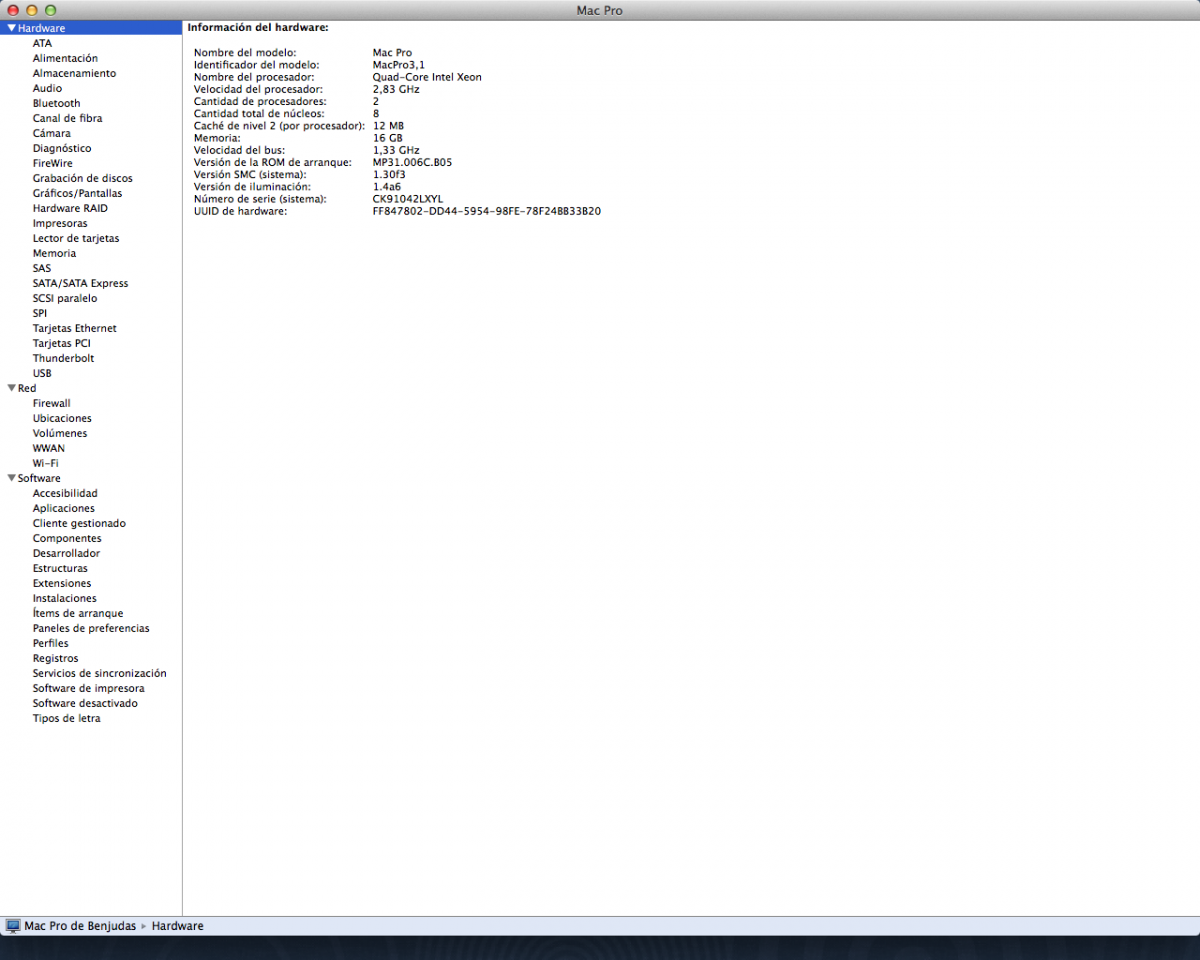

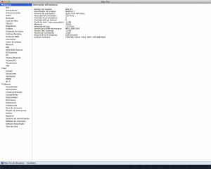

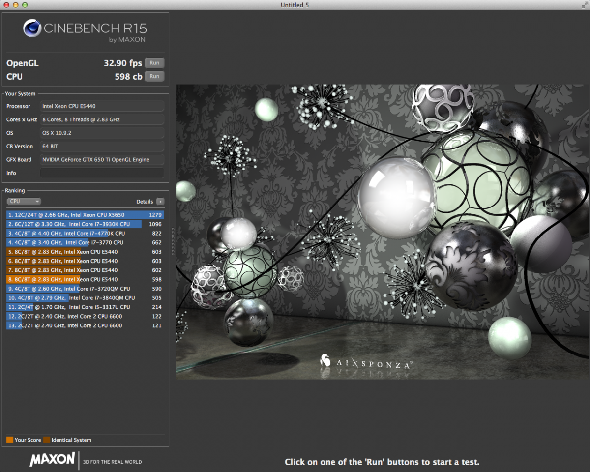

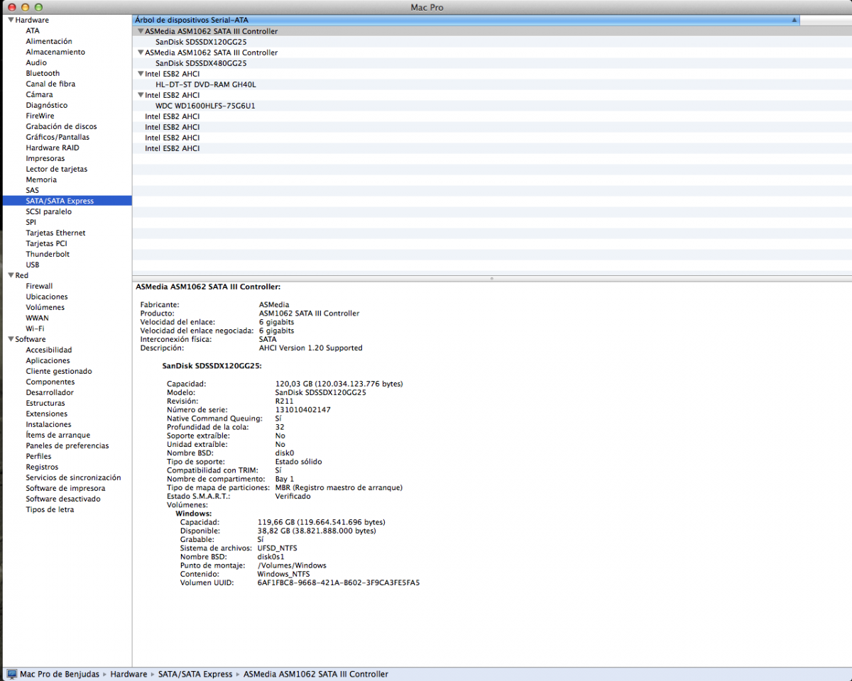

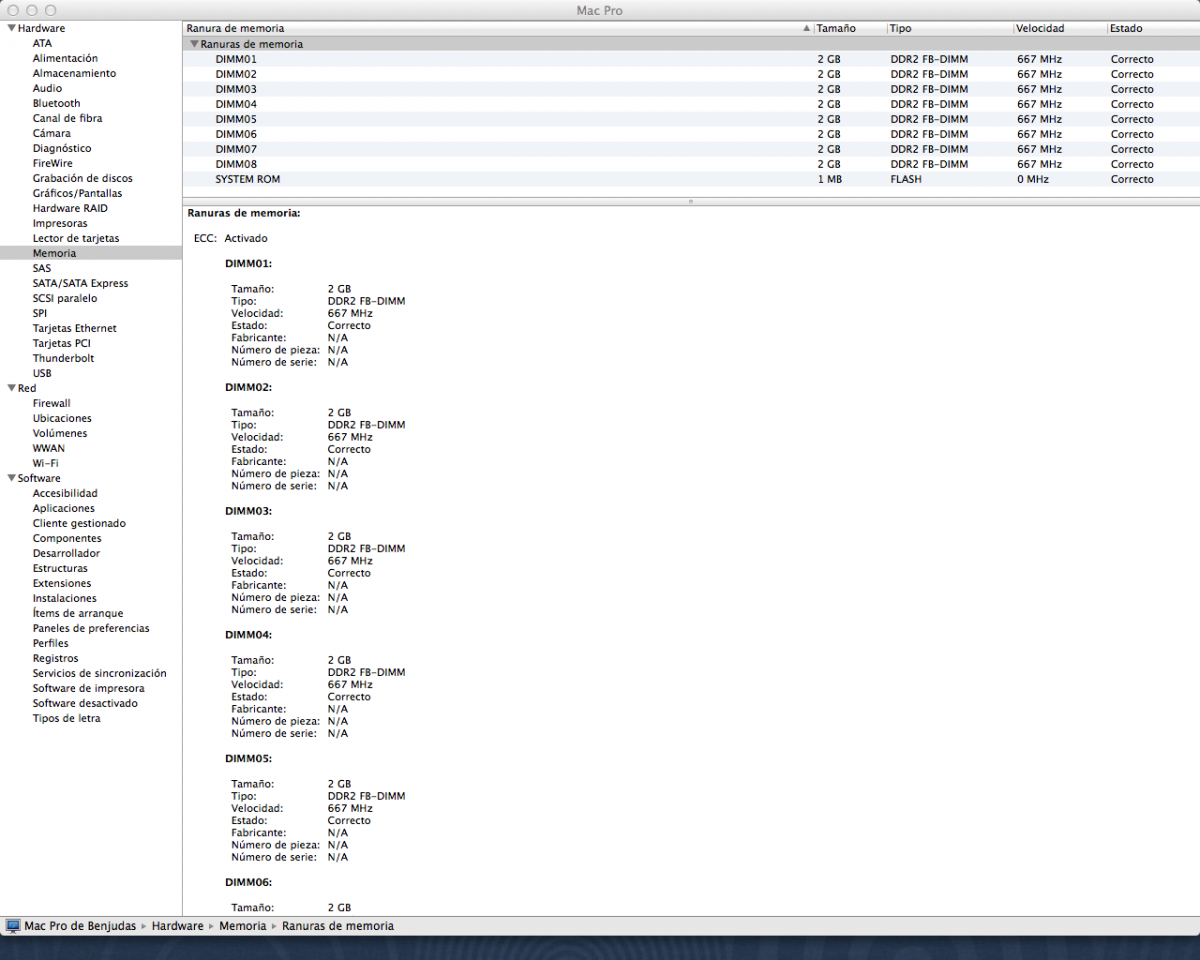

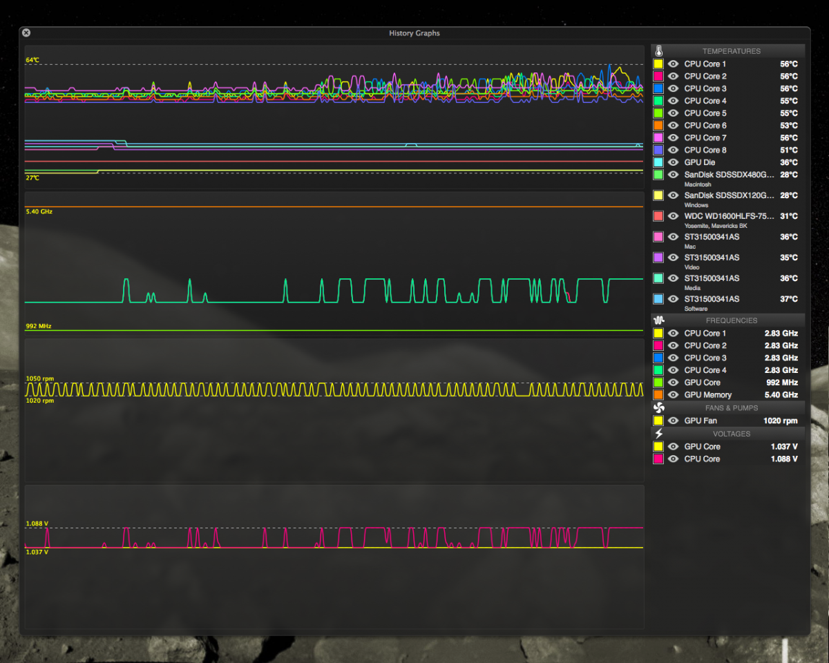

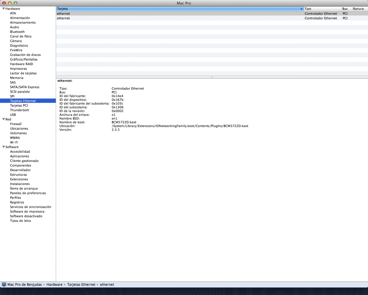

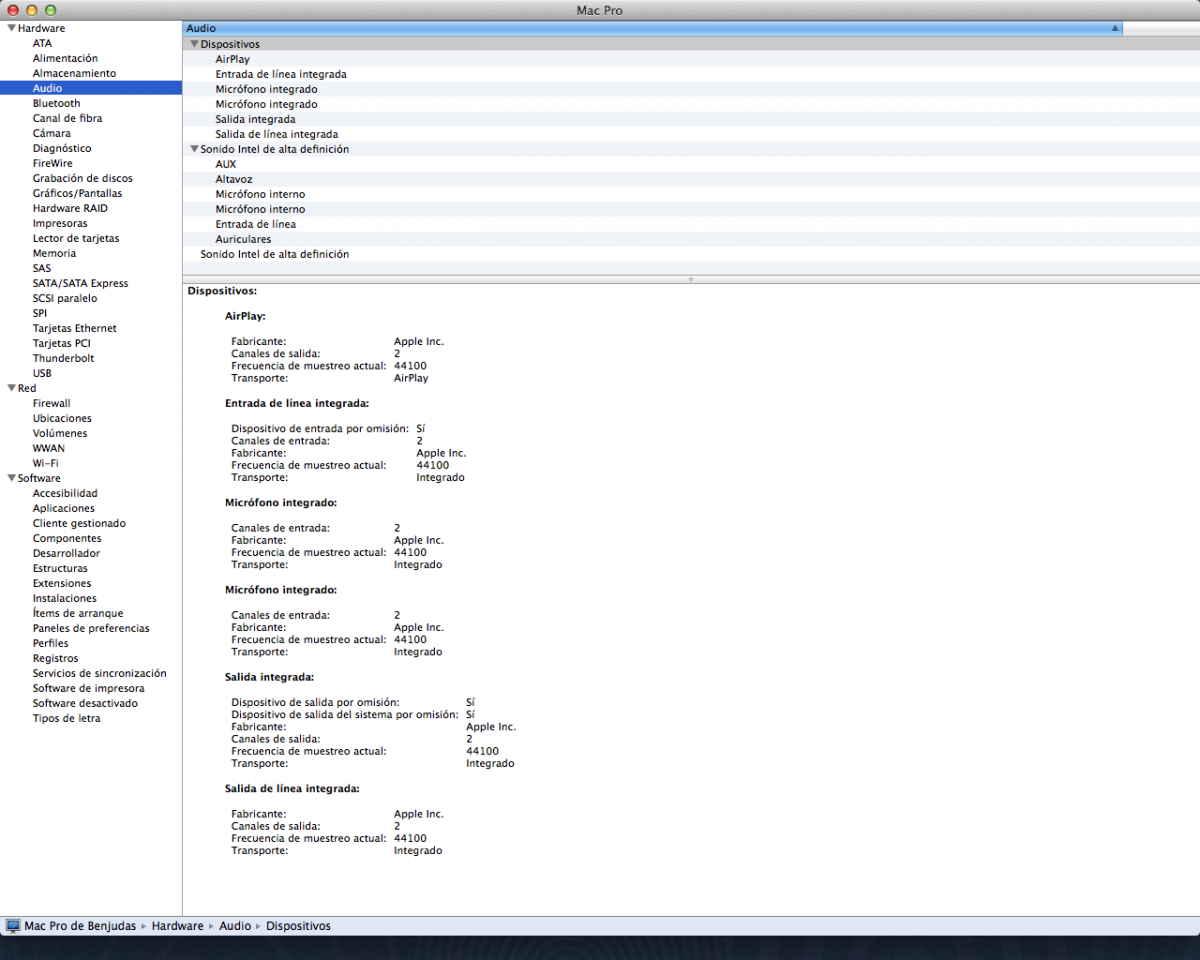

Benjudas Posted May 11, 2014 Share Posted May 11, 2014 Finally I managed to install 10.9.2 Mavericks on my HP XW8600 workstation.Everything works except the graphics power management (AppleGraphicsPowerManagement.kext).The installation method I followed is ##### with 10.9.1 installed without problems and combo update to 10.9.2, where I had to make a rollback of ACPIPlatform and IOPCIFamily from 10.9.1.The news is that I managed to run the original AppleHDA.kext with patch for ALC262 and some modifications in Platforms and Layout28 ping config, and activated through HDAEnabler.kext. You need to boot with -f boot flag to sound detected correctly. This is due to an IRQ conflict.The network works with BCM722D.kext of Adlan, the problem is that after sleeping no network. I have solved this with SleepWatcher 2.2 and editing these scripts:rc.sleep:sudo ifconfig en0 downsudo ifconfig en1 downsudo kextunload /System/Library/Extensions/IONetworkingFamily.kext/Contents/PlugIns/BCM5722D.kextrc.wake:sudo kextload /System/Library/Extensions/IONetworkingFamily.kext/Contents/PlugIns/BCM5722D.kextsudo ifconfig en0 upsudo ifconfig en1 upThe SAS works with a simple modification in the hardware id of the AppleLSIFusionMPT.kext info.plist.The SATA works thanks AHCIPortIjector.kext and in my case I selected in the BIOS menu the Raid-AHCI mode to get 6 ports working because I have a PCI card with ASMedia1062 Chipset, but you may need separate IDE setting if you haven't this card (only 4 ports).Sleep is working even waking from USBs, but when I wake, external disks are ejected. I solved this with an application called "Jettison".I am currently trying to refine the installation through DSDT and I got a DSDT (solved HDA IRQs conflict and HDAEnabler no more needed) that works without Sleep. I include it on files, any help will be appreciated.I know that it isn't perfect installation, but it works.Thanks to everyone that make this possible (Adlan, Toleda, Netkas, etc).Sorry about my english. Kexts XW8600 10.9.2.zip DSDT_Beta1.zip 2 Link to comment https://www.insanelymac.com/forum/topic/297954-mavericks-1092-on-hp-xw8600/ Share on other sites More sharing options...
nikdiablo Posted May 12, 2014 Share Posted May 12, 2014 Hi, do you have a method for solve the usb problem of HP XW4400? I have only this problem... Please help me Link to comment https://www.insanelymac.com/forum/topic/297954-mavericks-1092-on-hp-xw8600/#findComment-2018878 Share on other sites More sharing options...
Benjudas Posted May 12, 2014 Author Share Posted May 12, 2014 Hi, do you have a method for solve the usb problem of HP XW4400? I have only this problem... Please help me You just need to boot with -f boot flag, and USB will work. It's due an IRQ conflict. But I solved this problem thru DSDT edition. I have created a new topic to explain how to: Mavericks 10.9.2 on HP XW4400 - Complete Desktops - InsanelyMac Forum Hope it help you. Link to comment https://www.insanelymac.com/forum/topic/297954-mavericks-1092-on-hp-xw8600/#findComment-2018990 Share on other sites More sharing options...

Benjudas Posted May 6, 2015 Author Share Posted May 6, 2015 Basically, I patch the IRQ's conflict and the CPU power management. Without DSDT, I had no SOUND, no USB, the processors were overheated and speedstep didn't work. The rest, is cosmetical. Hope it help you. Link to comment https://www.insanelymac.com/forum/topic/297954-mavericks-1092-on-hp-xw8600/#findComment-2133702 Share on other sites More sharing options...

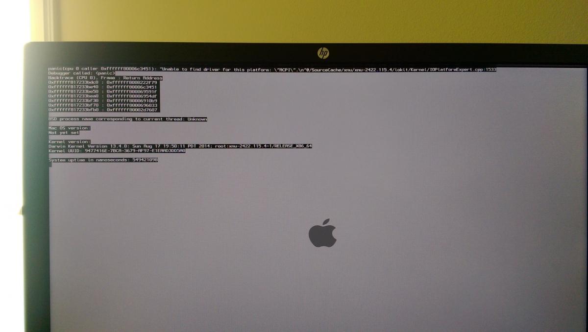

jdryyz Posted June 3, 2015 Share Posted June 3, 2015 Benjudas, have you updated to 10.9.5 yet? I created my USB boot drive using MyHack 3.3.1 from the 10.9.5 installer (Apple Store). t took me a while to find a compatible graphics card in order to get the installer to boot properly. My xw8600 originally had an nVidia Quadro 2000 installed. I kept getting a black screen when booting into the Mavericks installer. Funny thing is my previous Mountain Lion system had no problem with it. I tried a Radeon HD 2400 next and still had problems. Finally, a Quadro FX 1700 got me to the Mavericks installer screen. After the install completed and I rebooted, I could not get passed the Welcome screen. This is where I needed to pick my country. The mouse cursor moved but nothing could be selected. I rebooted the system in safe mode and was then able to complete the initial boot process. Unfortunately, I am unable to boot to the Finder unless in safe mode. This is not ideal, of course. Are all of your kexts still good with 10.9.5? I tried using the same Ethernet kext I used with ML. The new devices are recognized in the Network preferences but I am not picking up an IP. I'm wondering if it is due to being in safe mode. I also have an ASMedia SATA II card. I would like to get this working with Mav too. I see it showing up in the System Profile but the attached drive is not....again, probably because I am stuck in safe mode at the moment. Appreciate the help. Link to comment https://www.insanelymac.com/forum/topic/297954-mavericks-1092-on-hp-xw8600/#findComment-2141072 Share on other sites More sharing options...
Benjudas Posted June 4, 2015 Author Share Posted June 4, 2015 Did you use GraphicsEnabler=Yes? If yes, try without that option. I am in 10.9.5 with the same kexts, and all of them work perfect. If you are not using my DSDT.aml, I suggest to boot with "-f" option. Hope it help. Link to comment https://www.insanelymac.com/forum/topic/297954-mavericks-1092-on-hp-xw8600/#findComment-2141674 Share on other sites More sharing options...
jdryyz Posted June 4, 2015 Share Posted June 4, 2015 Is the default that GraphicsEnabler is yes? If so, I have not tried GraphicsEnabler=No yet. I will try that. In addition, I am booting with -f -v. Unfortunately, I still need safe mode to actually get to a working Finder. Oddly, one time it fooled me and opened a Finder screen only to have it become unresponsive and incompletely drawn. I will try your DSDT. It was suggested to me that I need to edit/create this for *my* card but this would be my first experience with it. Do I use something like Chameleon Wizard to edit the DSDT or is there a preferred program?. If I am doing that, maybe I should just jump back to the Quadro 2000. It is a better card. Link to comment https://www.insanelymac.com/forum/topic/297954-mavericks-1092-on-hp-xw8600/#findComment-2141741 Share on other sites More sharing options...
jdryyz Posted June 5, 2015 Share Posted June 5, 2015 Tried with and without. Even tried GraphicsEnabler=No and that results in a no signal indicator on my monitor. So, just like you might expect with turning the graphics off. I don't think I understood your info on DSDT. I do not have one yet and I was already using the -f option. Now should I get working on the DSDT? Link to comment https://www.insanelymac.com/forum/topic/297954-mavericks-1092-on-hp-xw8600/#findComment-2141903 Share on other sites More sharing options...
Benjudas Posted June 5, 2015 Author Share Posted June 5, 2015 Are you still booting from MyHack USB, or did you install Chameleon bootloader in the Hard Drive? I am asking this because if you are booting from the USB, I think that this can be a problem that have relation with the kexts that use MyHack to boot. Could you write you full specs. My xw8600 originally had an nVidia Quadro FX 1700, and if I remember well, I think that I could boot with this card without safe mode, but I´m not sure, that was long time ago. Link to comment https://www.insanelymac.com/forum/topic/297954-mavericks-1092-on-hp-xw8600/#findComment-2142212 Share on other sites More sharing options...

jdryyz Posted June 14, 2015 Share Posted June 14, 2015 Oh, I found a Chameleon update and installed it. It is v2.3 r2716. I mistakingly thought the Chameleon Wizard would check for bootloader updates but I see now they are two different things. The bootloader update did not help any, though. Interesting note, however-- I booted without any options after the update and smbios.plist was missing. It booted to the finder but everything was very slow. When I checked the "About this Mac", it thought it was a Mac mini. I updated smbios back to a MacPro 3,1 and rebooted.....it then got stuck at the usual spot. Link to comment https://www.insanelymac.com/forum/topic/297954-mavericks-1092-on-hp-xw8600/#findComment-2144879 Share on other sites More sharing options...
Benjudas Posted June 15, 2015 Author Share Posted June 15, 2015 You need to install, at least, IOPCIfamily.kext and AppleACPIPlatform.kext for boot normally. Both are rollback from 10.9.1, that are old kext, but they are needed for boot correctly. About chameleon, you do not need the last version for Mavericks. Chameleon is updating constantly for new mobos and Yosemite. The 2377 version is the last one that support Mavericks perfectly. The next one (2378) is the first one that support Yosemite. I told you that I use 2538, but it was a mistake. I use 2377, and it detects both processors, memory, and graphics perfectly. Here you have the rest of kexts updated to 10.9.5. They are for Audio, Lan, and SAS. I never upload this kexts because no one ask me. Hope it help you. Good hack! Rest of Kexts XW8600 10.9.5.zip 1 Link to comment https://www.insanelymac.com/forum/topic/297954-mavericks-1092-on-hp-xw8600/#findComment-2145408 Share on other sites More sharing options...
jdryyz Posted June 16, 2015 Share Posted June 16, 2015 I double checked those two kexts against what I had installed. From your 10.9.2 achive in the beginning of this thread, AppleACPIPlatform.kext is at v2.0 and IOPCIFamily.kext is at 2.8. Is that correct? In my Mavericks System\Library\Extensions folder, my IOPCIFamily was at 2.9. AppleACPIPlatform was the same version (no rollback on this one?) When I rolled back IOPCIFamily to 2.8 and rebooted, I got an error (see attached). Unfortunately, I did not make a backup of the original kext and now the system will not boot. Not too worry, though. I can always reinstall a fresh copy of Mavericks and start over. I also figured out that I can easily downgrade the Chameleon bootloader using the Wizard as long as the machine is on the internet. Fortunately, my ML system (on a different drive) has working Ethernet. I was able to pick the same loader you suggested and installed it. Once I get a stable Mavericks system, I will work on the Audio and LAN next. SAS would only be a curiosity if I can get everything else to work. I have it disabled in BIOS at this time. More to follow.... You need to install, at least, IOPCIfamily.kext and AppleACPIPlatform.kext for boot normally. Both are rollback from 10.9.1, that are old kext, but they are needed for boot correctly. About chameleon, you do not need the last version for Mavericks. Chameleon is updating constantly for new mobos and Yosemite. The 2377 version is the last one that support Mavericks perfectly. The next one (2378) is the first one that support Yosemite. I told you that I use 2538, but it was a mistake. I use 2377, and it detects both processors, memory, and graphics perfectly. Here you have the rest of kexts updated to 10.9.5. They are for Audio, Lan, and SAS. I never upload this kexts because no one ask me. Hope it help you. Good hack! Link to comment https://www.insanelymac.com/forum/topic/297954-mavericks-1092-on-hp-xw8600/#findComment-2145450 Share on other sites More sharing options...
Benjudas Posted June 16, 2015 Author Share Posted June 16, 2015 You have to install both at same time. They have dependencies them selves. You can rescue your system without reinstall. You just have to boot from intaller, run terminal, and copy AppleACPIPlatform.kext into S/L/Extensions, and boot with "f" option. More luck next time. Link to comment https://www.insanelymac.com/forum/topic/297954-mavericks-1092-on-hp-xw8600/#findComment-2145645 Share on other sites More sharing options...
