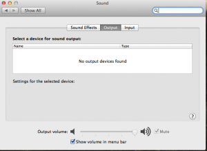

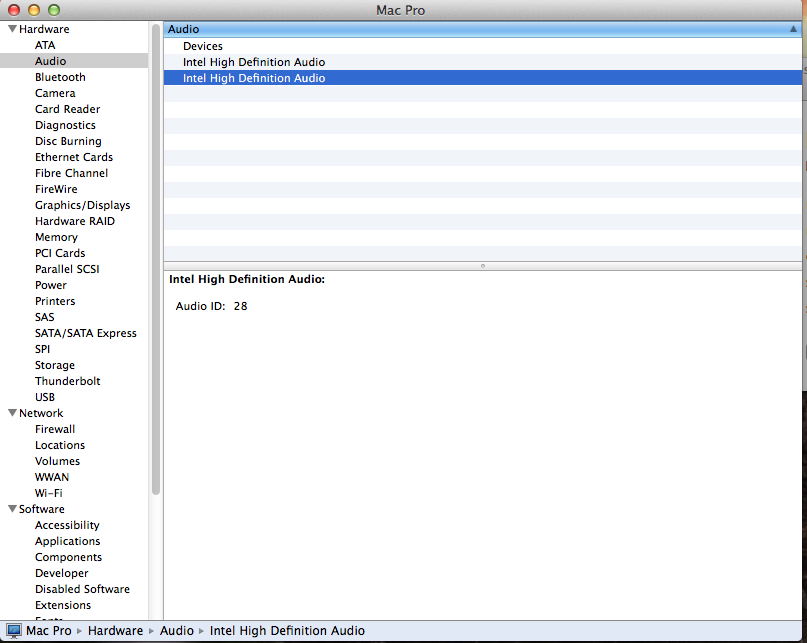

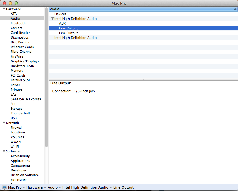

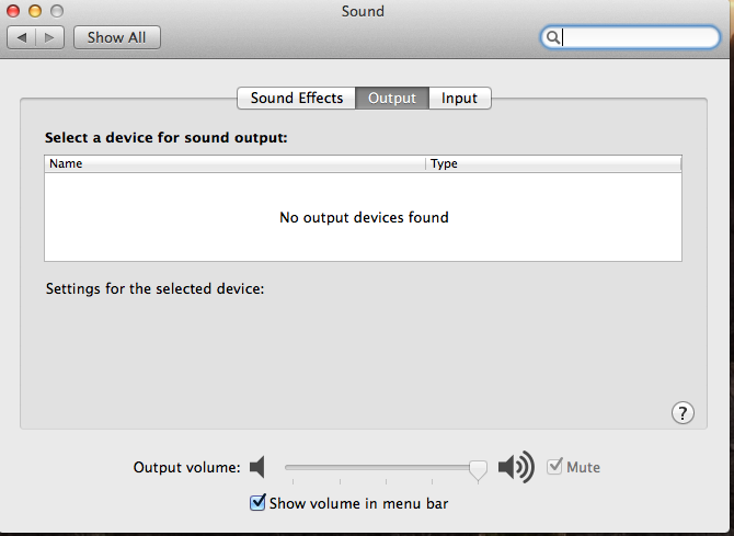

jdryyz Posted June 20, 2015 Share Posted June 20, 2015 Re-reading this thread, I see you mentioned you needed the DSDT to enable sound also. The AppleHDA.kext in your latest archive is still necessary too, just not the HDAEnabler? I also saw your comment on Yosemite (post #5) where you said it boots with many problems. When it boots for me, it acts just like it did with Mavericks (slow, unresponsive, crashing, etc.). Getting the IOPCIFamily installed correctly is what helped with Mavericks. Perhaps the same is needed for Yosemite. I understand there is a user on here (axmanA?) who is working on it for Yosemite, but I keep reading references to AMD not Intel processors. Link to comment https://www.insanelymac.com/forum/topic/297954-mavericks-1092-on-hp-xw8600/page/2/#findComment-2146700 Share on other sites More sharing options...
Benjudas Posted June 21, 2015 Author Share Posted June 21, 2015 Excuse me, my work has kept me busy again. To get the sound working you have two options: - Without DSDT, you need HDAEnabler.kext and AppleHDA.kext and start with "f" option. - With DSDT, only AppleHDA.kext and proper injection into the code. (My DSDT file). Sure, in both cases, that your sound is turned on in the BIOS. About Yosemite, I have not been able to try it too much, I just got it to boot and check that my old kexts not work properly. If you get any progress, please, post it. I will be very thankful. Link to comment https://www.insanelymac.com/forum/topic/297954-mavericks-1092-on-hp-xw8600/page/2/#findComment-2146910 Share on other sites More sharing options...
jdryyz Posted June 21, 2015 Share Posted June 21, 2015 Thanks. Just like with the IOPCIFamily.kext, does AppleHDA.kext and HDAEnabler have dependencies? Do they need to be installed at the same time? If you needed the DSDT for audio, wouldn't that guarantee I would too? Could you provide a copy of your DSDT without the CPU info somehow or tell me how to edit my own DSDT to correct the audio problem? I know a pogram called MaciASL but haven't used it. Too bad on Yosemite. Hopefully a solution is found in the future....then again we'll probably get El Capitan by then. Excuse me, my work has kept me busy again.To get the sound working you have two options:- Without DSDT, you need HDAEnabler.kext and AppleHDA.kext and start with "f" option.- With DSDT, only AppleHDA.kext and proper injection into the code. (My DSDT file).Sure, in both cases, that your sound is turned on in the BIOS.About Yosemite, I have not been able to try it too much, I just got it to boot and check that my old kexts not work properly.If you get any progress, please, post it. I will be very thankful. Link to comment https://www.insanelymac.com/forum/topic/297954-mavericks-1092-on-hp-xw8600/page/2/#findComment-2146947 Share on other sites More sharing options...
Benjudas Posted June 21, 2015 Author Share Posted June 21, 2015 When I said that they have dependencies, I mean that those kexts are related each other, so it is necessary install at same time for get the system boot, but in the case of sound it is different, if you do not install at same time, the only thing that could happen is that sound not work, but the system still booting. About if you need DSDT for get sound working, I have sound with both options, obviously I think is better if you use the DSDT option because the system boots faster and you install one kext less. The copy of DSDT without CPU code is very dificult to me right now, I am very busy these days so I invite you to try with MaciASL. Is exactly the app that I use. There are tons of information on internet, and I could point you in the right direction if you need it. Good hack my friend! Link to comment https://www.insanelymac.com/forum/topic/297954-mavericks-1092-on-hp-xw8600/page/2/#findComment-2147066 Share on other sites More sharing options...
jdryyz Posted June 22, 2015 Share Posted June 22, 2015 Sorry, I know you said the other two kexts had dependencies but I did not know that applied to the audio also. I will try again. I would like more into on using a DSDT to correct graphics and audio problems. Although, I am close to just getting an nVidia GT 740 graphics card because it is said to be supported out of the box in Mavericks without any tweaking necessary. My Quadro 2000 is a powerful card, but not under Mac OS X and I'm not convinced creating a DSDT will be enough. Thanks!! Link to comment https://www.insanelymac.com/forum/topic/297954-mavericks-1092-on-hp-xw8600/page/2/#findComment-2147315 Share on other sites More sharing options...

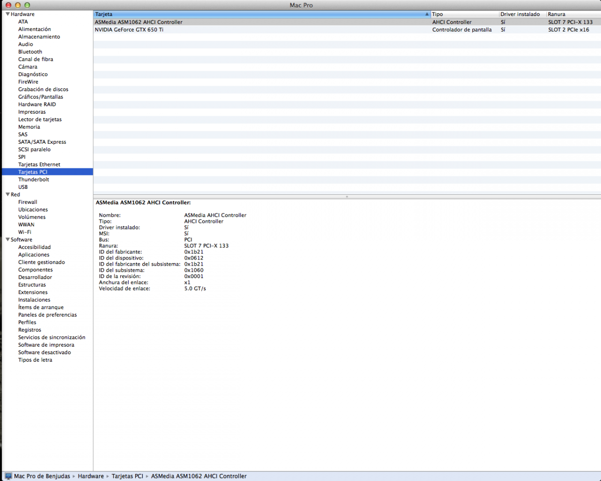

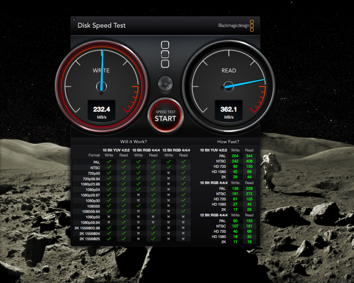

jdryyz Posted June 23, 2015 Share Posted June 23, 2015 Well, the audio problem is going to have to take a back seat for the moment. I discovered I am having trouble with my SATA III card. I was eager to try it out with my Crucial 250GB 6Gbps SSD drive. I installed a fresh system on the SSD using the built-in SATA (since the SATA III is not visible from the installer). I installed the IOFamily rollback and then used Multib**** Easyb**** to install the initial settings. The 3rd Party SATA driver was included in that, but I'm not sure if it is needed because the Asmedia 1061 card is supposed to be natively supported. This could be my problem right here, but I'm not sure. After installing the system on the SSD and I tried to boot, I had this problem: http://www.tonymacx86.com/general-help/65706-boot0-error-official-guide.html But I applied the fix and it booted fine after that. I have a 250GB 6Gbps rotational drive connected to the second port on the SATA III card. When I tried copying a large file ( over 3gb) from the SSD to the other drive, it was very slow.....then it actually froze and the system crashed. I had to do a hard shutdown. Copying small files seems fine, but I believe that has to do with not enough time to reach saturation speeds. I'm wondering about two other things: 1) What is the best PCI-e slot to use the card in? It is only a 1x card, I believe, but I'm not sure about how "lanes" work or if the card is really operating at the optimal speed. When I boot up, The Asmedia BIOS screen reports Gen 1 and I'm pretty sure I want Gen 2 and the card supports it. I tried putting the card in the second x16 graphics card slot (according to HP, this is a Gen 2 slot) but that did not help. Maybe I need to change a BIOS setting for how the slots are configured. Right now, they're set on Auto. 2) Cables. How important is using SATA cables rated for 6Gbps? I just grabbed two SATA cables from my stash and I'm sure they are older than SATA III. So when I put my SSD back on the built-in SATA II and transferred files, the crashing stopped. The rotational drive stayed on one of the SATA III ports. Of course, keeping the SSD on the built-in SATA is not ideal. Link to comment https://www.insanelymac.com/forum/topic/297954-mavericks-1092-on-hp-xw8600/page/2/#findComment-2147474 Share on other sites More sharing options...

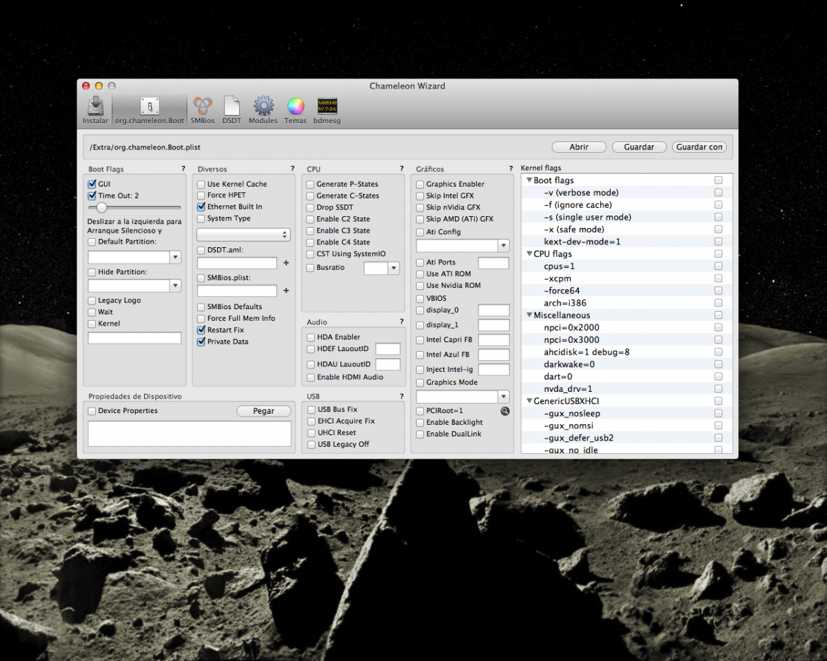

Benjudas Posted June 24, 2015 Author Share Posted June 24, 2015 I think that I know what are you doing wrong. You are installing Multib**** Easyb**** and it install a lot of kext that aren't needed. I suggest to make a fresh install, install all the kexts that I posted here (All of them at same time), and install build in Chameleon thru Chameleon Wizard. When you get ethernet working, you can update chameleon to 2377 version. Do not worry about old version kexts and old version of chameleon, because all of them should work in 10.9.5. Then post the result. We will talk again. About the PCI Slot, I use the number 7 as you can see in the picture, and the cables, I think that if you want to get the best performance, you should use the proper cables. I upload another picture with my SSD performance. Regards. Link to comment https://www.insanelymac.com/forum/topic/297954-mavericks-1092-on-hp-xw8600/page/2/#findComment-2147973 Share on other sites More sharing options...
jdryyz Posted June 24, 2015 Share Posted June 24, 2015 Actually, I am only using MultiB**** to install some kexts and only for things I know are safe...the FakeSMC, the Chimera boot, boot options, MacPro3,1 ID, and the 3rdPartySata. Nothing else. Easyb**** was only used as a guide. I made the same discovery about the best slot for the card and I see it the same way you do (oddly, as a PCI-x). It shows as a Gen 2 card when booting up now. There's still a problem with the card, though. It follows all drives connected to it and I see the same behavior on the Windows side so I do not think the Mac OS X is to blame. I may have just got a bad card. They're pretty cheap so I could get another. Too late to get a return. Out of curiosity, what is your firmware version? Mine is at 0.951 and there is a 0.954 update available. I do not know how to get it installed. It may involve using DOS. I made another important discovery yesterday. When I concluded that I may have a bad card, I decided to install the AHCIPortinjector.kext. I shutdown, moved my SSD over to the built-in SATA port 0, restarted and changed my BIOS settings to AHCI+RAID. The system booted up much faster!! I checked my speed using the speedtest program and it looked much better!! Consistent with a 3Gbps connection. I thought I was only sacrificing the RAID option when using the Separate IDE Controller setting. I was losing performance also!! I was wondering why the system seemed so sluggish. So I thought to myself, I do not need the SATA III card for now if the built-in SATA is working so well. Another problem, though. The "bad" card appears to have caused some data corruption on the SSD. Disk Utility shows errors it cannot repair and says I should make a backup right away. No problem, I will just reinstall a fresh system again. I decided it would be best to just remove the SATA III from the box since I won't be using it. But.....there seems to be some need for it still and I think it has to do with what you wrote in your first post: "The SATA works thanks AHCIPortIjector.kext and in my case I selected in the BIOS menu the Raid-AHCI mode to get 6 ports working because I have a PCI card with ASMedia1062 Chipset, but you may need separate IDE setting if you haven't this card (only 4 ports)." Using the ACHI+RAID setting in the BIOS and the AHCIPortinjector alone does not seem to be enough. When I boot up without the card, I get the Apple logo, and a funny looking box shows up on top of it. Booting in safe mode does not help. I'm really confused by this. What does the SATA III card do to make built-in AHCI work even though I do not have drives hooked up to it? By the way, your post says you have the ASMedia1062. When my system boots up, BIOS says 106X, but the Mac System Profile says 1061. How do I know for sure which card I have? I will double-check my packaging when I get home. Sorry for the long post, but I am making progress. I think that I know what are you doing wrong. You are installing Multib**** Easyb**** and it install a lot of kext that aren't needed. I suggest to make a fresh install, install all the kexts that I posted here (All of them at same time), and install build in Chameleon thru Chameleon Wizard. When you get ethernet working, you can update chameleon to 2377 version. Do not worry about old version kexts and old version of chameleon, because all of them should work in 10.9.5. Then post the result. We will talk again. About the PCI Slot, I use the number 7 as you can see in the picture, and the cables, I think that if you want to get the best performance, you should use the proper cables. I upload another picture with my SSD performance. Regards. Link to comment https://www.insanelymac.com/forum/topic/297954-mavericks-1092-on-hp-xw8600/page/2/#findComment-2148013 Share on other sites More sharing options...

Benjudas Posted June 25, 2015 Author Share Posted June 25, 2015 I have been using this setup from about one year ago, and is very stable and powerfull, so I suggest you to install manually apple.com.boot.plist, smbios.plist, and chameleon, and my experience in OSX86 world says that is better when you control what is installing in your system. You do not need 3rdpartysata.kext, just achiportinjector.kext is enought. I think that MultiB**** install nullcpupowermanagement.kext too so you loose speedstep feature.The best option that I know for connect the SSD is this:http://pages.ebay.com/link/?nav=item.view&alt=web&id=130830674778&globalID=EBAY-ESBut it is a bit expensive.It is great that you want to experiment with this machine to get the best performance, but I did it long time ago, and I think that you should employ your time in things that I did no get, like sleep or yosemite, but it is only a suggest.Right now, I am very busy and I can not help you fully. I hope that you do not misunderstand this comment, because all your progress is my gain. Regards, and good luck. 1 Link to comment https://www.insanelymac.com/forum/topic/297954-mavericks-1092-on-hp-xw8600/page/2/#findComment-2148110 Share on other sites More sharing options...
jdryyz Posted June 25, 2015 Share Posted June 25, 2015 Thanks again for your help. I appreciate it very much. No pressure on you to respond. Please do so only at your leisure. I was going to ask about smbios.plist because my system appears to be identified correctly without creating one yet. I do not know what the Unib**** USB is doing, though. Chameleon creates the apple.com.boot.plist also? I'm glad you mentioned the PCIe SSD adapter. I have seen them before and was curious. I cannot seem to find anyone talking about this particular card in a Hackintosh system, though. The ASMedia seems to be the one people are talking about. Or, they just use a recommended motherboard with built-in SATA III. How do you know this one works in the xw8600? This looks to be the same product, just a different brand: http://www.amazon.com/Apricorn-Velocity-Extreme-Performance-VEL-SOLO-X2/dp/B0090IA3GY/ref=sr_1_2?ie=UTF8&qid=1435154391&sr=8-2&keywords=Apricorn+velocity#Ask and it currently has a nice rebate offer. I assume this is the same as your eBay link (uses the Marvell 9128 chipset?) but this raises more questions: The last line in the product description says "The 2008 Mac Pro 3,1 is EFI64 but does not boot reliably, and therefore is not supported.". Since my xw8600 closely resembles the 2008 Mac Pro, wouldn't that be a problem or does it not matter since the card initially just thinks it is installed in a PC? And how is it that this card can work in a PC and a Mac? Wouldn't it need a Mac ROM to boot in a real Mac?? I guess it could be a hyrbid ROM. Second question is about the Marvell 9128 chipset. I read about Hackintosh people complaining about it and someone here posts that there is no driver support in Mac OS X: http://www.tonymacx86.com/buying-advice/99577-sata-6gb-s-pcie-controller-buying-tips-help.html but this mentions Mountain Lion not Mavericks. Would I need to use the 3rdpartysata.kext with this card? I have been using this setup from about one year ago, and is very stable and powerfull, so I suggest you to install manually apple.com.boot.plist, smbios.plist, and chameleon, and my experience in OSX86 world says that is better when you control what is installing in your system. You do not need 3rdpartysata.kext, just achiportinjector.kext is enought. I think that MultiB**** install nullcpupowermanagement.kext too so you loose speedstep feature.The best option that I know for connect the SSD is this:http://pages.ebay.com/link/?nav=item.view&alt=web&id=130830674778&globalID=EBAY-ESBut it is a bit expensive.It is great that you want to experiment with this machine to get the best performance, but I did it long time ago, and I think that you should employ your time in things that I did no get, like sleep or yosemite, but it is only a suggest.Right now, I am very busy and I can not help you fully. I hope that you do not misunderstand this comment, because all your progress is my gain. Regards, and good luck. Link to comment https://www.insanelymac.com/forum/topic/297954-mavericks-1092-on-hp-xw8600/page/2/#findComment-2148226 Share on other sites More sharing options...
Benjudas Posted June 25, 2015 Author Share Posted June 25, 2015 Let's go step by step. By default, chameleon identify your system as MacPro3.1 (even if smbios.plist don't exist), and in our case is the mac more similar to our machines, so we could no create it. But is recommended find a valid serial number, and create it for get work features like facetime. Chameleon doesn't create apple.com.boot.plist, is Unib**** USB who is creating it with a particular setting for get the most common systems get work. Now, your system is booting from USB, so it is using the apple.com.boot.plist inside the extra folder in your USB. My recommendation was that you try to make everything manually, because you will understand what is doing your system. About if some hardware is supported by my hackintosh, easy answer: if it works in a real mac, it should. Since Apple decided mount their macs with intel processors the most significant difference between a real mac and a pc is in the boot and SMC. A real mac boots thanks the EFI ROM and a PC boots thanks the BIOS. The magic began when some guy (who is called Netkas) created a kernel extension that can emule the SMC device, and a comunity (thru an open source project) created a bootloader that can emule the EFI ROM. So one time you get your system boot in OSX, if you use any device that it supported by OSX, it should work. I can't know if sure work, but I think that it should. But before buy any component, I think you should keep trying to get the system full working. I still thinking why your sound isn't working. I have installed this kext in my older system (HP XW4400) and it work perfectly. The only thing with this kext that you should know is that in the sound system preferences, the output devices are invested. So for get audio signal thru line output, you should select internal speakers. Sorry about the preaching. Regards my friend. Link to comment https://www.insanelymac.com/forum/topic/297954-mavericks-1092-on-hp-xw8600/page/2/#findComment-2148306 Share on other sites More sharing options...

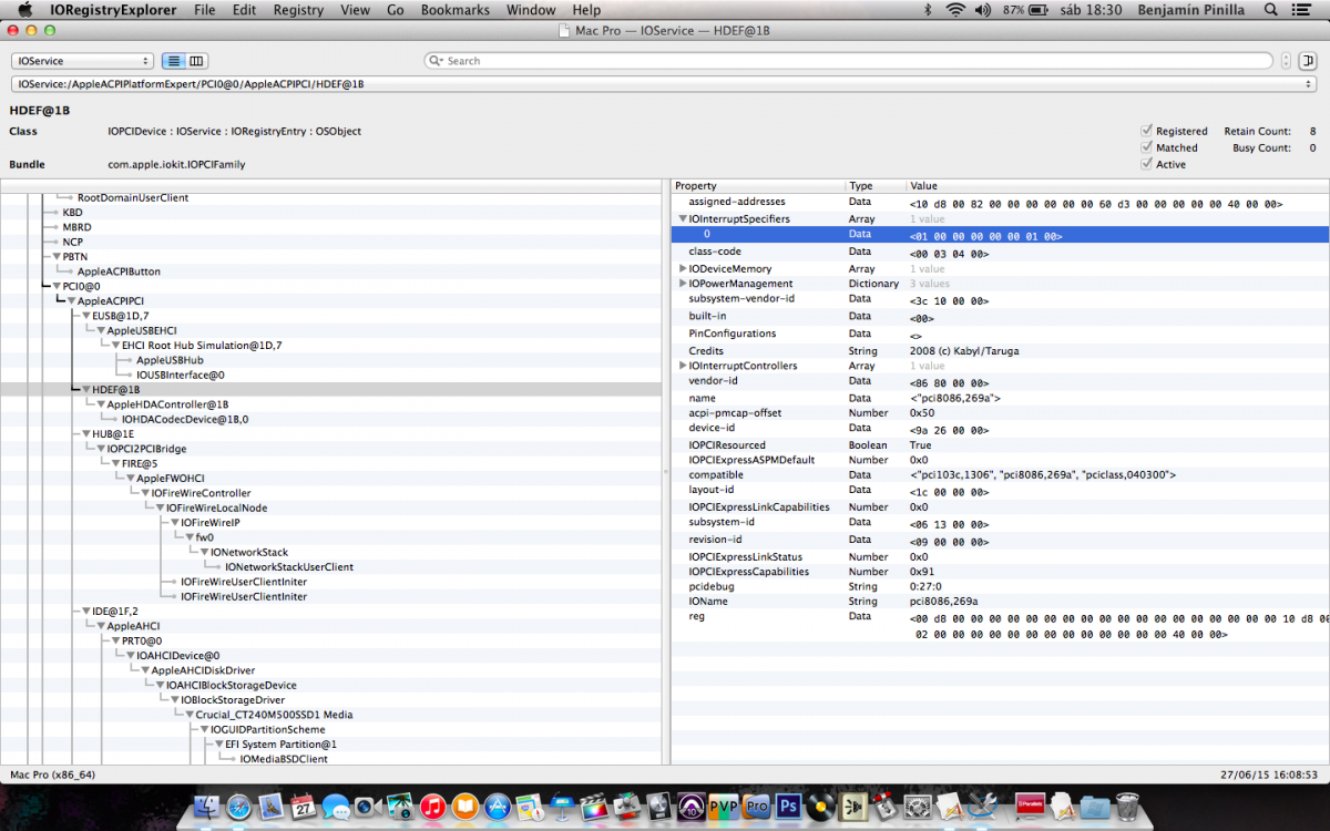

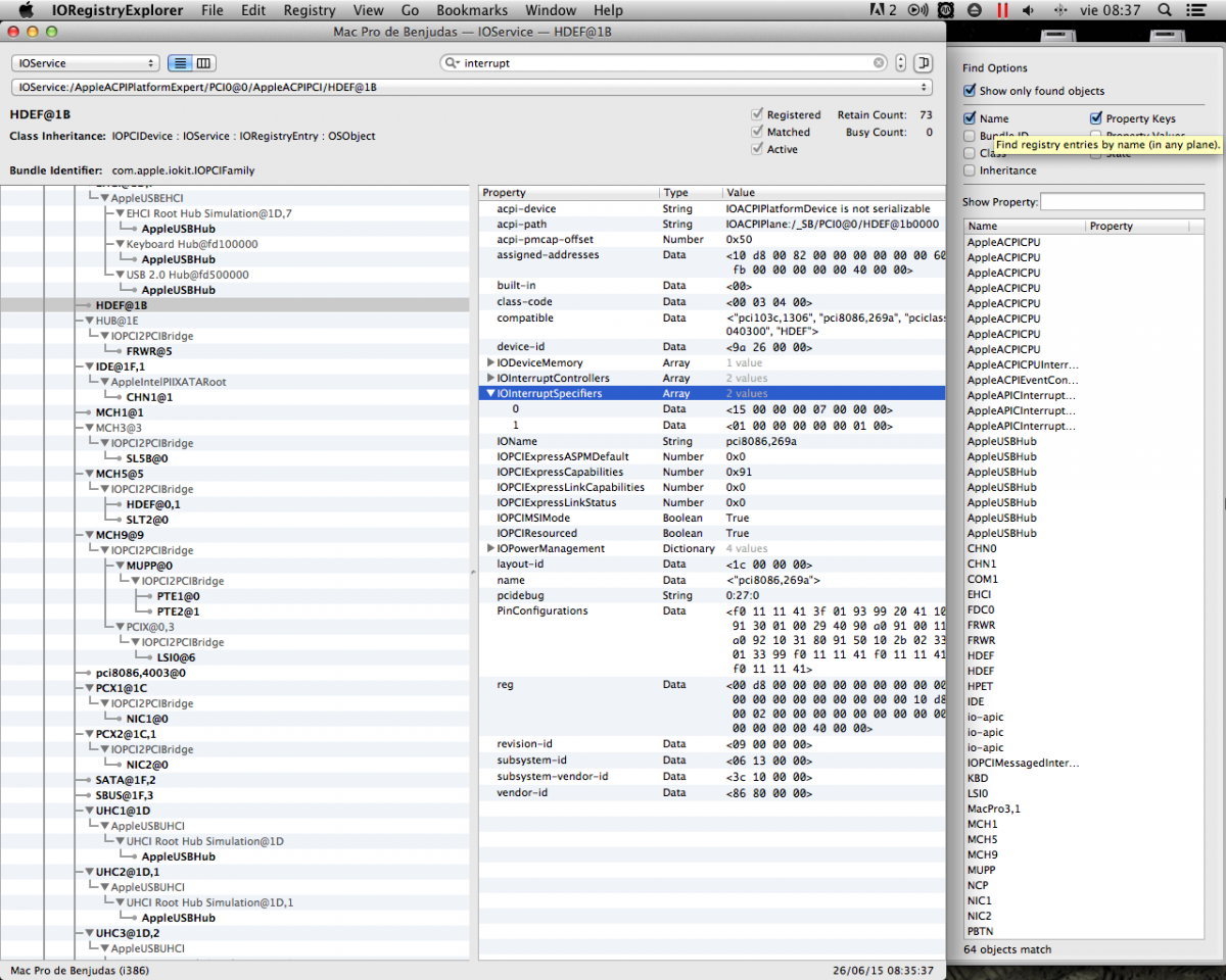

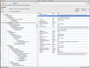

Benjudas Posted June 27, 2015 Author Share Posted June 27, 2015 For see what is happening, I need the ioreg file, so from ioregistryexplorer, go to file, click on "save as" and post this file. Are you using a pci ethernet card? Link to comment https://www.insanelymac.com/forum/topic/297954-mavericks-1092-on-hp-xw8600/page/2/#findComment-2148747 Share on other sites More sharing options...

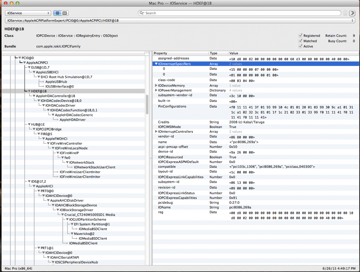

jdryyz Posted June 27, 2015 Share Posted June 27, 2015 Ohh...sorry about that. The file is attached. No, I do not have a PCI Ethernet card. I am using one of the two built into the motherboard. So, yes, it makes sense if I have "Ethernet Built In" checked, but what is it really doing if it is working without it? For see what is happening, I need the ioreg file, so from ioregistryexplorer, go to file, click on "save as" and post this file.Are you using a pci ethernet card? Mac Pro.zip Link to comment https://www.insanelymac.com/forum/topic/297954-mavericks-1092-on-hp-xw8600/page/2/#findComment-2148782 Share on other sites More sharing options...
Benjudas Posted June 27, 2015 Author Share Posted June 27, 2015 I see some differences in your IOReg. Basically your audio device is using only IRQ 1 that is used by CPU number one and you have no valid pingconfiguration. The only way to modify IRQ that I know is changing manually in BIOS (I don't recommend) or do it thru DSDT. So I edited my DSDT file, deleting my CPU code. Now it have a generic CPU code, so SpeedStep and CPUPowerManagement will no work. The bad news are that you have to know that I am not an expert, and I can not guarantee this DSDT, so if you decide to use it, do it at your own risk. If you do it, take care in the first boot with the CPU temp and if something goes wrong, turn off the computer and boot again with option "DSDT=No". You should rename it to "DSDT.aml" and copy the file into Extra folder for install it. DSDT_HPXW8600_EveryCPU.aml.zip 1 Link to comment https://www.insanelymac.com/forum/topic/297954-mavericks-1092-on-hp-xw8600/page/2/#findComment-2148841 Share on other sites More sharing options...
jdryyz Posted June 27, 2015 Share Posted June 27, 2015 Thanks. Odd about the CPU and audio being in conflict. You system has dual CPUs also, right? Hmmm... I can test your DSDT first by entering DSDT=/Extra/<filename>.aml on the command line, right? Link to comment https://www.insanelymac.com/forum/topic/297954-mavericks-1092-on-hp-xw8600/page/2/#findComment-2148859 Share on other sites More sharing options...
Benjudas Posted June 27, 2015 Author Share Posted June 27, 2015 Yes, my system is dual quad xeon. And yes you can use it by this way. Link to comment https://www.insanelymac.com/forum/topic/297954-mavericks-1092-on-hp-xw8600/page/2/#findComment-2148861 Share on other sites More sharing options...

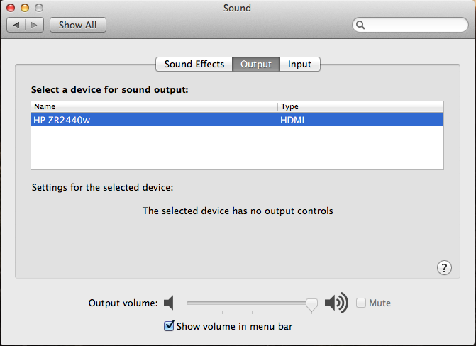

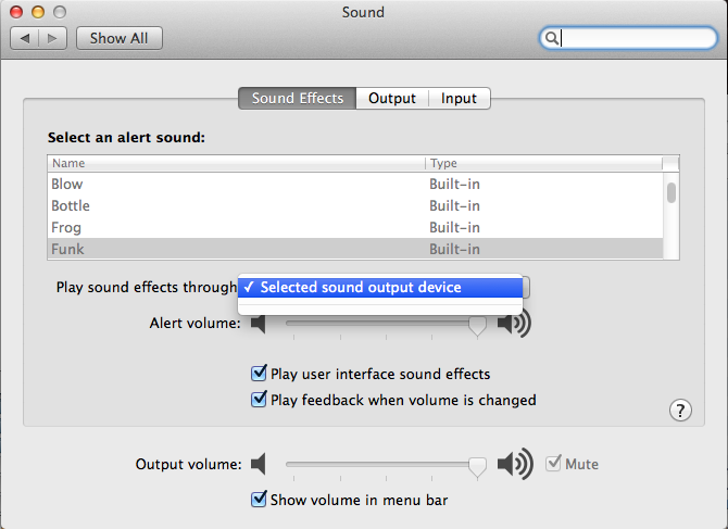

jdryyz Posted June 27, 2015 Share Posted June 27, 2015 Yes, using the command line entry did work. I see an available output device now!! Unfortunately, it is my monitor's audio since I am using a DVI --> HDMI cable right now. That is really cool, but it won't work for me because I do not actually have speakers hooked up to the coaxial connector on the monitor. Now if we can get the built-in motherboard audio output to show up, that would be GREAT!! Found a problem.....I can no longer shutdown after using the DSDT....also had trouble starting up one time. I didn't not realize the command had a permanent change. I had to use DSDT=No to undo it. I can see tweaking a DSDT is going to be a challenge. Since you mentioned CPU temps, do you have a problem with me using Multib**** to install its newer version of FakeSMC and the hardware monitor or would you prefer that I stick with your older FakeSMC? Is there a better source for the HW monitor? Like here, for example: http://www.hackintoshosx.com/files/file/4345-fakesmc-340-hwmonitorsensors-and-plugins/ That is from 2014 so I do not know if it is the latest. Link to comment https://www.insanelymac.com/forum/topic/297954-mavericks-1092-on-hp-xw8600/page/2/#findComment-2148862 Share on other sites More sharing options...
Benjudas Posted June 27, 2015 Author Share Posted June 27, 2015 Great! Did you boot with "f" option? This is very strange. We have the same system, the same Bios version, and the only difference are the processors. I think that it has to be any setting in the Bios. Could you reset your Bios? There is an option for reset thru a physical button inside the CPU. You have to unplug the computer and push it during 10 seconds. One time I lost one USB port and I had to do it, because thru the BIOS menu did not work. Link to comment https://www.insanelymac.com/forum/topic/297954-mavericks-1092-on-hp-xw8600/page/2/#findComment-2148875 Share on other sites More sharing options...
jdryyz Posted June 27, 2015 Share Posted June 27, 2015 Tried the -f and it booted to a white screen with no mouse so problems starting up and shutting down. I can try the bios reset. I better write down all my settings first. I know one way our BIOS is different. I have SAS disabled. Link to comment https://www.insanelymac.com/forum/topic/297954-mavericks-1092-on-hp-xw8600/page/2/#findComment-2148882 Share on other sites More sharing options...
