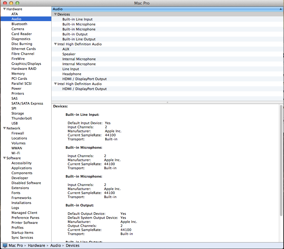

jdryyz Posted June 27, 2015 Share Posted June 27, 2015 Sorry to inform you the BIOS reset using the CMOS button did not help. I even purposely left the SAS ROM enabled this time as well as disabling the Integrated audio. Sure enough, that left me with only the HDMI option available in the System Report and still no built-in audio. I re-enabled audio. Link to comment https://www.insanelymac.com/forum/topic/297954-mavericks-1092-on-hp-xw8600/page/3/#findComment-2148910 Share on other sites More sharing options...

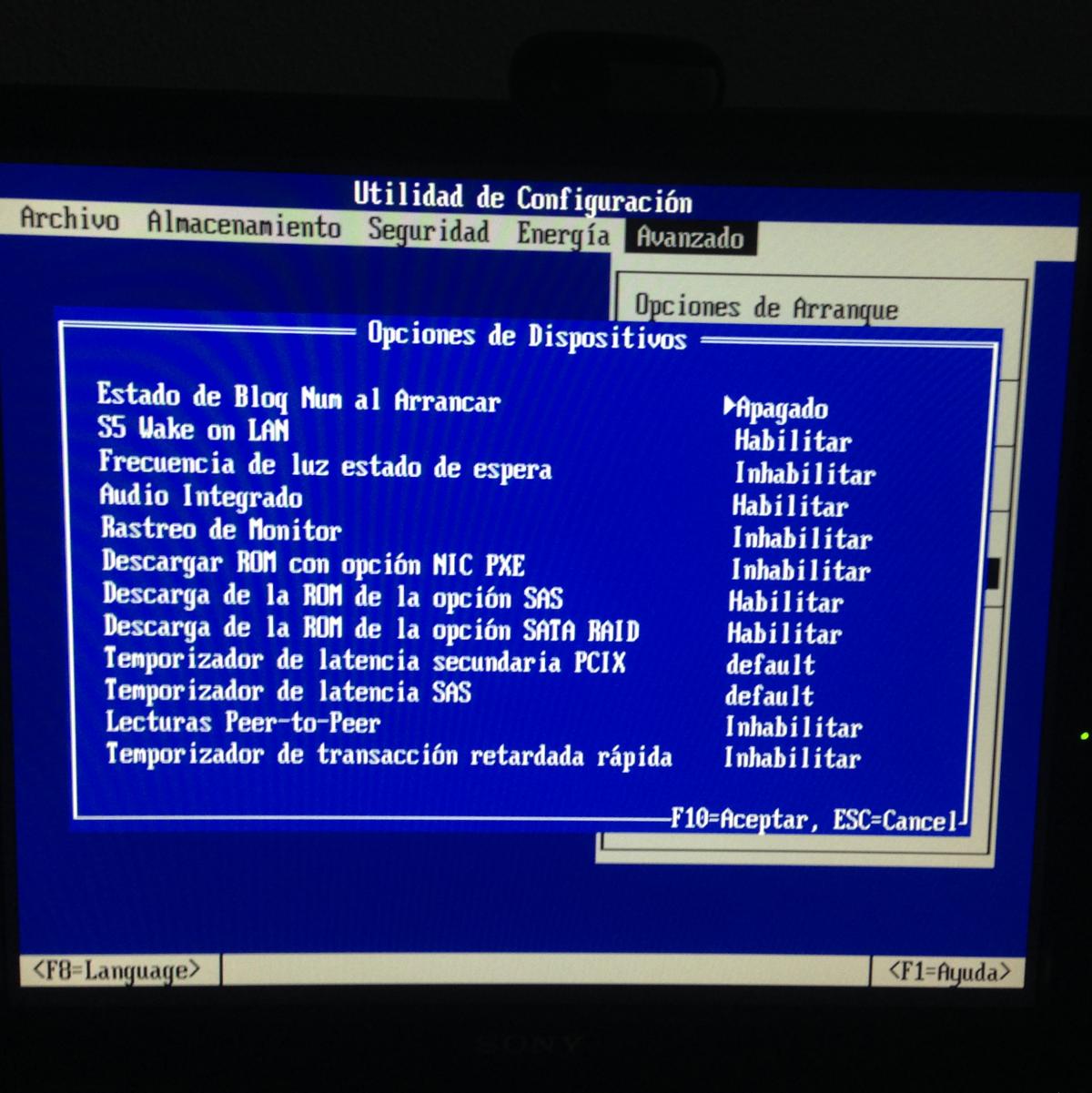

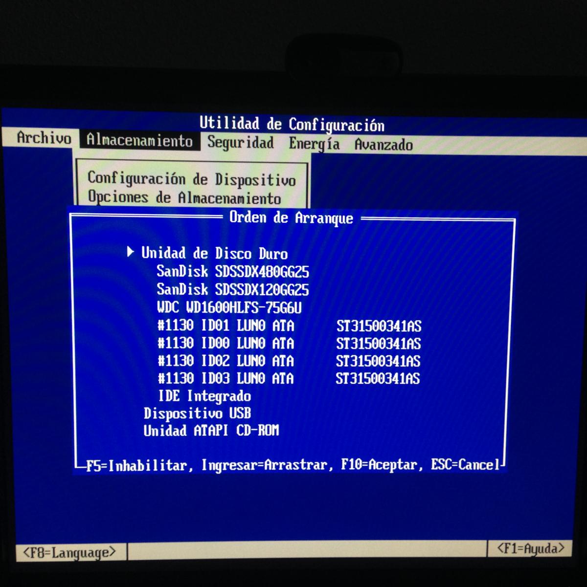

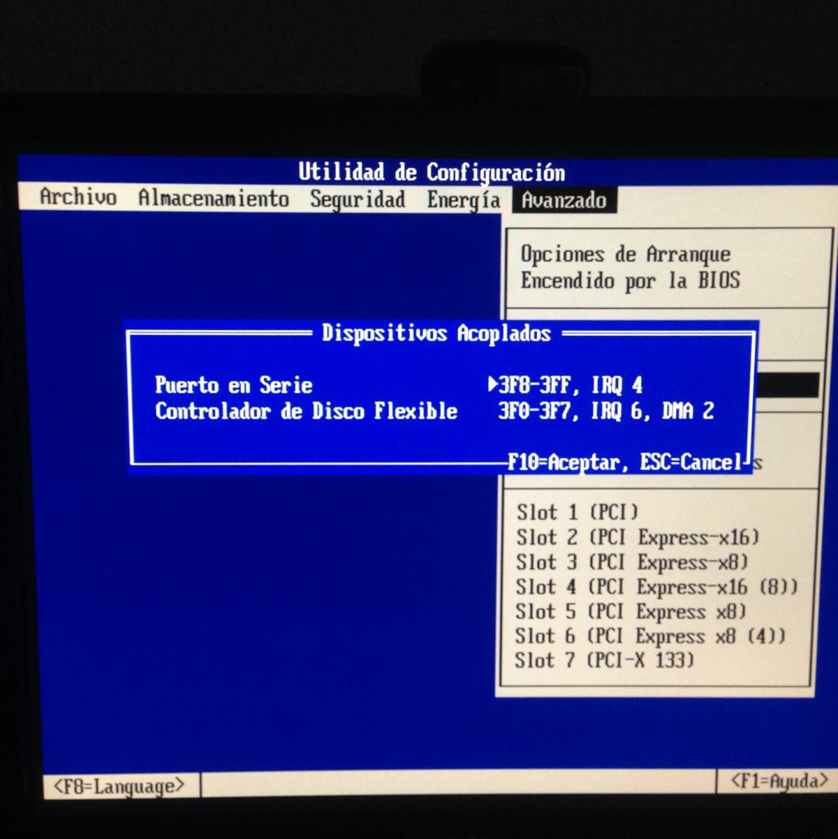

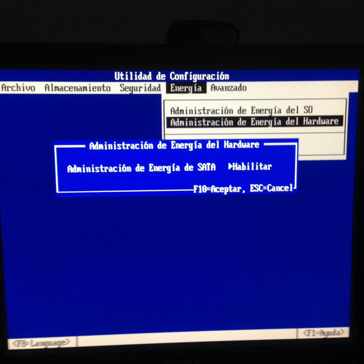

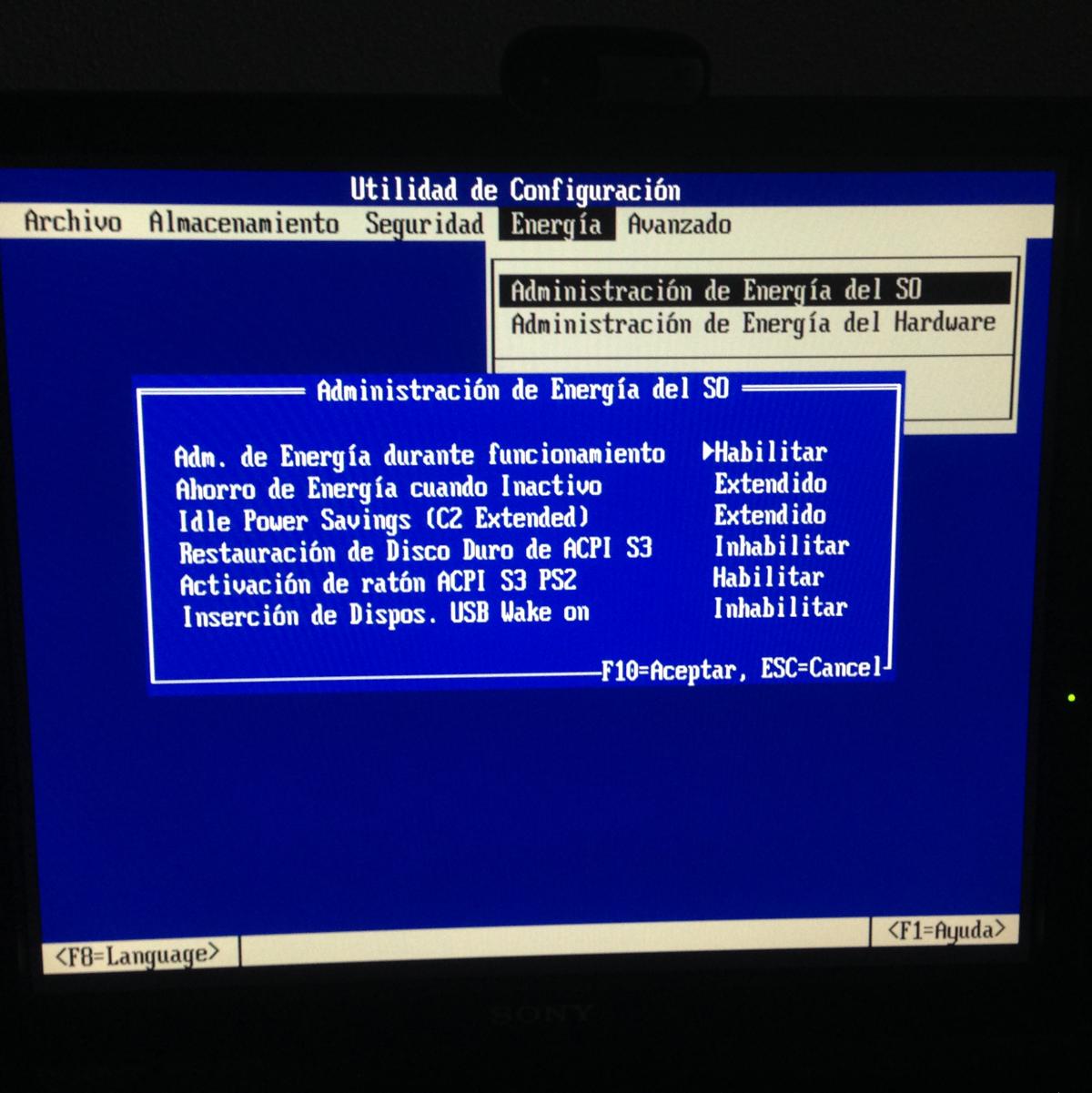

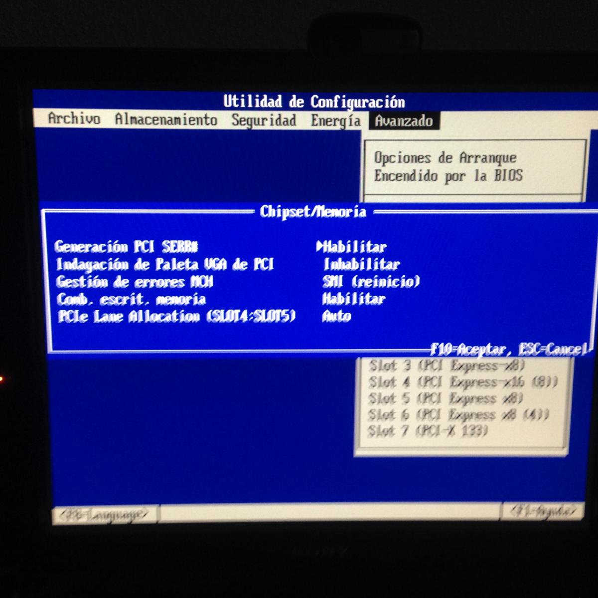

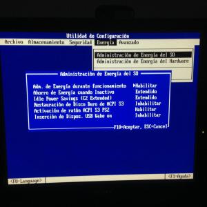

Benjudas Posted June 29, 2015 Author Share Posted June 29, 2015 I'm a little lost with this topic. I have no idea of why your audio is not working. I took some pictures of my Bios settings, maybe it can help you. Link to comment https://www.insanelymac.com/forum/topic/297954-mavericks-1092-on-hp-xw8600/page/3/#findComment-2149349 Share on other sites More sharing options...
jdryyz Posted June 29, 2015 Share Posted June 29, 2015 It look me a little longer due to the language difference, but our settings are the same....except, of course, where we have different hard drives. One thing that may or may not be important-- my processor 0 has a stepping value of 676, processor 1 (which I added later myself) has the value 67A. I honestly do not believe it matters. Both processors are recognized and are behaving normal in both the Mac and Windows side. I've read this was a problem for some users....until they upgraded their BIOS. Since I have the latest, I guess I'm okay. Link to comment https://www.insanelymac.com/forum/topic/297954-mavericks-1092-on-hp-xw8600/page/3/#findComment-2149359 Share on other sites More sharing options...

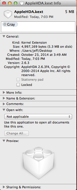

Benjudas Posted July 2, 2015 Author Share Posted July 2, 2015 Could you try with this one? AppleHDA.kext.zip 1 Link to comment https://www.insanelymac.com/forum/topic/297954-mavericks-1092-on-hp-xw8600/page/3/#findComment-2150285 Share on other sites More sharing options...

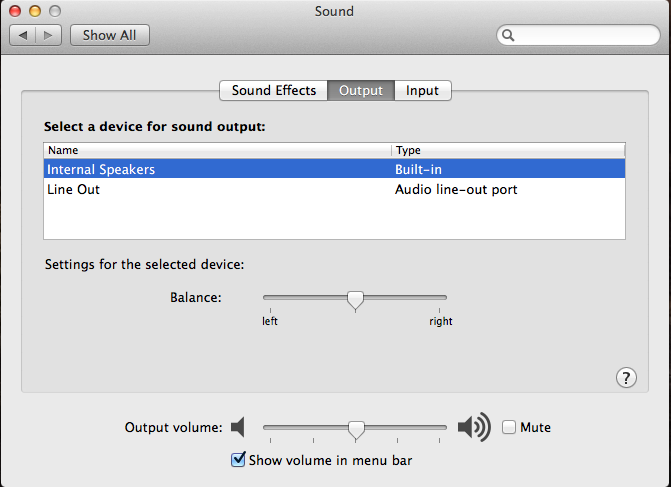

jdryyz Posted July 3, 2015 Share Posted July 3, 2015 I missed seeing this post earlier. Audio is working after applying this kext! I did have to use -f on boot. The audio output devices are switched, however. When I select "Internal Speakers", I get the external line out. When I select "Line Out", I get audio coming from the internal speaker. So, the disadvantage to using -f , is boot-up time is slightly slower. Is there any other disadvantage? I do not understand one thing-- the AppleHDA.kext is the same version (2.6.3f4) as the one you last provided, although they have different creation dates. How can I get a different result? Perhaps this all gives a better clue to making the DSDT work. As you said, it is better to have fewer kexts loading. Sorry again on changing video cards. Could you try with this one? Link to comment https://www.insanelymac.com/forum/topic/297954-mavericks-1092-on-hp-xw8600/page/3/#findComment-2150352 Share on other sites More sharing options...

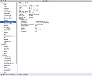

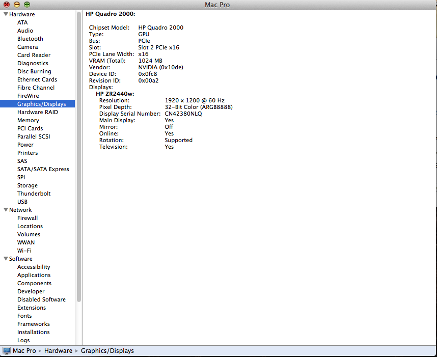

jdryyz Posted July 3, 2015 Share Posted July 3, 2015 I was able to "borrow" a Quadro 2000. I wanted to test your DSDT file. I am happy to say that it appears to be working 100%. No need for -f on startup and no problems with shutdown or restart. See the difference in the audio report attachment. I needed "GraphicsEnabler=Yes" for the 2000, of course, but the nVidia Web Driver seems to be working with it also. This wasn't the case before. Strange. Sadly, I would no longer want to be using this card now that I have the GT 740. The 740 is a superior card and is more at home in the Mac than the Quad 2K. Would it be difficult to modify the DSDT for the GT 740 or would it even be necessary?? Link to comment https://www.insanelymac.com/forum/topic/297954-mavericks-1092-on-hp-xw8600/page/3/#findComment-2150471 Share on other sites More sharing options...
jdryyz Posted July 3, 2015 Share Posted July 3, 2015 I reinstalled my GT 740 and the DSDT file still allows audio to work. Because of the "injected" Quadro 2000, my graphics report says it is still installed (as HP Quadro 2000, not nVidia.). So I am clueless on how all this works but I'm sure I would not want to keep the Quadro 2000 code in the DSDT file. Must it be replaced with the GT 740 in order to make the audio function correctly? Now that I think about it more, I would like to have the HDMI audio on the 740 functional as well since the computer will more than likely be moved to a TV with built-in speakers. Link to comment https://www.insanelymac.com/forum/topic/297954-mavericks-1092-on-hp-xw8600/page/3/#findComment-2150484 Share on other sites More sharing options...

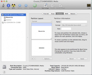

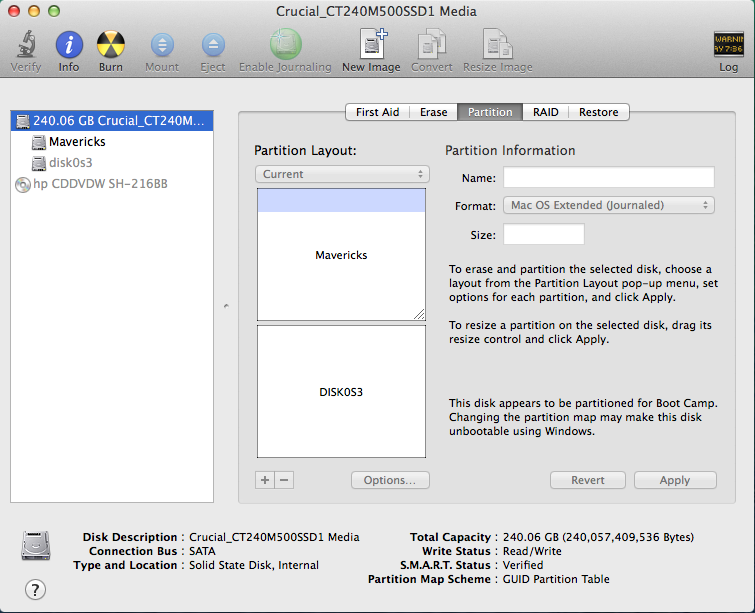

jdryyz Posted July 12, 2015 Share Posted July 12, 2015 I'm trying to setup a dual boot on my 240GB SSD drive and used this as a guide: only in the most basic way, mind you. I do not have Yosemite and Windows 10. I was mostly using it to guide me in the order in which things should be installed. This worked for me before, but I think that was when I actually installed the Chimera bootloader. So after the part in the video where my Windows is installed (version 7) and I boot back into the Mac OS X system using my USB boot drive, I install the Chameleon v2.2svn 2377 (as you recommend) bootloader along with option that fits my setup (Boot0hfs) because I have OS X and Windows on the same drive. After installing the bootloader, Windows is no longer bootable and the partition becomes hidden. See attachment. What am I doing wrong? If I install Windows 7 to a separate drive, no problem. Well, except for the visible "System Reserved" partition that need to make hidden. Link to comment https://www.insanelymac.com/forum/topic/297954-mavericks-1092-on-hp-xw8600/page/3/#findComment-2152757 Share on other sites More sharing options...

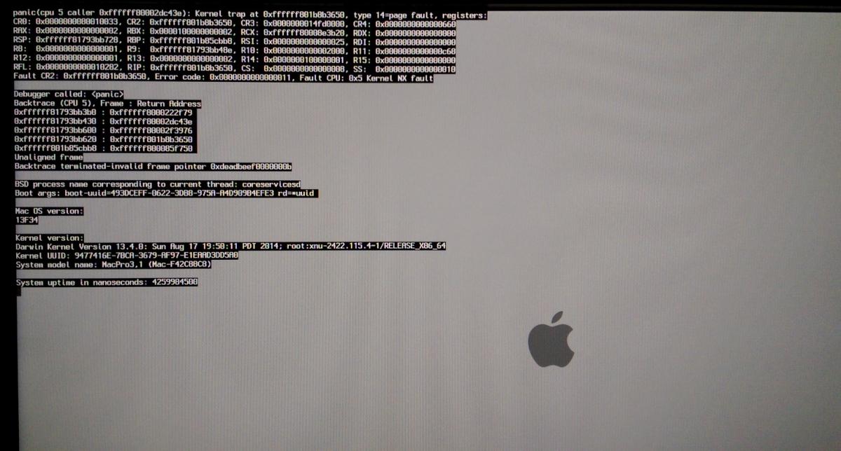

jdryyz Posted July 25, 2015 Share Posted July 25, 2015 I successfully installed two stepping-matched E5450 CPUs. Unfortunately, the system seems to have some trouble now. I am getting random lockups while using the Mac OS X side. Windows 7 side appears fine. In addition, I am sometimes getting kernal panic at startup. See attached. I tried recreating the smbios and chameleon settings but it did not help. Hope I do not have a bad CPU. I will try doing some HandBrake encoding under Windows to see how it does. Link to comment https://www.insanelymac.com/forum/topic/297954-mavericks-1092-on-hp-xw8600/page/3/#findComment-2155364 Share on other sites More sharing options...
