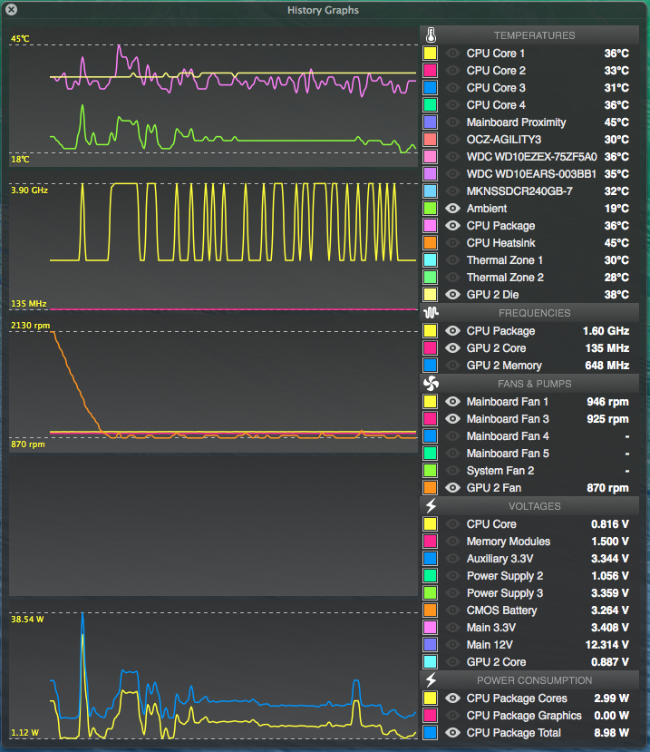

Gringo Vermelho Posted February 14, 2014 Share Posted February 14, 2014 My original question still stands, do the pstates really make that much of a difference for a desktop machine? At the bottom, HWMonitor shows how many watts your CPU is drawing. You should see the wattage going up and down as the operating frequency goes up and down. But it's not just about saving on the electricity bill, it's also about heat. Having your CPU clock actively regulated according to what it is actually doing, as opposed to constantly running at full tilt, means less energy is wasted, less heat is generated, which translates to longer component life. Next to yourself, heat is your PCs worst enemy lol So yes, definitely great for desktops. Laptops normally have more "steps" than desktops, which helps to improve battery life. Also laptops are much more difficult to cool so you'll want tighter regulation there. Link to comment https://www.insanelymac.com/forum/topic/296036-i7-3770k-ivybridge-power-management/#findComment-1993996 Share on other sites More sharing options...
Hackmodford Posted February 14, 2014 Author Share Posted February 14, 2014 try adding p and c states option via chameleon. if not try the _CST option with the kext. I'm using a generated SSDT. So in clover I have "dropoemssdt" on and turned off generate c/p states. What is the _CST option? -------------------- Basically it seems with the iMac option it's either 1.6 or 3.9 Link to comment https://www.insanelymac.com/forum/topic/296036-i7-3770k-ivybridge-power-management/#findComment-1994054 Share on other sites More sharing options...

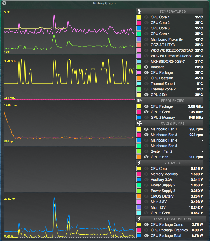

Hackmodford Posted February 14, 2014 Author Share Posted February 14, 2014 Okay I found a problem. If I wake from sleep while using xcpm the computer will spontaneously restart soon after. Here's HWMonitor using the normal imac13,2 PM. Link to comment https://www.insanelymac.com/forum/topic/296036-i7-3770k-ivybridge-power-management/#findComment-1994170 Share on other sites More sharing options...
