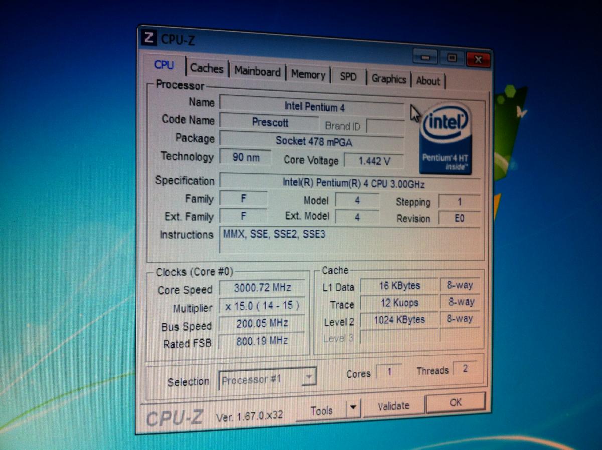

My CPU is Intel Pentium 4. I've done a screen of CPU-Z

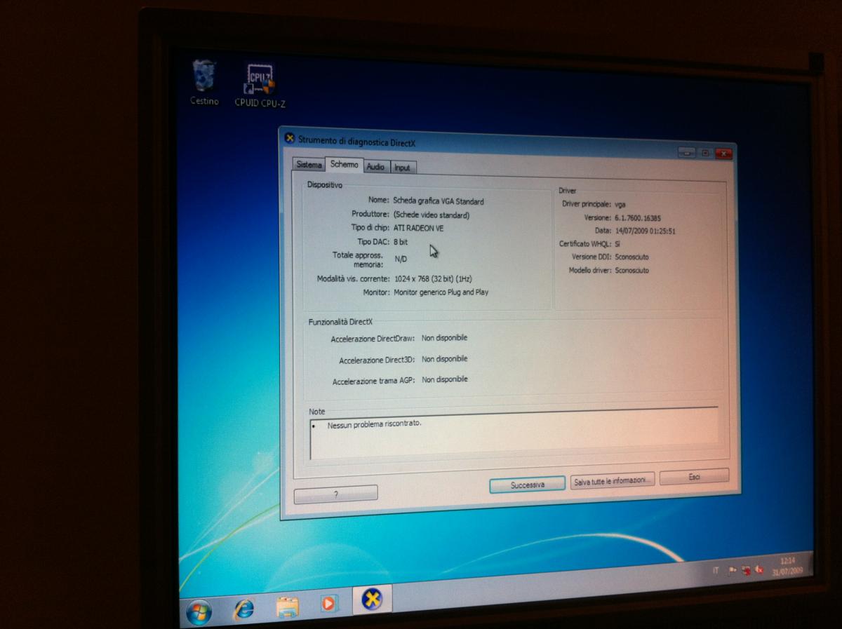

My GPU is an ATI Radeon but it's a little old  ^_^. I've done an other screen

3. Loose that old ATI RADEON, It will never work with Quartz Extreme / Core Image because Apple's Radeon drivers are PowerPC only! It will only work as a non-eccellerated VESA video.
4. Time is money. Don't waste your life trying to get it working (unless you find it phun/enjoyable). I've wasted 100s of hours trying to get OSX running on non-standard chipsets (by that I mean non-Intel because Apple has only ever used Intel chips on it's motherboards). In the end best hackintosh experience you can get will be from a motherboard that has an intel chipset that Apple has used. I've found that most Intel 945 or 965 based motherboards are fairly easy to get up and running on and are very affordable on eBay at this point. Sell your old mobo and put the money towards getting one of these old mobos instead.
I take that back... Lose the radeon... Your Pentium 4 is: a Pentium 4 HT 3.0E... Pentium 4 6xx is LGA775, not mPGA478 and 6xx has 2MB L2 cache... You should get a 8400GS or a HD 5450 THEN try installing snow leopard... and you can't install lion or newer :( because of your cpu being 32-bit, not because of ram
http://en.wikipedia.org/wiki/List_of_Intel_Pentium_4_microprocessors#Prescott_.2890.C2.A0nm.29
