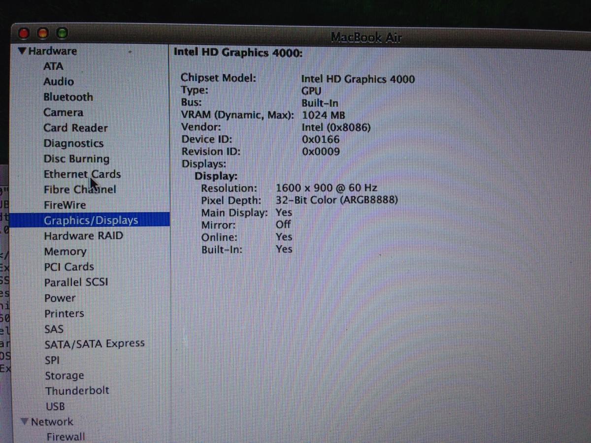

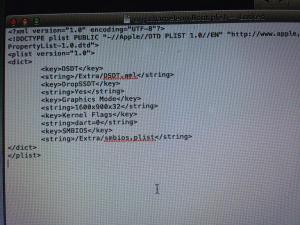

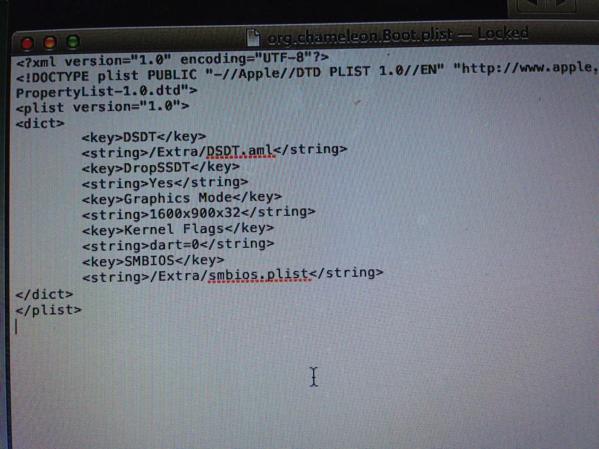

tgunduz Posted August 11, 2014 Share Posted August 11, 2014 Himy xps 14 laptop config is exactly same.I managed to install by follwing all the steps. I have Ethernet,Bluetooth,Battery level,Touchpad functionning fine Butscreen is flickering if i open safari scrren. Even icon magniying is flickering.In screen setting Video Card is detected as Internal HD4000. See attached images.I think i missed something. Any help to make the Video function perfectly ? Thank you Link to comment Share on other sites More sharing options...
Jake Lo Posted October 9, 2014 Share Posted October 9, 2014 This might be a late response but might be helpful for others who follow this guide and experience the same issue. The OP contains patched files for 10.9.0 and will work up to 10.9.3. If you're installing with 10.9.4 or 10.9.5, you'll lose QE/CI with the included FB patched for HDMI. You'll need a new patched FB (AppleIntelFramebufferCapri.kext). Restore with the vanilla kext and you should have QE/CI again but without HDMI audio, or patch the current FB for HDMI for you installed version of Mavericks. Link to comment Share on other sites More sharing options...
