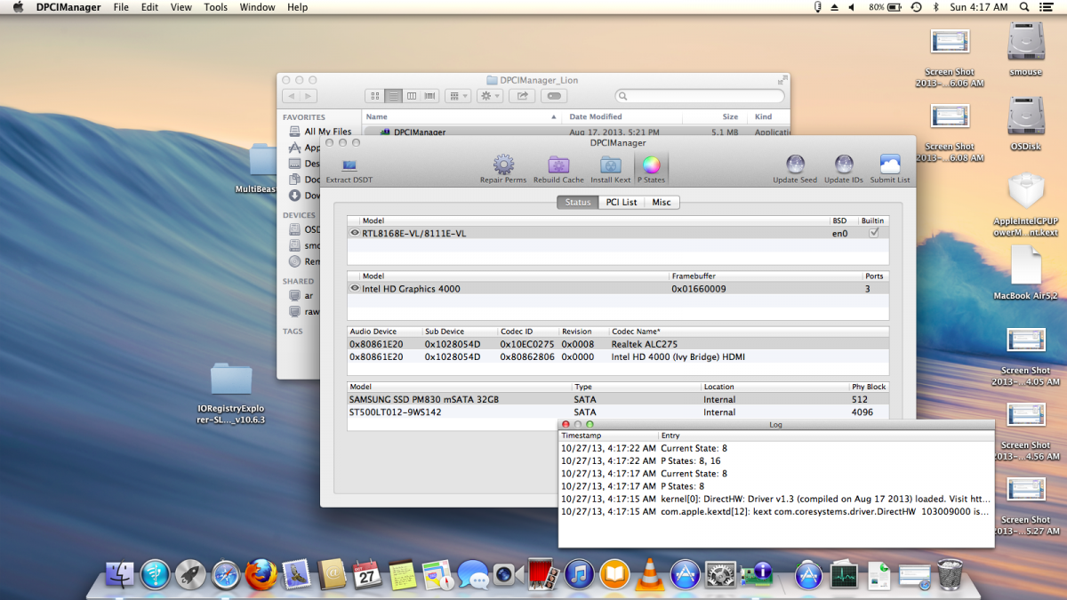

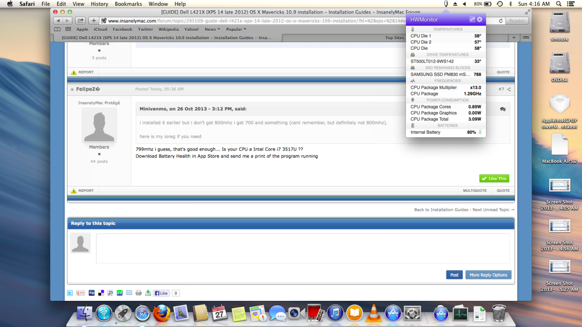

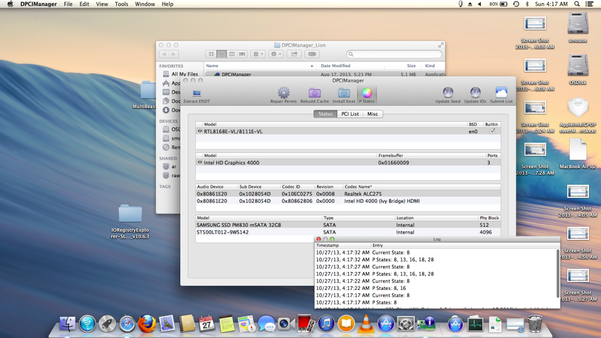

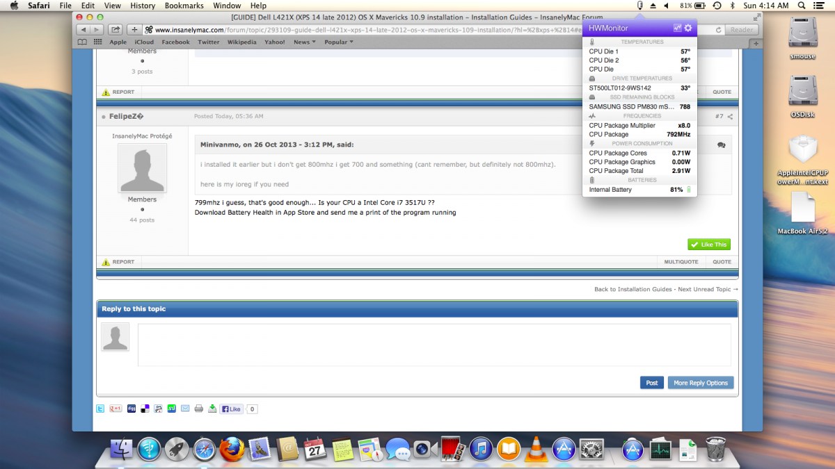

FelipeZé Posted October 26, 2013 Author Share Posted October 26, 2013 only 2 and a half hours as opposed to 6 hours in windows and the fan makes an a averagely load noise Strange, here i get 5:30 ˜ 6 hrs... Install Hwmonitor and see what CPU states are being reached, see if you get 800mhz state Link to comment Share on other sites More sharing options...
Minivanmo Posted October 26, 2013 Share Posted October 26, 2013 i installed it earlier but i don't get 800mhz i get 700 and something (cant remember, but definitely not 800mhz). here is my ioreg if you need MacBook Air5,2.rar Link to comment Share on other sites More sharing options...

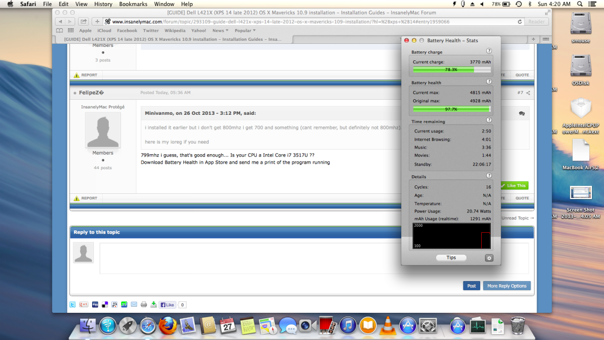

FelipeZé Posted October 27, 2013 Author Share Posted October 27, 2013 i installed it earlier but i don't get 800mhz i get 700 and something (cant remember, but definitely not 800mhz). here is my ioreg if you need 799mhz i guess, that's good enough... Is your CPU a Intel Core i7 3517U ?? Download Battery Health in App Store and send me a print of the program running Link to comment Share on other sites More sharing options...
Minivanmo Posted October 27, 2013 Share Posted October 27, 2013 ok here are a couple of screen shots of battery health, dcpimanager pstates and hwmonitor. the fan still spins when sleeping and the light in front of the laptop doesn't go on and off when sleeping so i don't think it is sleeping even though it goes to the lock screen when opening the lid. Link to comment Share on other sites More sharing options...
FelipeZé Posted October 28, 2013 Author Share Posted October 28, 2013 I think that everything is OK with your installation... keep in mind that after a install OS X demands more power to put everything in cache so it take some time to normalize power usage, you can also use less brightness in the screen as it is what consumes more power, look at my battery usage: it's lower than ur's but can be because of low brightness *ajust with fn + brightness up or down and i'm not using any heavy app.... Link to comment Share on other sites More sharing options...
