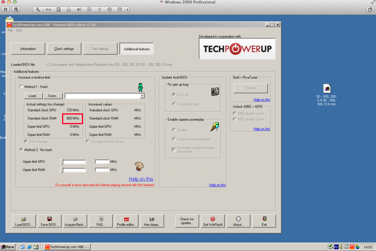

Alex009988 Posted December 13, 2013 Share Posted December 13, 2013 I'm not sure about memory clock now, but I did tried to OC the memory clock too. What I did was using RBE to edit my VBios first and compared the difference with original VBios in HexEdit. And last, input the PatchVBiosBytes value to Clover. My 6850's normal memory clock is 1000(mhz)x4 which is something like 0x186a0 and "a0 86 01" in VBios if I remember it correctly. After using RBE to increase the VBios's memory clock to 1100, "a0 86 01" become "b0 ad 01" in Vbios. Year, Thanks for your answer. Could you help me to change memory clock from 800 to 928MHz at this place? I also attached almost-modified Vbios. EDIT1 Wait a minute! I have to check something. 2D - 200, 200, 0.9 3D - 300, 300, 0.9.rom.zip Link to comment https://www.insanelymac.com/forum/topic/292744-overclock-graphic-card-with-clover/#findComment-1975490 Share on other sites More sharing options...
