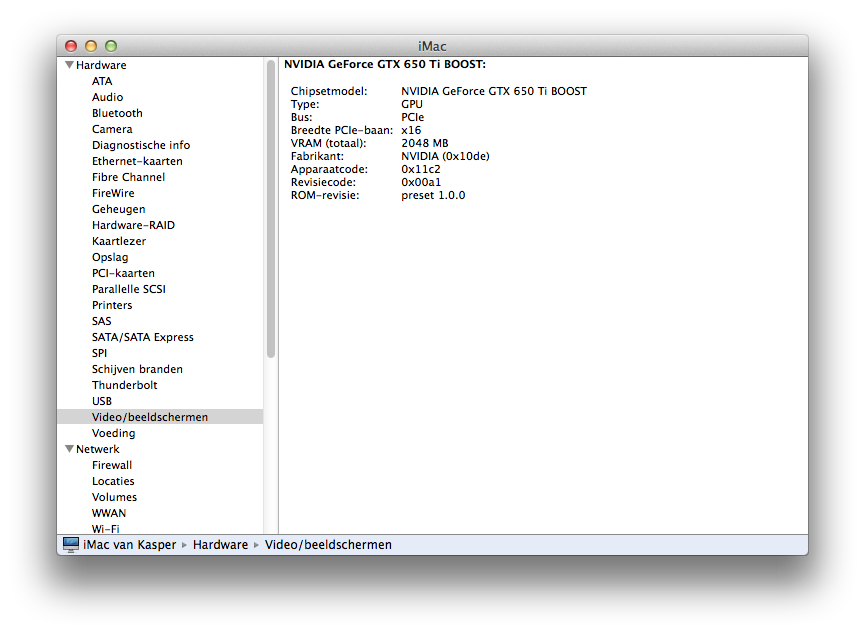

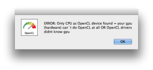

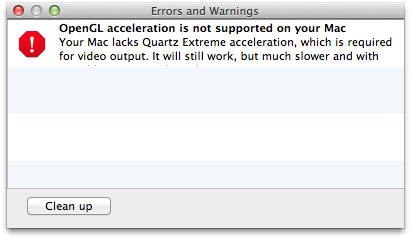

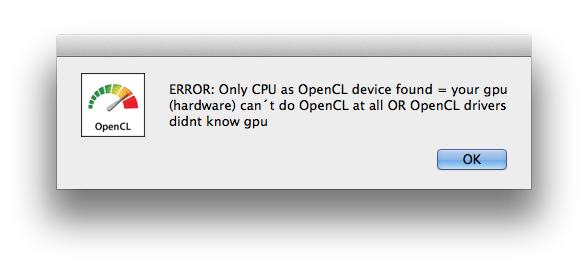

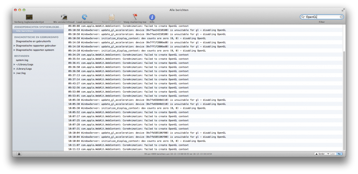

KasperNL Posted December 18, 2013 Share Posted December 18, 2013 It seems that the horrible graphic performance is caused by the fact that none of the accelerations (Quartz Extreme, Core Image, OpenGL, OpenCL) work, see attached screenshots?! Any idea how to fix? Link to comment https://www.insanelymac.com/forum/topic/292483-fixed-nvidia-9400gt-1024mb-on-109-gm/#findComment-1976892 Share on other sites More sharing options...
