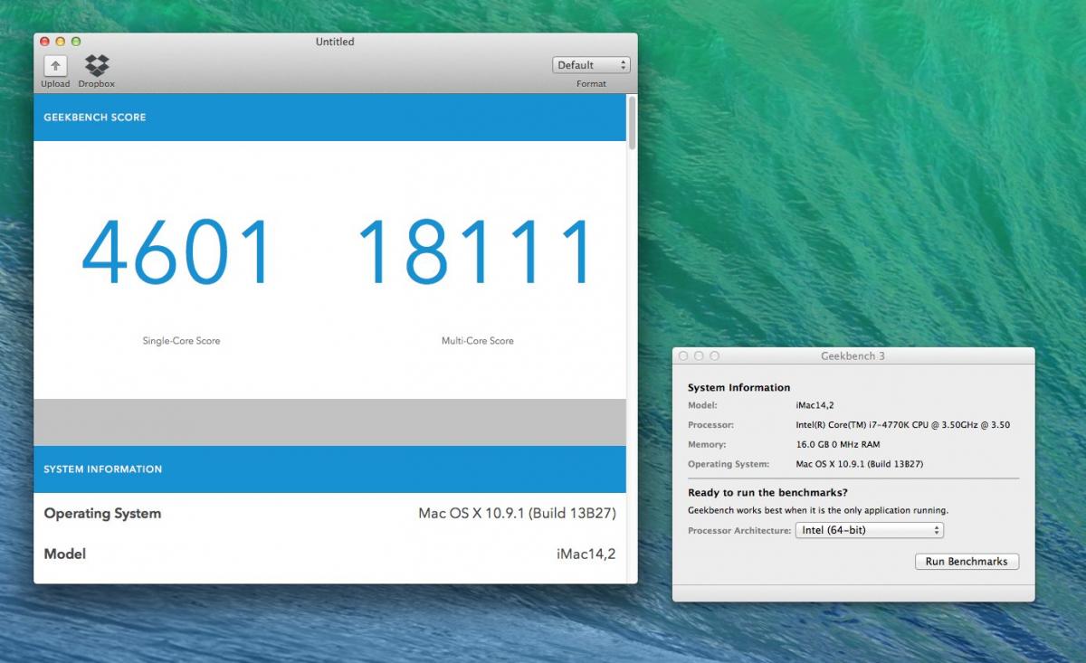

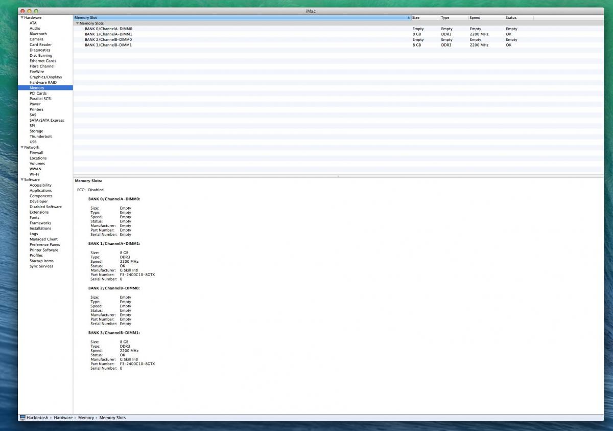

zxv Posted November 22, 2013 Share Posted November 22, 2013 Chiming in as another Z87E-ITX owner. Currently running a fairly fragile OSX 10.9 install (used myHack 3.3.1) on my setup. Loose ends at present: • Used a PMPatched v2.0 of the ASRock BIOS, otherwise OSX fails to boot. Did try using PMPatch v0.5.13 to patch a stock copy of the v2.10 BIOS, but attempting to do so results in segfault 11 as has been mentioned elsewhere. The developer (CodeRush?) says this is an OSX specific issue, but I don't feel like installing Windows to work around it. • Intel HD 4600 doesn't properly initialize (no kext loaded—see screenshot #1). This induces effects like graphical flickering in Safari (but not Chromium). I'm guessing this is due to QE/CI being unable to do proper HW acceleration, etc. • No sound output. Installing the ALC1150 drivers leaves bootup stalled; removing HDAEnabler1.kext from /System/Library/Extensions at least allows for a normal startup. • Quite a few SMC errors are spat out whilst booting. • Plugging in external USB drives after system startup causes kernel panics. • OSX Hardware Profiler reports DIMM A running @ 2400MHz and DIMM B @ 1600MHz (see screenshot #2)… yet in the UEFI both are reported @ 2400MHz. I'm curious if updating to BIOS v2.10 might correct this, but I'm stuck on v2.0 for now given the aforementioned. I think that covers everything thus far. #1 #2 Chameleon Boot plist Hardware: Motherboard: ASRock Z87E-ITX LGA 1150 Intel Z87 HDMI SATA 6Gb/s USB 3.0 Mini ITX Intel I217V Lan 802.11ac WiFi CPU: Intel Core i7-4771 Haswell 3.5GHz (3.9GHz Turbo) LGA 1150 84W Quad-Core Desktop Processor Intel HD Graphics 4600 Memory: G.SKILL Trident X Series 8GB (2 x 4GB) 240-Pin DDR3 SDRAM DDR3 2400 (PC3 19200) Storage: Samsung 840 Pro Series MZ-7PD256BW 2.5" 256GB SATA III MLC Internal SSD Case: Fractal Design Node 304 FD-CA-NODE-304-BL Black Aluminum / Steel Mini-ITX Tower Monitor: LG 22EA53 IPS Link to comment https://www.insanelymac.com/forum/topic/291182-asrock-haswell-anyone/#findComment-1970477 Share on other sites More sharing options...

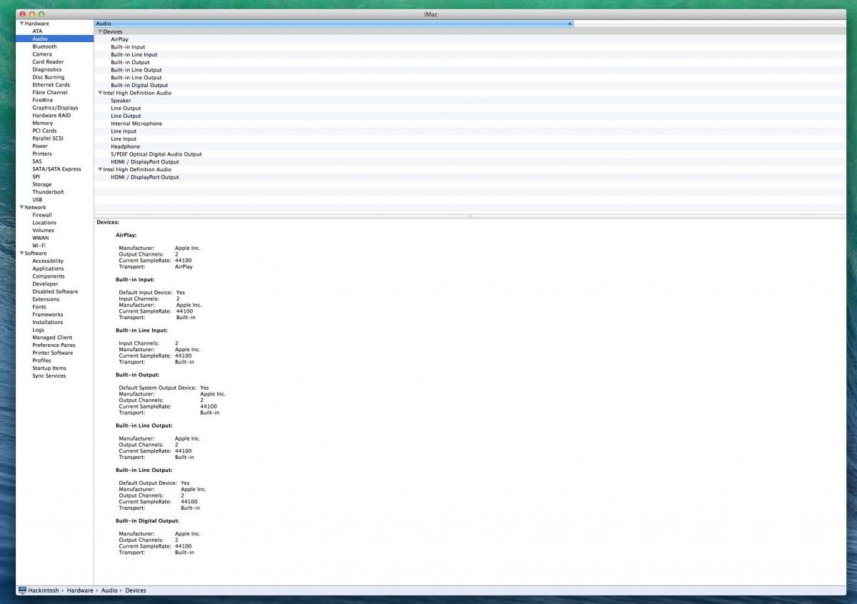

zxv Posted November 25, 2013 Share Posted November 25, 2013 Update:• Apparently OSX10.9 or this mbd (or some combo thereof) strongly dislikes DVI-connected displays; I figured this out on a whim by hooking my computer up to a TV via HDMI—magically, it worked. So I bought a DVI → HDMI adapter and viola, graphical problems resolved (Note: This also required inputting IntelAzulFB=10 in /Extras/org.chameleon.Boot.plist; I assume this is why I was getting a black screen after bootup before when trying Chimera, as it does this automatically). To reiterate: Use anything but the DVI port on this motherboard for connecting a display if you're relying on integrated graphics in OSX10.9, else you'll deal with the same headaches I encountered. The System Profiler:Graphics/Displays panel now appropriately reads like this:• This has resolved sound issues as well; I installed toleda's ALC1150 drivers and they work flawlessly it appears. Link to comment https://www.insanelymac.com/forum/topic/291182-asrock-haswell-anyone/#findComment-1971337 Share on other sites More sharing options...
