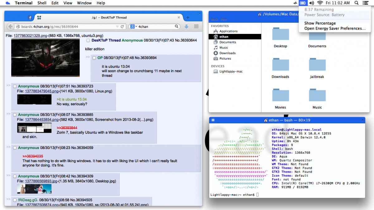

Hows your battery life btw lightskreen? Has it been affected in any way? It might not be a wonky battery meter anymore as from a full charge I am actually getting 4 hours on hd3000 under Windows when I would usually get double, and 3 hours under OSX after rebooting. Could it be the bios? I haven't changed a single thing on my computer except that. The only reason I flashed custom bios in the first place is to increase battery life... Still great work Donovan though :)
Hmmmmmm, my battery life is at 8-9 hours on a 12 cell battery. Laptop's with our specs are real power suckers. Try it with all 4 cores enabled, special graphics off, HT off, and fan always off. Those are the bios settings I use.
