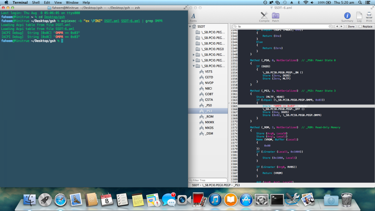

qwerty12 Posted August 8, 2013 Share Posted August 8, 2013 After "fixing" your SSDT-6 so that iasl will actually produce an aml file from the dsl, I put a print statement in the _PS3 method telling me if it's actually going to call _OFF, turning off the card, which would only happen if OMPR equals 0x03. Lo and behold, it does (the first instance of the message is due to being called from _INI and the second from me telling acpiexec to call it again): After looking at your ACPI tables, the *only* way OMPR can be changed is through _DSM (when calling it with the specific arguments that are in the PINI method) and _PS3 itself. OMPR is a named variable; it is not pointing to a register and cannot be changed externally. In addition, it is initialised with 0x02 so _PS3 will not work until the call to _DSM has been made from PINI. This means that the _DSM way is the right way for your laptop because all other ways would've just made _PS3 not call _OFF. (You could, of course, skip _PS3 and call _OFF directly but you don't really want to do that according to Lekensteyn.) I didn't mess up with the External declarations - they are indeed for the right functions in the right place - because acpiexec is finding the _PS3 function fine (and we know it's found _DSM because of OMPR changing). The only reason I can think of as to why it's failing is perhaps SSDT tables are being dropped? 1 Link to comment https://www.insanelymac.com/forum/topic/290743-disable-optimus-on-xps-15-l521x/#findComment-1937491 Share on other sites More sharing options...
