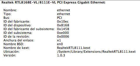

Tested here... and it works fine after warm boot from Win7! Nice work, I think you fixed it... I will now do some more testing (warm boot after Linux, cold boot, etc).
(edit)Tested:
- cold boot to OS X
- cold boot to Windows; warm to OS X
- warm to Windows; warm to OS X
- cold to Linux; warm to OS X
- warm to Linux; warm to OS X
All work: Windows 7, Ubuntu 12.04LTS.
(edit) Got to love that -- one line of code:
   /* Set RxMaxSize register */
   WriteReg16(RxMaxSize, kRxBufferPktSize);
Hi Mieze. Based on RehabMan's test and on some tests here on my ProBook it looks you found the solution. I'll check it later today on my desktop and then we'll celebrate. :)
I can not check it fully on my ProBook because I got another issue. In 90 % of the cases when I start OSX with your driver, Ethernet ends up with "Cable unplugged". I need to reset the router or wait 3-5 minutes until link get's recognised as up and running. See here:

The interrupt for link change just does not get fired when driver is started, but get's fired after router reset or after 3-5 minutes. And then everything will work. This issue does not depend how I start OSX - it happens in any case. Soft/Warm reboot from Windows/OSX/Linux.
I do not remember that I had this issue in my previous tests with earlier driver. But checked that earlier version today, and I have the same issue now. I do not have that issue on my desktop. One difference between RehabMan and me is that he is booting BIOS Chameleon, while I am booting with UEFI Clover. I do not have legacy Chameleon or Clover right now and can not check if the same would happen in that case.
Any idea why I have this issue? Is it possible to trigger link detection early when driver is starting instead of waiting for that interrupt?
Anyway, back to original After-Windows issue. Even with this "router reset" help I have the following situation now:
- older driver versions: boot Windows -> restart into OSX + router reset = net is not working
- new 1.0.3 driver: boot Windows -> restart into OSX + router reset = net IS working!!!

The latest version is working great so far! A bit chatty though :P

26/04/13 09:16:17,000 kernel[0]: Ethernet [RealtekRTL8111]: RTL8168E-VL/8111E-VL: (Chipset 16) at 0xffffff80efc06000, xx:xx:xx:xx:xx:xx
