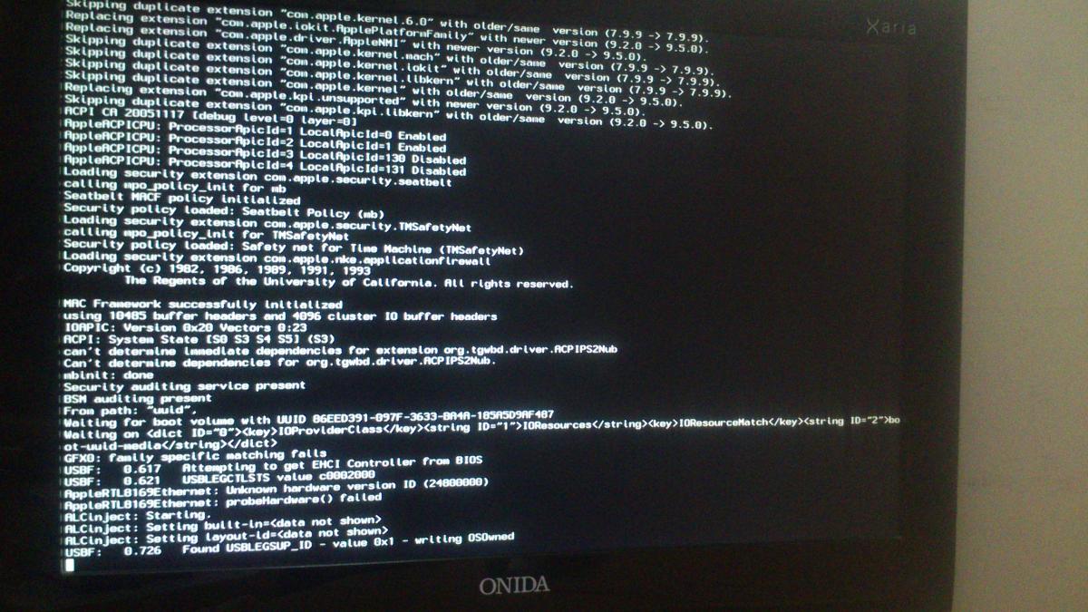

vinayakagarwal6996 Posted March 15, 2013 Share Posted March 15, 2013 system specs: intel pentium e5400 dual core @2.7ghz X86 msi g31tm-p21 (ms-7529) chipset intel p35/g33/g31 no dedicated gpu g31/33 express chipset family ram 2gb ddr2 attached cpu-z spec file i had downloaded this iPC_OSx86_10.5.6 and one given in this page http://olarila.com/f...php?f=27&t=1627 plz help! i am geting error! it restarts at extensions.mkext! plz help! what should i do? i am a noob! thanks already! on tying -v -f -x graphicsenabler=no cpus=1 npci=0*2000 d error in image below ocurs DARKKNIGHT.txt Quote Link to comment https://www.insanelymac.com/forum/topic/287079-need-help-im-noob/ Share on other sites More sharing options...
eep357 Posted March 15, 2013 Share Posted March 15, 2013 Use -f bootflag. G31 onboard gpu may not be supported, is 7300GT? Quote Link to comment https://www.insanelymac.com/forum/topic/287079-need-help-im-noob/#findComment-1897016 Share on other sites More sharing options...

3.14r2 Posted March 15, 2013 Share Posted March 15, 2013 The problem with G31 (as well as with G41) is the on board graphics. Most G31 boards have GMA 3100 (not GMA X3100 which is supported), G41 has GMA X4500. Both ARE NOT supported in OS X. Period. You have to use a discrete vga card (GF G210 as the cheapest option around 30EUR locally). Or buy a used one 8800GTX/GT. 1 Quote Link to comment https://www.insanelymac.com/forum/topic/287079-need-help-im-noob/#findComment-1897079 Share on other sites More sharing options...
vinayakagarwal6996 Posted March 15, 2013 Author Share Posted March 15, 2013 The problem with G31 (as well as with G41) is the on board graphics. Most G31 boards have GMA 3100 (not GMA X3100 which is supported), G41 has GMA X4500. Both ARE NOT supported in OS X. Period. You have to use a discrete vga card (GF G210 as the cheapest option around 30EUR locally). Or buy a used one 8800GTX/GT. thx but i wont be allowed to buy it until next year! Quote Link to comment https://www.insanelymac.com/forum/topic/287079-need-help-im-noob/#findComment-1897087 Share on other sites More sharing options...
theconnactic Posted March 15, 2013 Share Posted March 15, 2013 From an ex-GMA3150 user: don't waste your time. Buy the discrete card (a HD5450 also will do): there's no solution when the chipset of the card is not supported. Unlike Linux, graphics drivers in OSX are not open source and there's little we can do. I was a noob once (not so long ago, hehehe) and when i was confronted with answers like that, i'd hope it was an inaccurate one. That's not the case here: if we could help you with your card, we would, but in this case there's no hope at all. All the best! Quote Link to comment https://www.insanelymac.com/forum/topic/287079-need-help-im-noob/#findComment-1897202 Share on other sites More sharing options...
