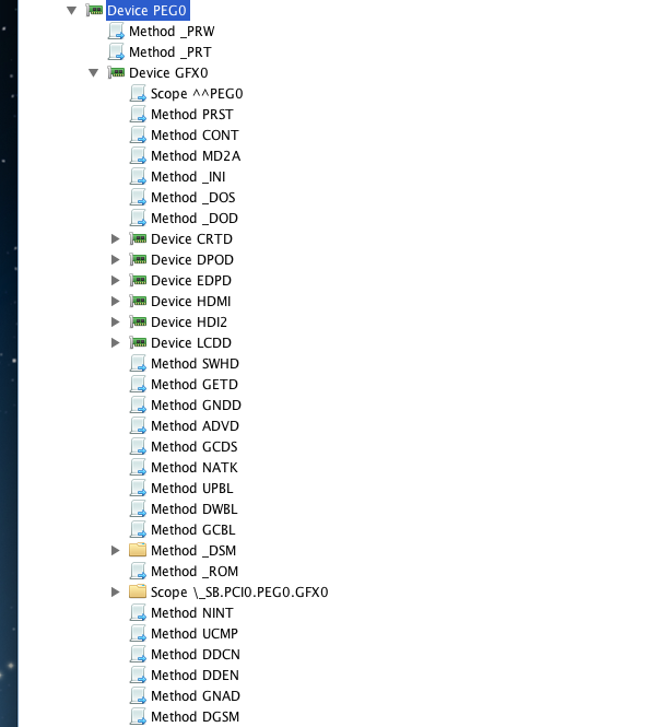

NiPeGun Posted December 9, 2013 Share Posted December 9, 2013 The code we need to solve is in the attached picture. We need to figure out which part of the code on that picture is making NVDAResman to fail. First we need to solve is what type of hardware is each device inside GFX0. There are several: CRTD (I assume CRT monitor??) DPOD EDPD HDMI (HDMI audio out ?? or conector HDMI ivdeo??) HDI2 ??? LCDD (The display of the notebook??) Link to comment https://www.insanelymac.com/forum/topic/285978-asus-g75vx-mountain-lion/page/6/#findComment-1974612 Share on other sites More sharing options...
NiPeGun Posted December 17, 2013 Share Posted December 17, 2013 @Styrian, the NVCAP extracted from my VBIOS rom is 0400000000000100020000000000000700000000 Link to comment https://www.insanelymac.com/forum/topic/285978-asus-g75vx-mountain-lion/page/6/#findComment-1976582 Share on other sites More sharing options...
styrian Posted December 17, 2013 Share Posted December 17, 2013 Looks good. Try to to compare it with the value you can find in the Ioreg after booting with GE=Yes/No. If it has not the same value in ioreg, the try to inject your extracted value in the org.chameleon.boot.plist. Perhaps, this is then changing something. Have fun. Link to comment https://www.insanelymac.com/forum/topic/285978-asus-g75vx-mountain-lion/page/6/#findComment-1976649 Share on other sites More sharing options...
NiPeGun Posted December 18, 2013 Share Posted December 18, 2013 Well, maybe we are now on the right track. Without NVDAResman.kext both NVCAP with GE=Yes and GE=No are different to original NVCAP extracted from rom. Being: Original NVCAP from rom = A NVCAP with GE = B NVCAP without GE = C All of them different Link to comment https://www.insanelymac.com/forum/topic/285978-asus-g75vx-mountain-lion/page/6/#findComment-1976916 Share on other sites More sharing options...

Rikoshet Posted April 14, 2014 Share Posted April 14, 2014 Hi NiPeGun! How did you extract NVCAP? I have problem to find a solution for this! I have a similar problem, no acceleration on quadro k4000m, and I descover an intresting thig that may be can help you! Do you know how your internal LCD is connected to geforce? iMac and macbookpros uses eDP, but mine uses internal LVDS, so I must find my NVCAP and inject it. eDP is used to connect geforce to IPS or 3D lcd so if you have one of this may be yor problem is diferent... Link to comment https://www.insanelymac.com/forum/topic/285978-asus-g75vx-mountain-lion/page/6/#findComment-2012624 Share on other sites More sharing options...
beton3009 Posted April 15, 2014 Share Posted April 15, 2014 hello i am in the same situation and nipgun has changed his lapy with g750 Lucky i have efi string and i inject nvcap in it Link to comment https://www.insanelymac.com/forum/topic/285978-asus-g75vx-mountain-lion/page/6/#findComment-2012915 Share on other sites More sharing options...
