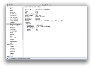

Zackptg5 Posted July 25, 2013 Share Posted July 25, 2013 *Edit* I've been following the guide at ####### with some edits of my own since the mountain lion kexts differ slightly from the lion ones used in the guide. So far, I've gotten mac to recognize my graphics card (all 3 gb's of it) but still no graphics acceleration. I believe that's because this graphics card isn't supported by mac. A picture of the display properties is attached. Edit 2: Before I inject my graphics card properties into chameleon, it shows up under pci cards in the system information app. However, after I inject the graphics card properties, the system information app says no pci cards detected. Link to comment https://www.insanelymac.com/forum/topic/285978-asus-g75vx-mountain-lion/#findComment-1934477 Share on other sites More sharing options...
Zackptg5 Posted July 25, 2013 Share Posted July 25, 2013 It seems that I can inject whatever I want into chameleon for the graphics card and the system profiler will display whatever, but still no actual graphics acceleration However, I did find the kext for the wireless card (BCM4352) and bluetooth from osxlatitude. I uploaded it here: http://www.osx86.net/downloads.php?do=file&id=4047 The wifi works like a charm but the bluetooth is still a no go. Link to comment https://www.insanelymac.com/forum/topic/285978-asus-g75vx-mountain-lion/#findComment-1934502 Share on other sites More sharing options...
Zackptg5 Posted July 25, 2013 Share Posted July 25, 2013 After some failed attempts at editing the nvidia kexts, it seems that the best route is to just put in the id's for my 670mx and not another one. Unfortunately, in order for me to get graphics accel, I need nvdaresman. So until there's an update with fakesmc it looks like there won't be any graphics acceleration Link to comment https://www.insanelymac.com/forum/topic/285978-asus-g75vx-mountain-lion/#findComment-1934605 Share on other sites More sharing options...
