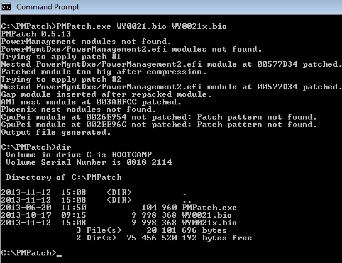

jeep_ Posted November 15, 2013 Share Posted November 15, 2013 Is there something that I can do to investigate what is happening when I am trying to flash BIOS on Intel NUC D54250WYK. On a Mac there is no output file: $ sudo ./PMPatch WY0021.BIO WY0021i5.BIO Password: PMPatch 0.5.13PowerManagement modules not found. PowerMgmtDxe/PowerManagement2.efi modules not found. Trying to apply patch #1 Nested PowerMgmtDxe/PowerManagement2.efi module at 00577D34 patched. With Windows there is a output file: http://www.tonymacx86.com/hardware-parts/110898-haswell-nuc-technical-specs.html#post704656 When trying to flash, the NUC just reboots. WY0021x.bio.zip Link to comment https://www.insanelymac.com/forum/topic/285444-uefipatch-uefi-patching-utility/page/38/#findComment-1968065 Share on other sites More sharing options...
CodeRush Posted November 15, 2013 Author Share Posted November 15, 2013 SENTRy_SD, you shall not use FTK on non-ASUS boards, please use dump/patch/reflash strategy and external SPI-programmer, if possible. HP BIOSes are protected with digital signatures and therefore very hard to flash. jeep_, same sh*t, different vendor. Look up in this topic, there was an example of successfull Intel flashing using RaspberryPi as external SPI flasher. Link to comment https://www.insanelymac.com/forum/topic/285444-uefipatch-uefi-patching-utility/page/38/#findComment-1968169 Share on other sites More sharing options...
