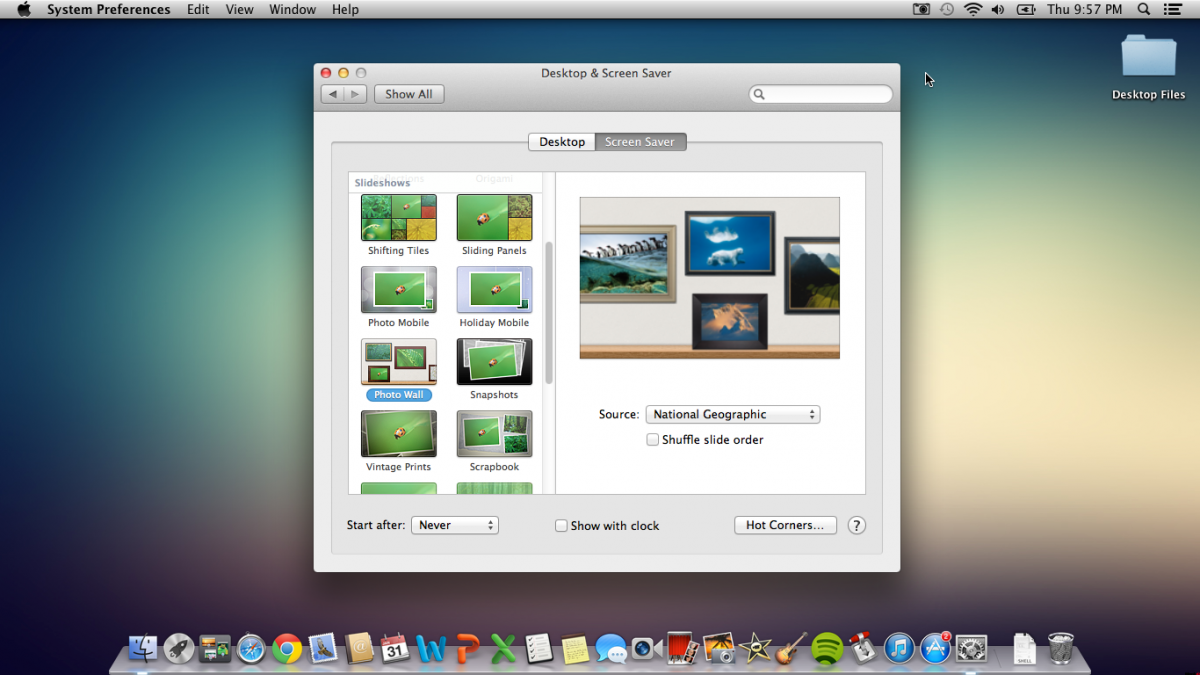

GhostRaider Posted January 12, 2013 Share Posted January 12, 2013 I don't know much about the AppleIntelHDGraphics kexts (or kexts in general), except for that I have to delete them to make my system work :-) At the moment I'm using natit.kext which at least makes my screensaver work and probably some other stuff. Definitely not hardware accelerated. Natit/Titan are not drivers and only written to enable NVIDIA and ATI cards by manipulating the registry. It seems the project dates from 2006 but no development has been done since? It might be possible to add support for INTEL cards, the fact that my screensaver is working with it indicates that at least something can be achieved! Any thoughts? Is it only the Flurry screensaver? I don't use Natit and I'm still able to use that screensaver. There is something called Apple Software Renderer and can be seen when using the OpenGL Extension Viewer. I think this is what Flurry is using to display its effects. I believe the other slideshow screensavers use Core Image because I can't use them. They're black. As for Natit, I'm not really sure it would do anything for us. The only thing it does is that it identifies the Intel HD Graphics and displays its information in System Information. Its only adds cosmetic detail. I feel that the main problem is not the AppleIntelHDGraphics kexts itself. I've compared those same kexts with Snow Leopard and they're all the same. Only minor verison differences. As you can see, you can't even get partial QE/CI in Lion nor in Mountain Lion, but you can in Snow Leopard. Not sure what kext is causing the issue. Link to comment https://www.insanelymac.com/forum/topic/285362-guide-how-to-enable-custom-resolution-for-first-gen-intel-hd-graphics-00428086-and-00468086/page/2/#findComment-1879995 Share on other sites More sharing options...
RemC Posted January 12, 2013 Share Posted January 12, 2013 Yes it is the Flurry screensaver, but without natit.kext I just get a white screen... I've been reading the https://www.google.ca/url?sa=t&rct=j&q=&esrc=s&source=web&cd=1&cad=rja&ved=0CC4QFjAA&url=http%3A%2F%2Fwww.insanelymac.com%2Fforum%2Ftopic%2F284096-intel-hd-graphics-0x00468086-qeci-on-lenovo-x201%2F&ei=As3wUMTkOIWFiALNrIDwCw&usg=AFQjCNFot9OVtIGrx7FTFfN8CqOMcDyZRQ&bvm=bv.1357700187,d.cGE topic and it looks like it should be possible without to much effort. Some DSDT editing at least it seems. Link to comment https://www.insanelymac.com/forum/topic/285362-guide-how-to-enable-custom-resolution-for-first-gen-intel-hd-graphics-00428086-and-00468086/page/2/#findComment-1880001 Share on other sites More sharing options...
iWin32 Posted January 13, 2013 Author Share Posted January 13, 2013 Is it only the Flurry screensaver? I don't use Natit and I'm still able to use that screensaver. There is something called Apple Software Renderer and can be seen when using the OpenGL Extension Viewer. I think this is what Flurry is using to display its effects. I believe the other slideshow screensavers use Core Image because I can't use them. They're black. As for Natit, I'm not really sure it would do anything for us. The only thing it does is that it identifies the Intel HD Graphics and displays its information in System Information. Its only adds cosmetic detail. I feel that the main problem is not the AppleIntelHDGraphics kexts itself. I've compared those same kexts with Snow Leopard and they're all the same. Only minor verison differences. As you can see, you can't even get partial QE/CI in Lion nor in Mountain Lion, but you can in Snow Leopard. Not sure what kext is causing the issue. I'm thinking it's a kernel issue for ML. For me, I can enable QE/CI as the guides say that I've linked to in OP, but when the Framebuffer Kext loads in Snow Leopard, I get the backlight/blank screen issue. However, when I use the kexts from Snow Leopard that enabled QE/CI on ML, I get a distorted and unusable screen, and it's like that also from VNC. If I load any framebuffer kext, the screen freezes in verbose mode, and when it exits, the screen becomes white. A few seconds later, the fans go crazy on my machine, and the system becomes unresponsive (I cannot connect to VNC at all). I'm thinking that Snow Leopard (as of now) is the best for acceleration until we work out what's going on in Mountain Lion. I plan to back up my Mountain Lion installation to an external drive, and then put Snow Leopard back on my internal drive. And as far as the Lenovo thread goes, either the framebuffer can pick up the LCD completely without any of our issues, or the OP found out some Apple OS-Info Values that make it work, but we don't know how to retrieve those values for us. Therefore, we can't make it work. I may start another thread on trying to enable QE/CI in ML on the Hardware -> Graphics Card forum, and when that happens, I'd prefer all acceleration discussion to take place in that thread and keep all resolution discussion in this thread. Link to comment https://www.insanelymac.com/forum/topic/285362-guide-how-to-enable-custom-resolution-for-first-gen-intel-hd-graphics-00428086-and-00468086/page/2/#findComment-1880445 Share on other sites More sharing options...
