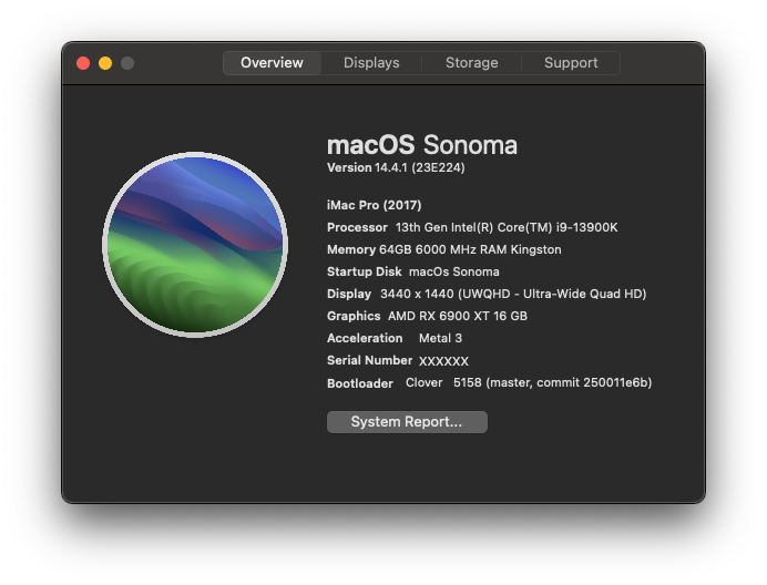

"Bootloader Apple UEFI"
About this Hack from 0xCUB3's github Repo
https://github.com/0xCUB3/About-This-Hack
@datafeedexpert You're reporting in the CLOVER thread, but this indicates that ""Apple UEFI" shows up as the bootloader when NOT using OpenCore/Clover ".  Is this a bug in About this Hack?  Or maybe About This Hack is not recognizing the new CLOVER (because something's wrong with the new CLOVER identification)?
EDIT: Just read your response and see that CLOVER is shown in your System Profiler screenshot.  Clearly an 0XCUB version bug.
Edited by deeveedee
There is a 3 Versions of AboutThisHack 1 From matxpa 2 From Slice 3 From 0XCUB , Slice's build shows Clover as Boot Loader , 0XCUB's version shows AppleUEFI when using clover, While 0XCUB's AboutThisHack shows Opencore Versions Perfectly...
i also posted a screenshot of System Profiler where Clovers Build shows perfectly so don't worry about 0xCUB's AboutThisHack's Bug

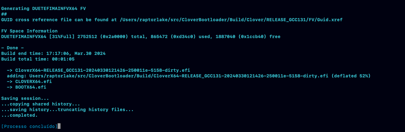

Hi @Slice im run this command above and add your command and fix GCC build
All suffering to build on Sonoma has gone
Oh my Gosh
hehehehehehehe
mkdir -p $HOME/src && cd $HOME/src
git clone -q https://github.com/CloverHackyColor/CloverBootloader
cd CloverBootloader && git submodule update --init --recursive
cd OpenCorePkg && git checkout master && git pull
cd ..
./build_gcc13.sh
After that build and compile with GCC 13.2 normally
Thanks all
Thanks my GOD!!
15 minutes ago, Slice said:
I also tested
./ebuild.sh -xcode15
also success
Build total time: 00:02:34
I updated my Xcode just today and have a version 15.3.
Clover, created by gcc13 has a size 1.6Mb while created by xcode has a size 1.8Mb.
Yes it is, with GCC is 1.6 mb :thumbsup_anim:

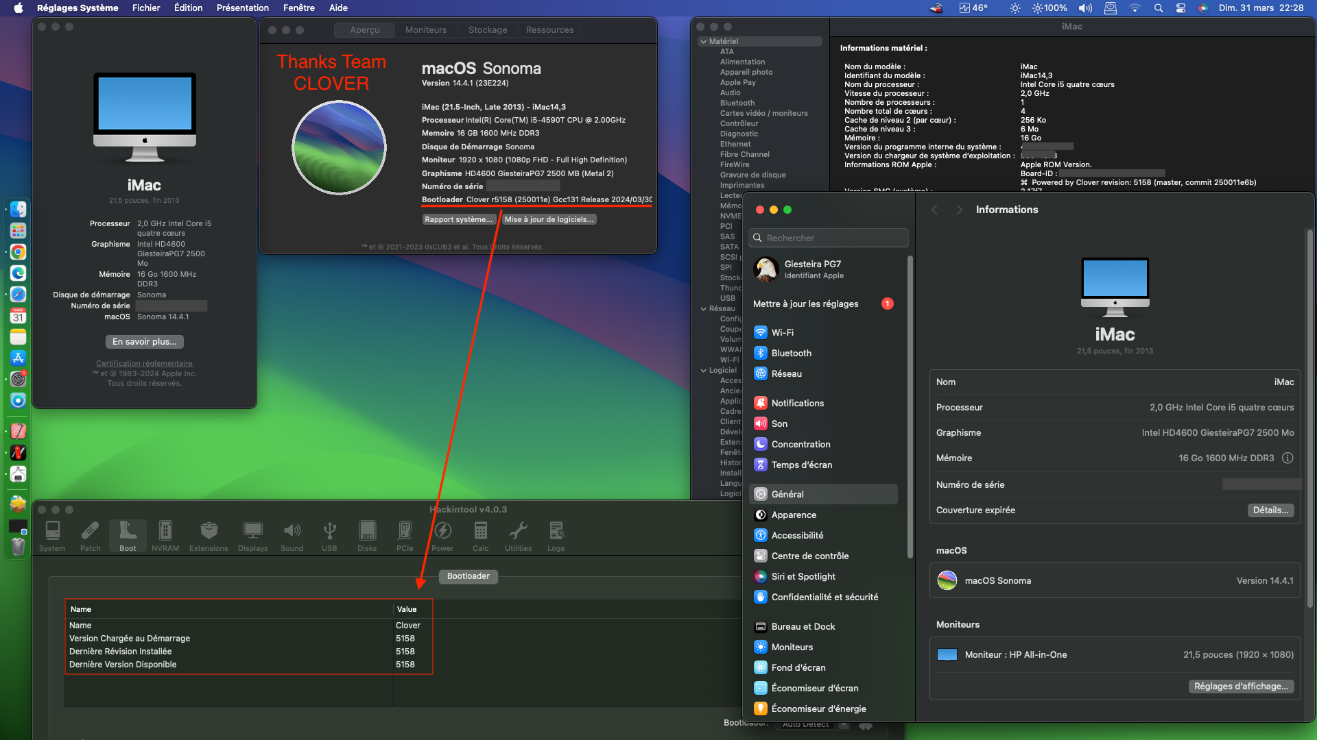

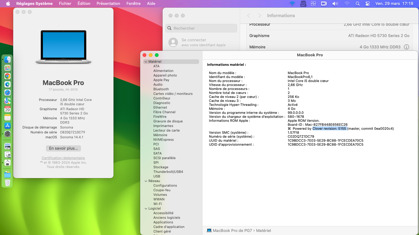

Il y a 14 heures, Slice a dit :
Comment avez-vous fait fonctionner la Radeon HD5730 dans Sonoma ? C'est impossible!
Impossible Non !
video
Sonoma 14.4.1

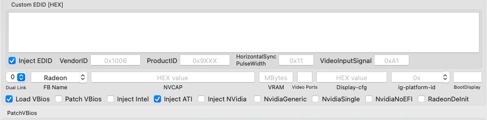

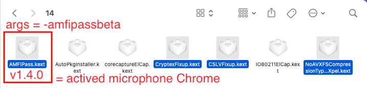

Clover r5155
Asus A42j
i5 M480
Ati Radeon Series 5730 2go memory Graphics
4 go Memrory 1333mghz
SSD Sandisk 250go
patch Clover + OCLP
- 10.13 High Sierra, Sierra, El Capitan... = patch Clover Native system
- 10.14 Mojave = patch Clover + OCLP maxi 0.2.5 TUI
- 10.15 Catalina = patch Clover + OCLP maxi 0.2.5 TUI
- 11 Big Sur = patch Clover + OCLP
- 12 Monterey = patch Clover + OCLP
- 13 Ventura = patch Clover + OCLP
- 14 Sonoma = patch Clover + OCLP
Divulgacher
Patch Clover
ATI Radeon Series 5730 2go mémoire Graphique
Capturedecran2024-04-01a21_45_54.png.71a796a99300db473ccb5188dd90080d.pngCapturedecran2024-04-01a21_45_23.png.bcc88183621747b83b2c28e8bf4972b0.pngCapturedecran2024-04-01a21_45_00.png.0a9565c2995e887623ad2dbf98eafbd9.png
Il y a 11 heures, Stefanalmare a dit :
Il s'agit de TeraScale 2, couvert par OCLP.
Oui TeraScale2 OCLP v1.4.x activé

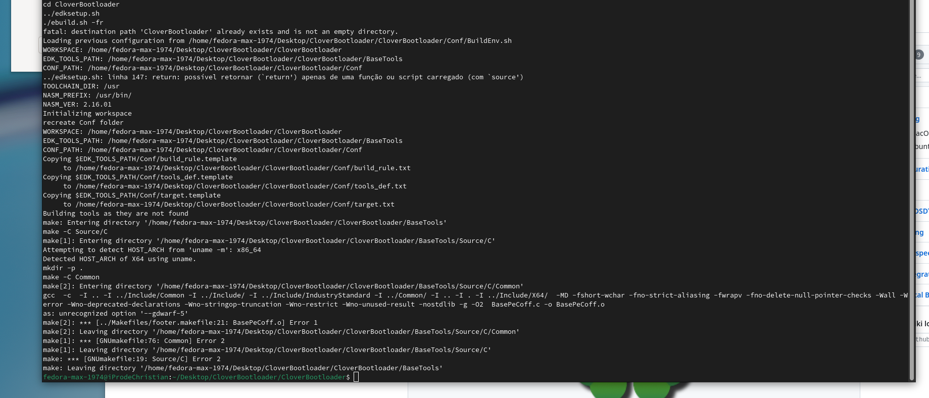

Hi @Slice  and all my dear friends
I apologize for asking, but would it be possible to give us some help on how to use the compiler packages for Clover on the Linux system?
I tried using Ubuntu but without success.
The most user-friendly system for this was Fedora 39 Workstation, however, it asks for several packages, which I install GCC, and various updates, but it gives us this error in the attached print
I almost managed to compile, it gives the same error as newer Xcodes.
I ask if you know about this, because apparently it could be interesting to compile Clover on Linux hardware.
And I would like to know if there is a specific folder where we can install the packs or whatever is possible, since it seems to me (I'm not an advanced user) that Clover is built from virtualization in RAM or something similar.
If you can or if you have a chain of commands of what I need to install and where to place or download the packages, I would greatly appreciate it.
I'm struggling a little but I believe I will only progress with your knowledge.
Thanks!
@Max.1974,
I see an error during base tools compilation. It is almost not my affair. You should ask Tiano developers for this issue.
https://github.com/tianocore/edk2
May be Fedora requires additional tuning IDK.
