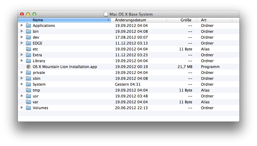

styrian Posted December 14, 2012 Author Share Posted December 14, 2012 Hello TFX! After some sleepless nights :wink2: and I have been able to reproduce your "Transcript Offline - Buffer Pool Allocate [181000] failed [AGPN Controller] unknownPlatform" error. This happens, if Chameleon can not find the Extra folder and in it the correct SMBios.plist. Then AppleIntelSNBGraphicsFB.kext fails to load and causes this error. Please check that the root ( primary folder tree) of your usb install device looks like this: Here has the Extra folder to be placed. If this tree is correct, than the AppleIntelSNBGraphicsFB.kext is at the moment not compatible with your system and can therefore not load. Solutions: Above folder tree is not correct: Correct it, install back my patched AppleIntelSNBGraphicsFB.kext to S/L/E with KextWizard and repair permissons and update caches. Do an new install on your hd. You should have, if it is possibel, at least two partions (one for install and one for rescue) on it, formated with HFS extended journaled. About 25 Gig´s should bee enough for trying and the first time. Therfore you can follow my guide once again. Above folder tree is correct: Boot with your installer, fire up terminal and run the following commands: cd /volumes/ml/sytem/library/extensions ls rm -rf (Scroll up to AppleIntelSNBGraphicsFB.kext, do copy an paste of your choice, an then press Enter) ls (control if the kext is deleted) Close terminal and reboot with your USB Installer to your hd install (options -v -f). Follow my guide til step 12. Install the kexts from Folder Edge/Postinstall/Extensions. But do not install my DSDT.aml at this Moment. After a reboot BatteryIndicator should be working and in systemProfiler you should see partial listed CX 20590 (your audio device, 20671 are outputs of this device). Install your ethernet kext and set in org.Chamelonbootplist the EthernetBuiltin key to yes. If you have a spare partion, clone your install before continuing it. After cloning and installing chameleon to your clone, try my new version of my DSDT. aml from the attachment. (Audio should work for you.) You should not remove the nullcpupowermangement.kext before your gfx is fully working. At this moment you have only a resolution of 1024 x 768 without QE/CI. Search for "ccc mac" to download CarboncopyCloner to clone your install. If there are warnings during cloning, they are just to ignore. I hope this helps you to solve your issues. Have fun. DSDT.aml.zip Link to comment https://www.insanelymac.com/forum/topic/284301-guide-mountain-lion-10-82-vanilla-install-on-lenovo-edge-e320/#findComment-1873607 Share on other sites More sharing options...
TFX Posted December 15, 2012 Share Posted December 15, 2012 Yes, I have checked that the folder tree is correct. Removing the AppleIntelSNBGraphicsFB.kext successfully brings a display back to the machine. I can proceed through the ML setup and install the postinstall kexts. However, after applying your new DSDT, ML can no longer detect my battery – says no battery installed whereas before the DSDT, system profiler could pull up a heap of info about my battery. Audio works! Yay! Perhaps you could outline how you created that DSDT and I could try the same with the DSDT I extract from my machine? I haven’t attempted to install Lnx2Mac’s Realtek driver; I don’t think RTL8167 is supported, but I’m not too bothered by that for now. If everything else works, I may just invest in a supported wifi card. Link to comment https://www.insanelymac.com/forum/topic/284301-guide-mountain-lion-10-82-vanilla-install-on-lenovo-edge-e320/#findComment-1873723 Share on other sites More sharing options...
