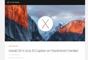

Elad Nava Posted November 10, 2012 Share Posted November 10, 2012 Update: macOS Sierra 10.12.4 version available here. Hi fellow mainboard users,I'd like to share my success story of installing El Capitan (10.11.1) on this incredibly cheap but powerful motherboard. I wrote an extremely detailed guide (applicable to noobs as well) for installing El Capitan on Hackintosh, check it out! Link to the full guide: http://eladnava.com/install-os-x-10-11-el-capitan-on-hackintosh-vanilla/ Audio Getting the on-board ALC 887 (0x10ec0887) to work in El Capitan is tricky, but I was able to do it by trying lots of kexts and scripts, until I found a combination of 2 that worked: 1. HDEnabler1.kext - by toleda (https://github.com/toleda/audio_kext_enabler) 2. audio_cloverALC-110.command - by toleda (https://github.com/toleda/audio_CloverALC) The HDAEnabler1.kext can be copied safely to EFI/Clover/kexts/10.11/. The audio_cloverALC-110.command needs to be run (after mounting the EFI partition via diskutil) and the correct Audio_ID for our ALC 887 is 1. Note that you will need to go into the System Preferneces -> Sound -> Output and select the hardware device for this to work! Both files are attached. Networking The on-board RTL 8169 ethernet controller works great after installing the attached Ethernet-RTGNICv2.0.6For10.7.mpkg. Graphics Depends on your card. In my case, the GTX 650 worked out of the box (without graphics injection or what-not) with QE/CI support. AsusP8H61-M-LX-R2.0-ElCapitan.zip 2 Link to comment https://www.insanelymac.com/forum/topic/284275-asus-p8h61-m-lx-r20-el-capitan-10111-100-working/ Share on other sites More sharing options...
