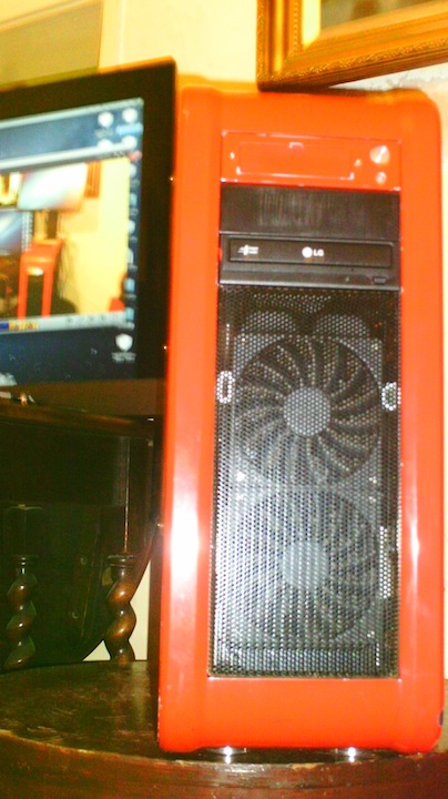

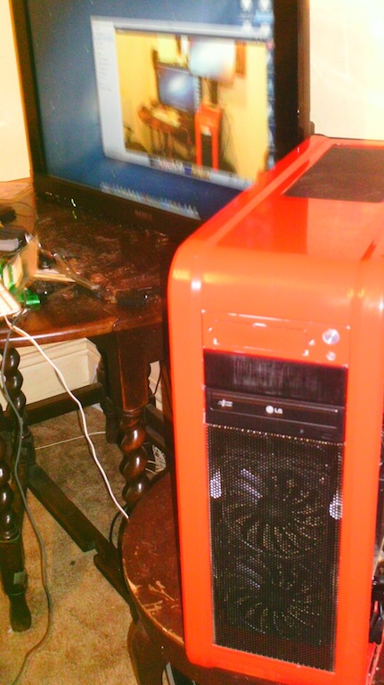

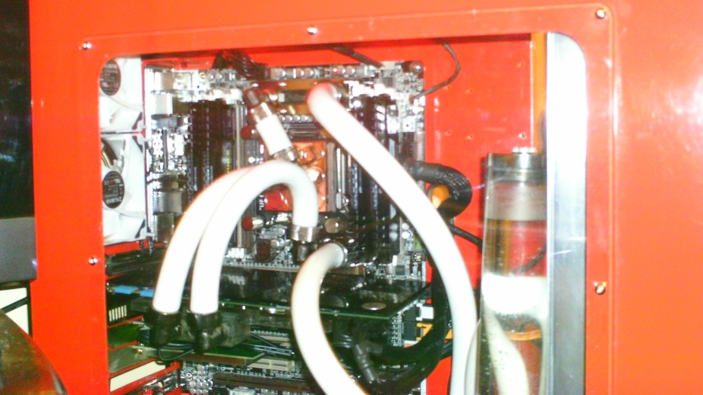

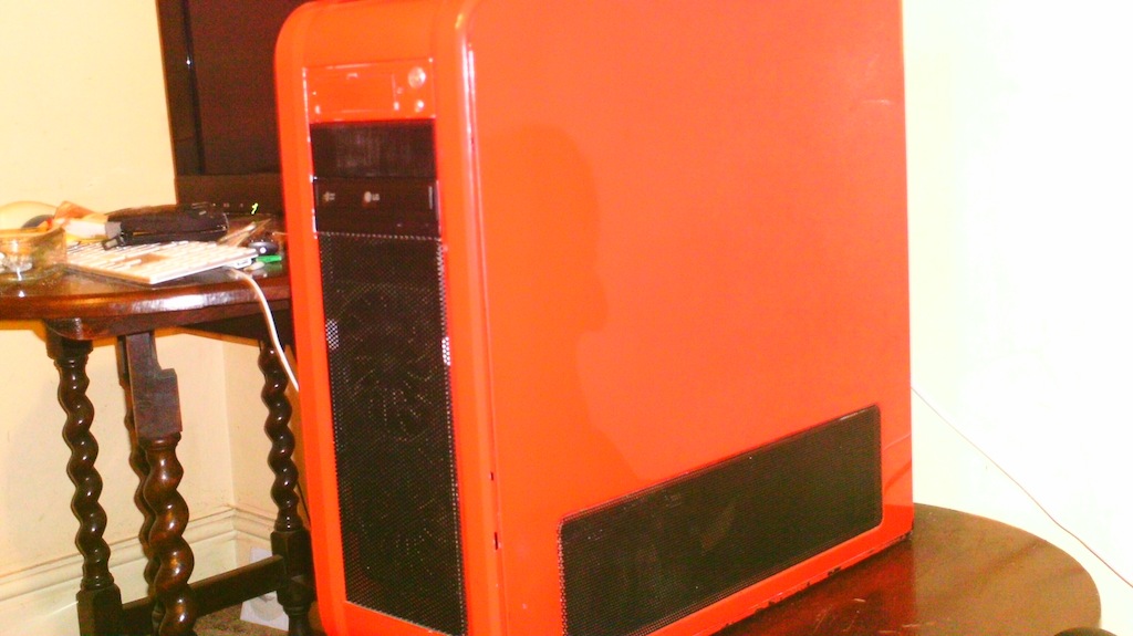

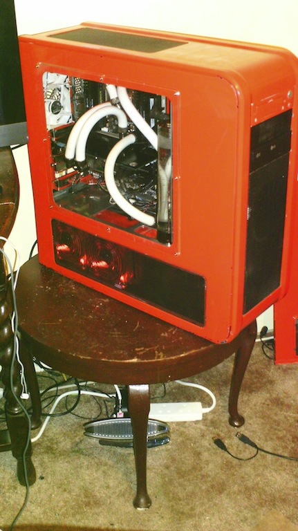

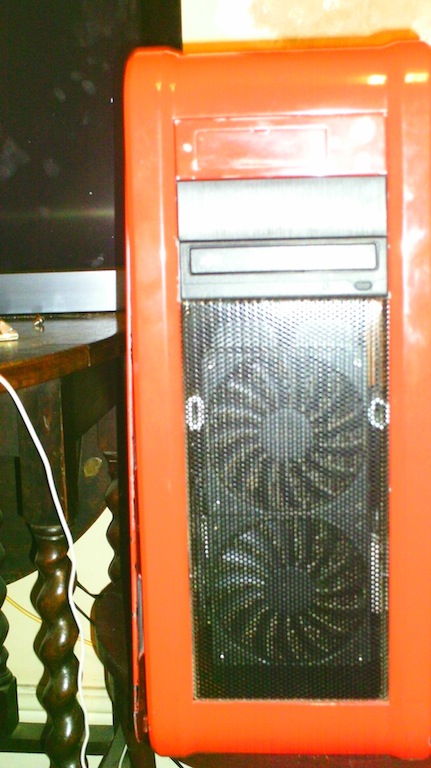

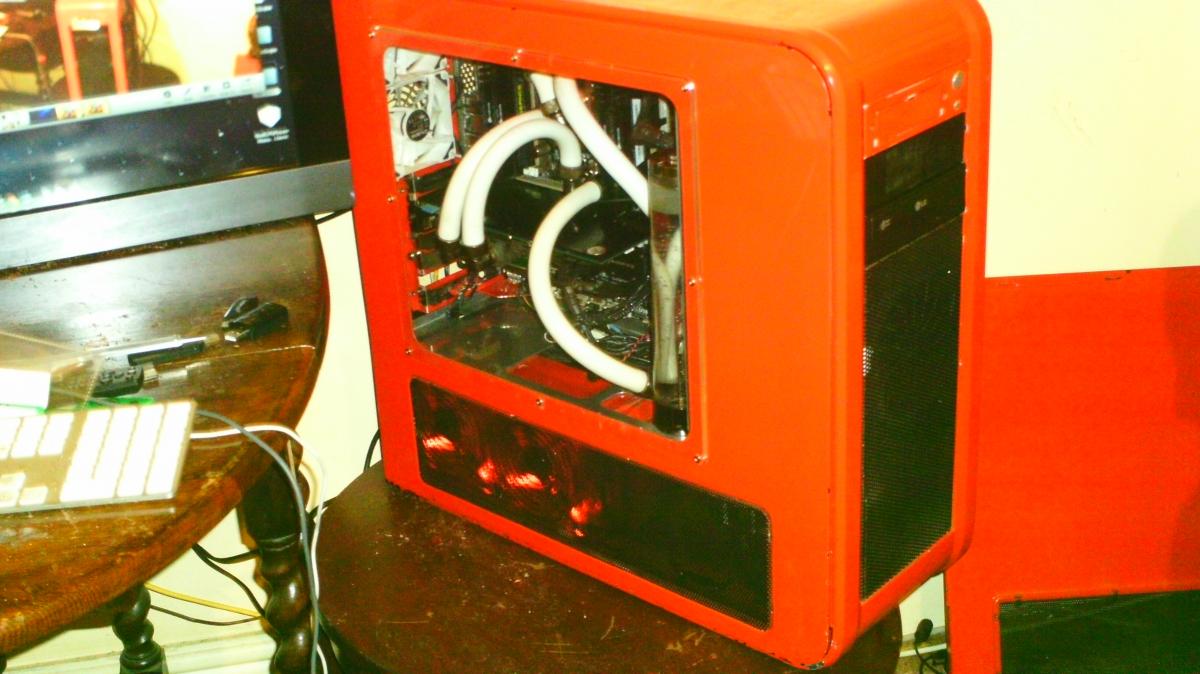

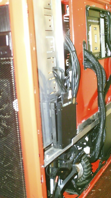

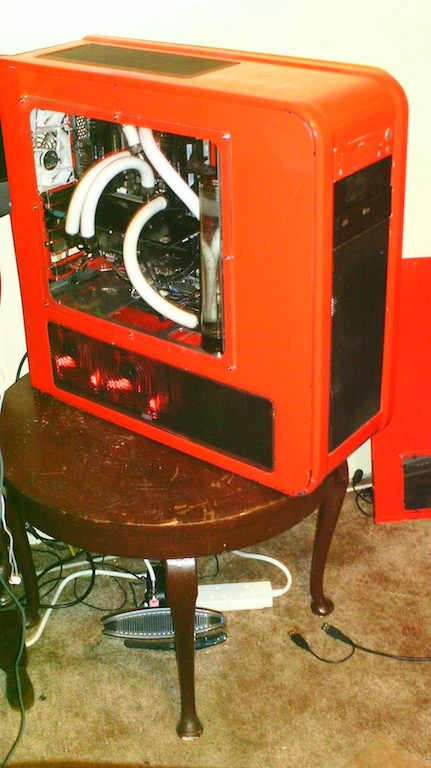

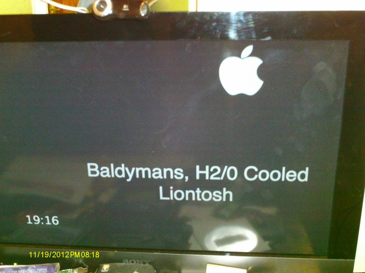

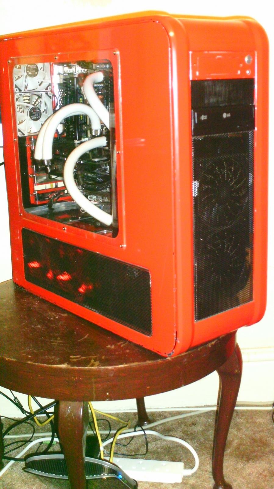

BALDY_MAN Posted November 8, 2012 Share Posted November 8, 2012 just a taste. more photos to come ok just downsized pics. what i did made a mountain lion in snow leopard as you have the choose to a you boot loader to your usb stick in usb extras folder put. fake smc kext voodooTSsync kext null power management kext Ahci extended injector kext bootloader i used chamelion 2069 setting in chamelion were. BOOTLOADER STANDERD ETHERNET BUILT IN =YES KERNEL FLAGS npci=0x2000 THEMES Standard booted into usb install with -v cpus=1 on restart boot -v cpus=1 then add bootloader to install and kext with kext wizzard Just a bit of info about my build Case:Silverstone TJ07. modified (cut out front panal custom made front mesh fitted 240mm EK Rad fitted with two synth slimline 120mm fans cut out base plate custom cutouts on motherboard tray for cable management. made mountings for thermochill 240mm in the base of case new powder coated backplate. sanded down and polished power button moved to singel drive bay with audio and 4 usb ports. paint work by me 6 coats rubbed down and polished COOLING: Cpu EK Supreme Chipset blocks from Koolance 680GTX Graphics card block by EK 150mm phyba res D5 Swifttec pump compresion fittings 19mm o/d white tubing LATEST GEEK BENCH SCORE http://browser.prima...kbench2/1324763 NEW BENCKMARK SCORES 28/12/12 http-::browser.primatelabs.com:geekbench2:1460670 Link to comment https://www.insanelymac.com/forum/topic/284235-sabertooth-x79-hackintosh-build/ Share on other sites More sharing options...
