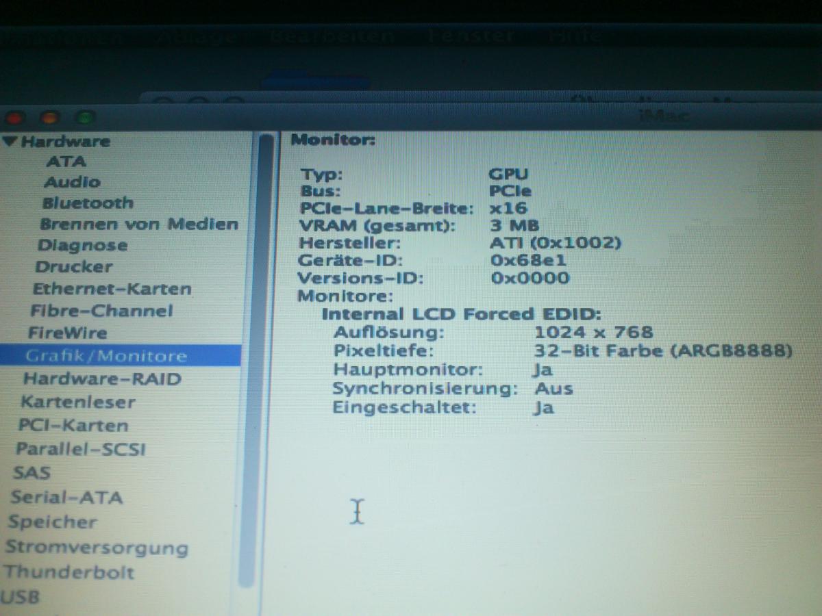

Kasi99 Posted September 24, 2012 Author Share Posted September 24, 2012 hello, my id´s ati 5430, look screen short! i have id´s in the kext registered (Apple Stock Kext ML 10.8) i have edit plist (AMDRadeonAccelerator): <key>AMDBartsGraphicsAccelerator</key> <key>IOPCIMatch</key> <string>0x68e11002 0x67391002 0x67201002 0x67221002</string> <key>AMDCaicosGraphicsAccelerator</key> <key>IOPCIMatch</key> <string>0x68e11002 0x67701002 0x67791002 0x67601002 0x67611002</string> <key>AMDCaymanGraphicsAccelerator</key> <key>IOPCIMatch</key> <string>0x68e11002 0x67191002 0x67041002</string> <key>AMDCedarGraphicsAccelerator</key> <key>IOPCIMatch</key> <string>0x68E11002</string> <key>AMDCypressGraphicsAccelerator</key> <key>IOPCIMatch</key> <string>0x68e11002 0x68991002</string> <key>AMDJuniperGraphicsAccelerator</key> <key>IOPCIMatch</key> <string>0x68E11002 0x68B01002 0x68B11002 0x68A01002 0x68A11002</string> <key>AMDLombokGraphicsAccelerator</key> <key>IOPCIMatch</key> <string>0x68e11002 0x68411002</string> <key>AMDRedwoodGraphicsAccelerator</key> <key>IOPCIMatch</key> <string>0x68E11002 0x68C01002 0x68C11002 0x68D91002</string> <key>AMDTurksGraphicsAccelerator</key> <key>IOPCIMatch</key> <string>0x68e11002 0x67581002 0x67591002 0x67401002 0x67411002 0x67451002</string> (ATI5000Controller): <key>CFBundleIdentifier</key> <key>IOPCIMatch</key> <string>0x68E11002 0x68991002 0x68E01002 0x68E11002 0x68D81002 0x68C01002 0x68C11002 0x68D91002 0x68B81002 0x68B01002 0x68B11002 0x68A01002 0x68A11002 </string> (ATISupport): key>ATI Support</key> <dict> <key>CFBundleIdentifier</key> <key>IOPCIMatch</key> <string>0x68e11002&0x0000FFFF</string> with GraphicsEnabler=Yes Mode, i have Blackscreen after loading screen AppleLOGO please help my! i find the error not no QE/CI mfg kasi Link to comment https://www.insanelymac.com/forum/topic/283059-problemati-5430-no-resolution-qeci-108-hp-g72/#findComment-1855436 Share on other sites More sharing options...
